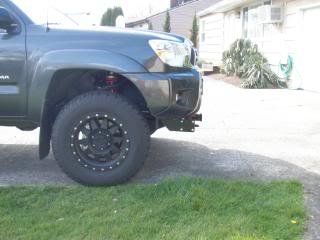

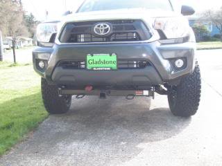

    I installed mine last weekend don't really like it sets to low compared to the one on my 99.
    I will try to post pic's

    Here's some pic's yes I think it sets to low mine will be coming off and will be for sale.

    My hitch sits about as low as the side steps, with the winch sticking out even further in front of that. So far, neither of those have bottomed out on anything.
    The gas station I use has an exit which angles down onto a roadway surface which immediately angles upwards. In other words, it's a virtual ditch, with many gouges on each side where other vehicles have dragged over the surfaces. My truck went into and out of that without any problems whatsoever.
    The front approach angle is certainly decreased, but not by that much (a few degrees at most).
    By the way, guess I should have taken pictures from much further away (like those above). I was trying to get closeups to show the details (mounting location, etc).

    That would be too low in my opinion if your truck ever sees offroad. The departure angle is reduced by more than you think for taller obstacles or banks/inclines. It would need to be inline with the frame rails and come through the front of the bumper if I was going to buy one. But.....It might work for you and be nothing less than awesome for your needs and uses. Is there room or the possibility to flip the brackets?
