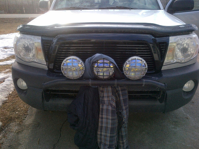

    Right now i have 3 PIAA crystal ions on a light bar in front of grill. Doesn't have to be crazy since I don't off-road

    Hmm... pics? I can try to make a recommendation from there.

    Okay, and now you want to go behind the grille, yeah? And don't want to just mount them back there?

    Yes behind, I have BAMF bar behind already.

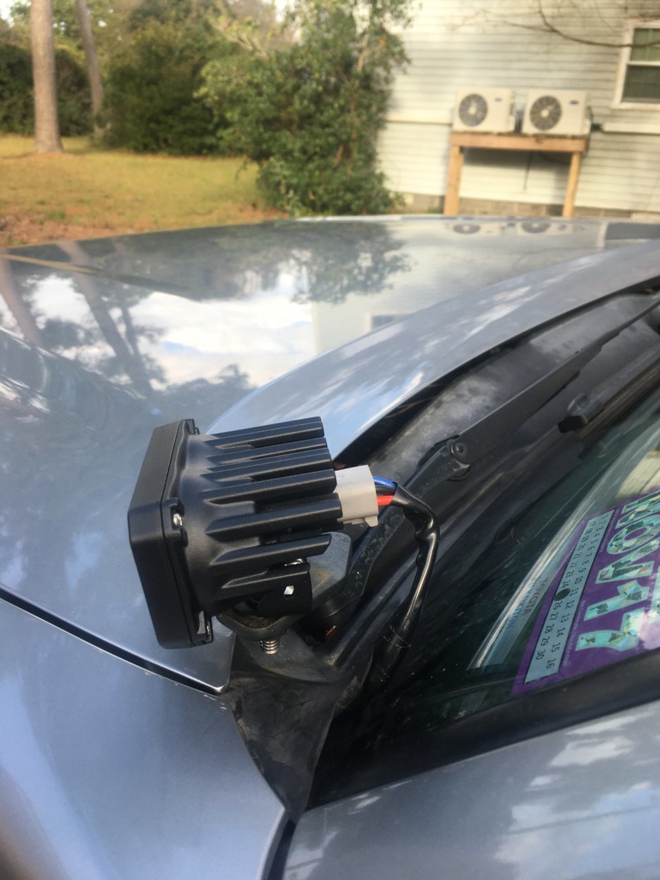

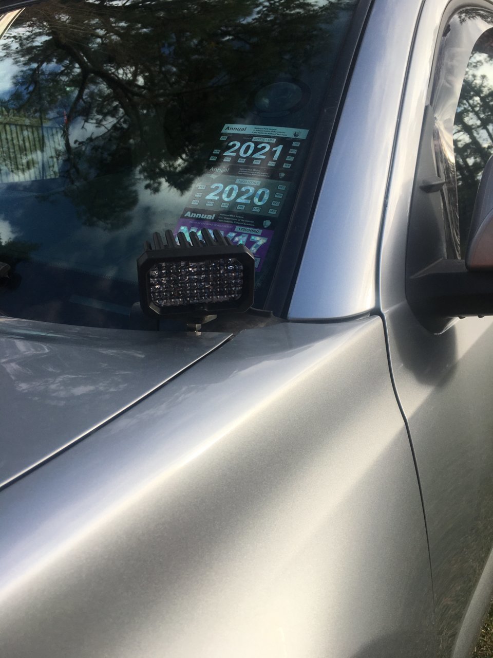

    Got some sports in the flood pattern. More or less got them to play around with. I am however, impressed with the output for their size. After messing with them, I plan to get ditch light extension brackets and using these along with the ss3’s in a driving pattern. If I had to complain about one thing, it’s the plug and how it’s exposed. I know they’re water tight, but I still plan to do something different that what I have, if anything, just some jig shrink tubing to hide the wires.

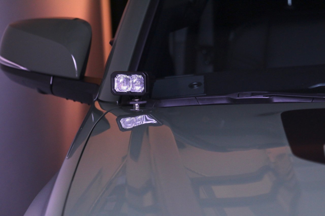

    Waiting on a switch pro bracket, so they aren't wired in yet.

    Yikes! I’m not a fan of that exposed wiring either.

    Not a deal breaker for me for the quality of the product and output. I know I can make it disappear. But I’m also waiting to see others ideas on what they did as more people get their hands on them.

    The wiring isn't really "exposed" as the ends of the wire are terminated in waterproof seals as part of the deutsch plug assembly. The insulation itself is also waterproof. I suppose you could put a large heat-shrink boot over the wires and loom shield, but it would just be for aesthetics.

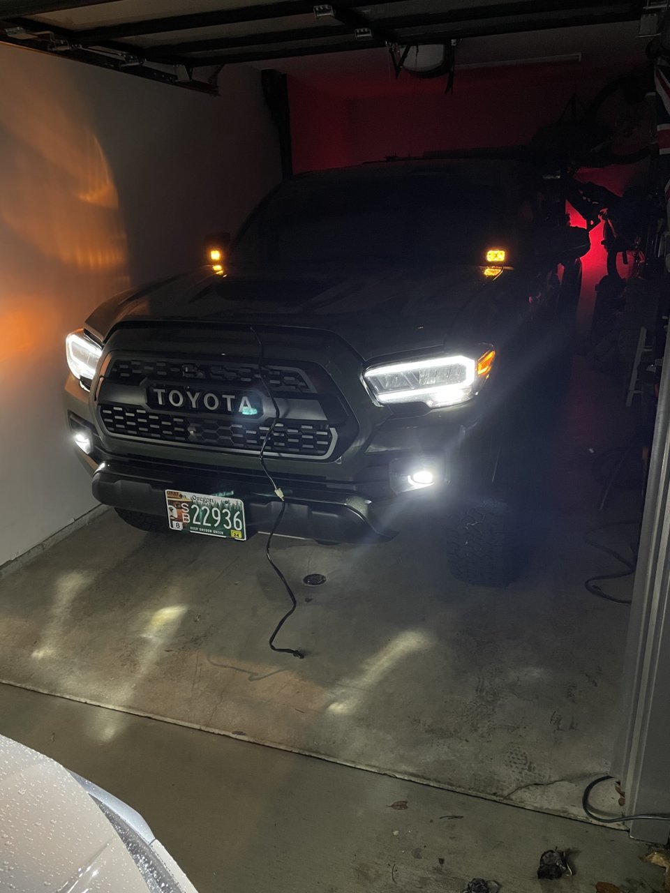

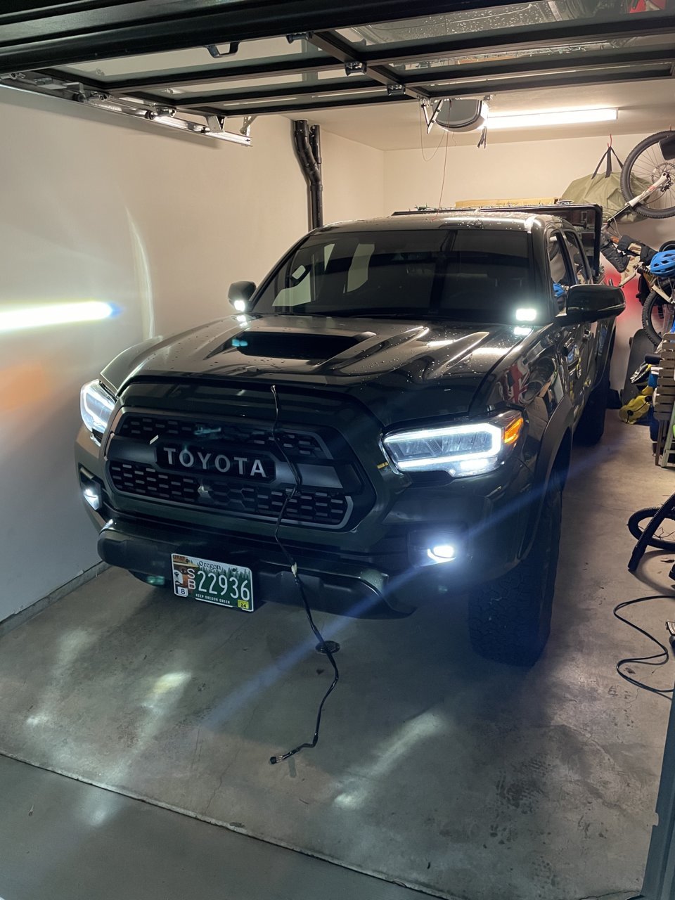

    SSC2 Sport - SAE Fog/Wide Pattern
    Amber backlight

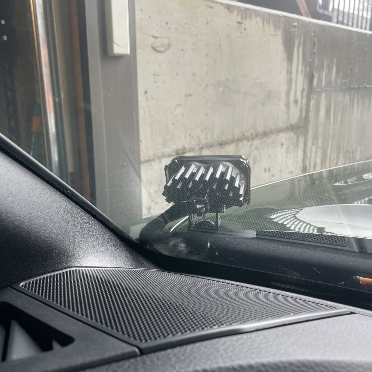

    The SSC2 sport is slightly less bright compared to the stock Rigid fog lights. However the beam height is very narrow on the SSC2, and very wide. Really happy about that.
    Mounted using Calirasied low profile ditch brackets.

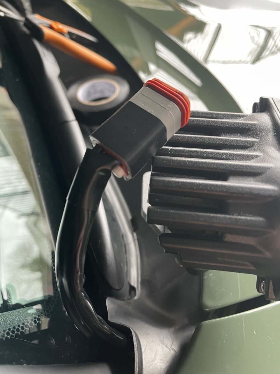

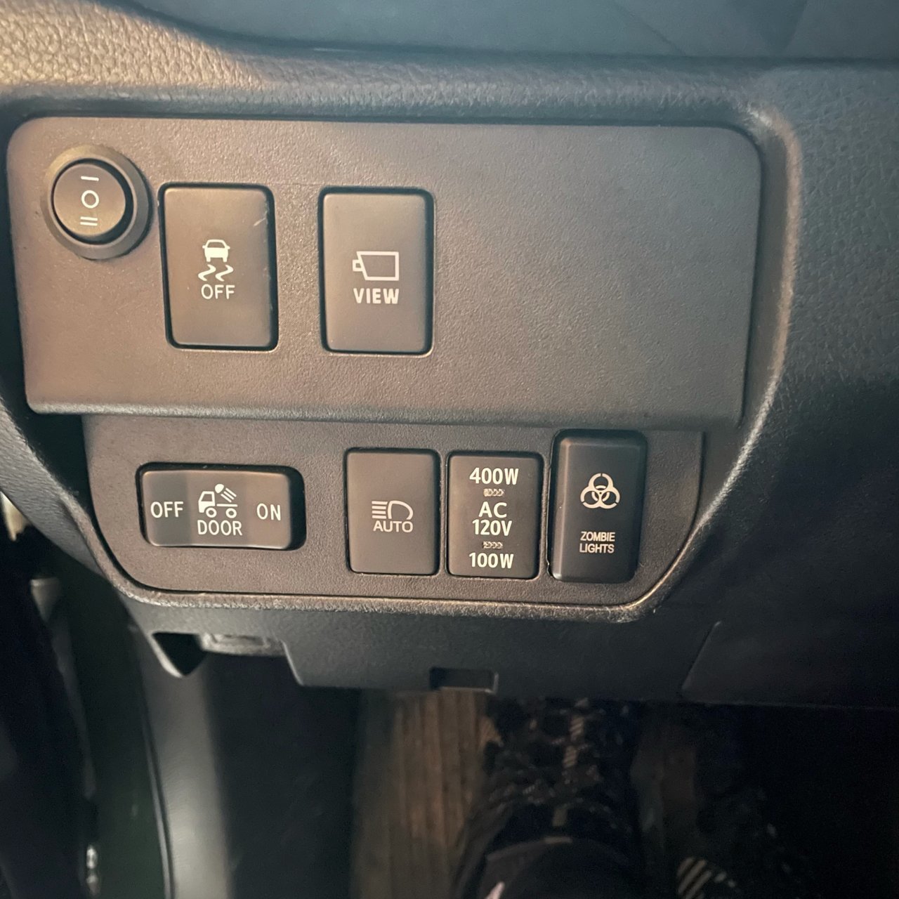

    I could not find any OEM style 3 way switches, which are required for the SSC2 due to the backlight feature. I mounted the stock harness 3 way switch by drilling out a hole in the driver's switch panel.
    The last half inch of the wiring harness has exposed colored wires, as well as grey & orange plastic. Covered that up, as it was a bit annoying to look at while driving.
    Overall very happy with this pair of lights from Diode Dynamics. I have already ordered an additional pair of SSC2 Pro in amber (Combo pattern).

    anytimebackupcamera.com makes some pretty nice factory style SPDT switches.
    By the way, you don't really need to have a 3-way switch. The primary lights will override the backlight LEDs when switched on. And the backlights have very little power consumption. So for example, you could tap them into the parking light circuit with no need for a separate relay.
    Although I'm still trying to figure out a practical reason for the backlights at all.
