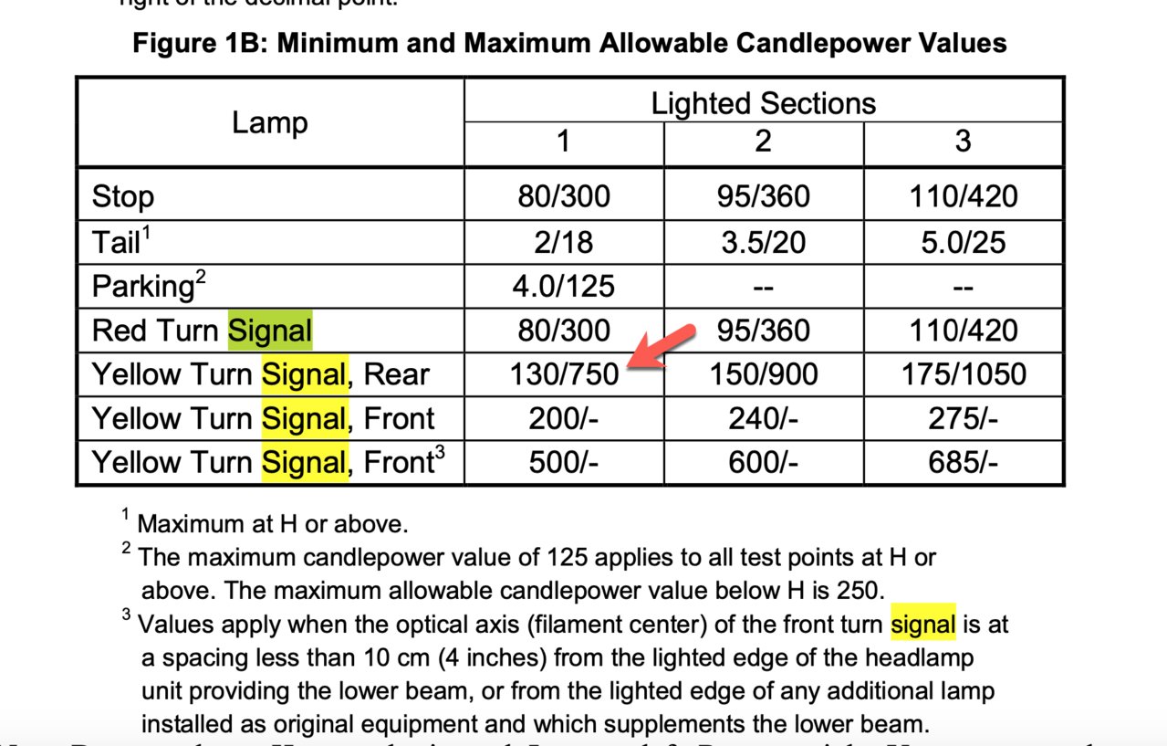

    Limit in Canada (which should be the same as USA because we just adopt most of your specs) is 750 candela (it's actually expressed as candlepower). An SSC2 with a flood lens is 373 cd and it might even be less with the yellow light I bought.
    The height limit is 83 inches in the US standard, my Prinsu rack is lower.
    No problem with auxiliary/supplemental turn signals as far as I can tell.

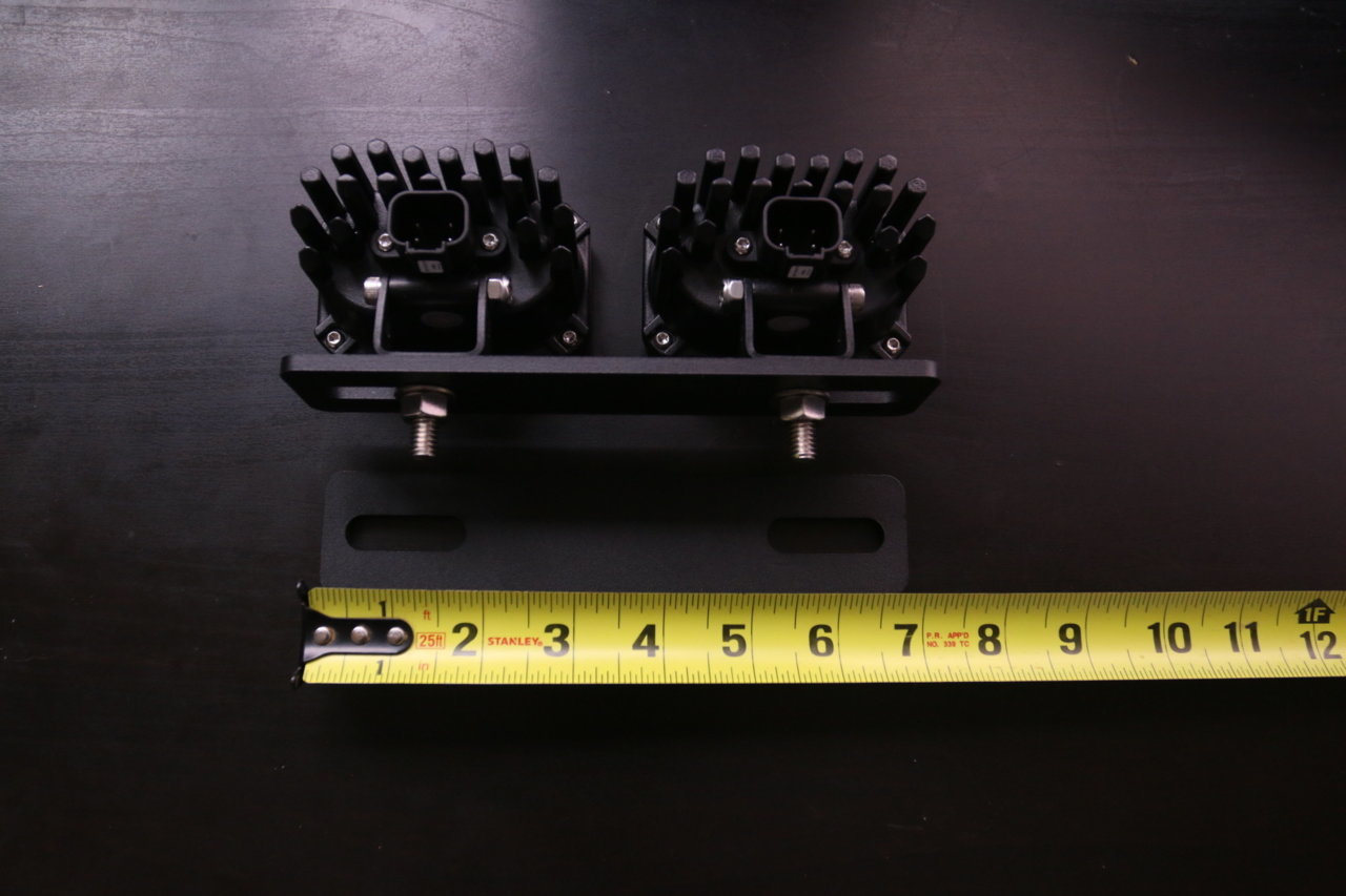

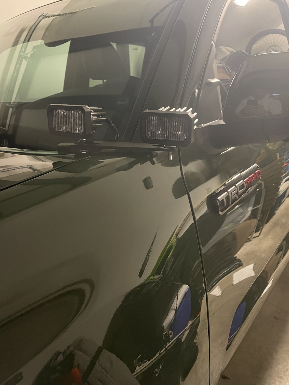

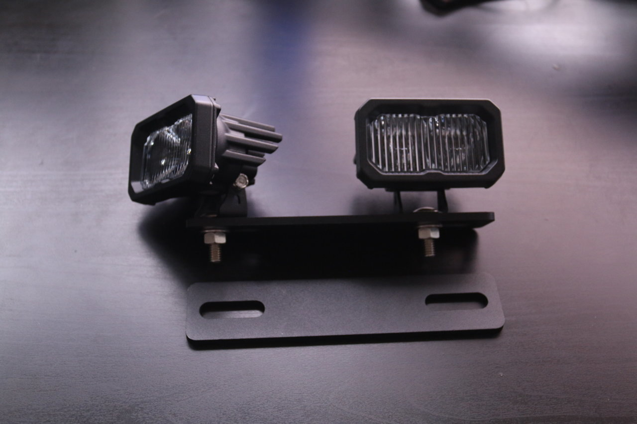

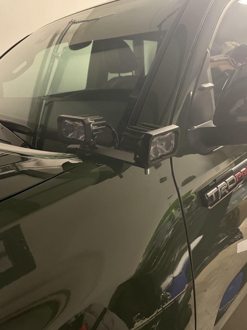

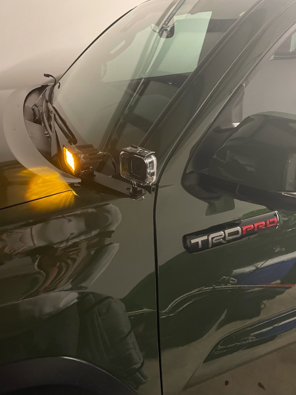

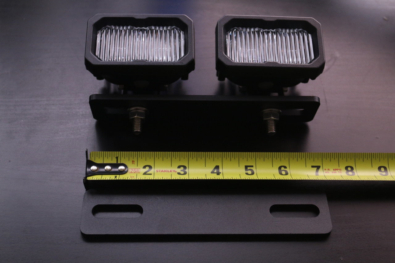

    Not sure if anyone else is looking at the ditch light extension brackets in combination with Diode pods, these photos might be helpful.
    With the Cali Raised brackets, I was able to get 2 SSC2 pods pretty close together. Bracket is 7 inches in length.
    I ordered a second set of SSC2 lights, which I plan to mount side by side with the other SSC2s on the hood. I was hoping to run them close together most of the time (pointing forward). Maybe run them wide while off-roading so the light can point down and along the side of the vehicle.
    Until the SSC2s arrive, it will be a GoPro mount.

    this is good to know :thumbsup: I was planning on doing this once I got a pair of ss3’s. Keeping them fairly forward facing with the ssc2’s I already have mounted out to the side.

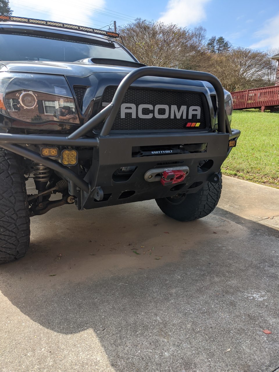

    Haven't really used them together that much but there is a pretty significant change when you turn the 2s on. I am satisfied with them.

    looks awesome. I just bought SSC3 and SSC2 for my hybrid bumper as well. Can you tell me what setup each lights are? Fog, driving combo or flood?
    Did you tap SSC3 and SSC2 together or they work independently?

    The 3s are fog...2s are combo....3s on factory fog light switch..2s on switchpro.
