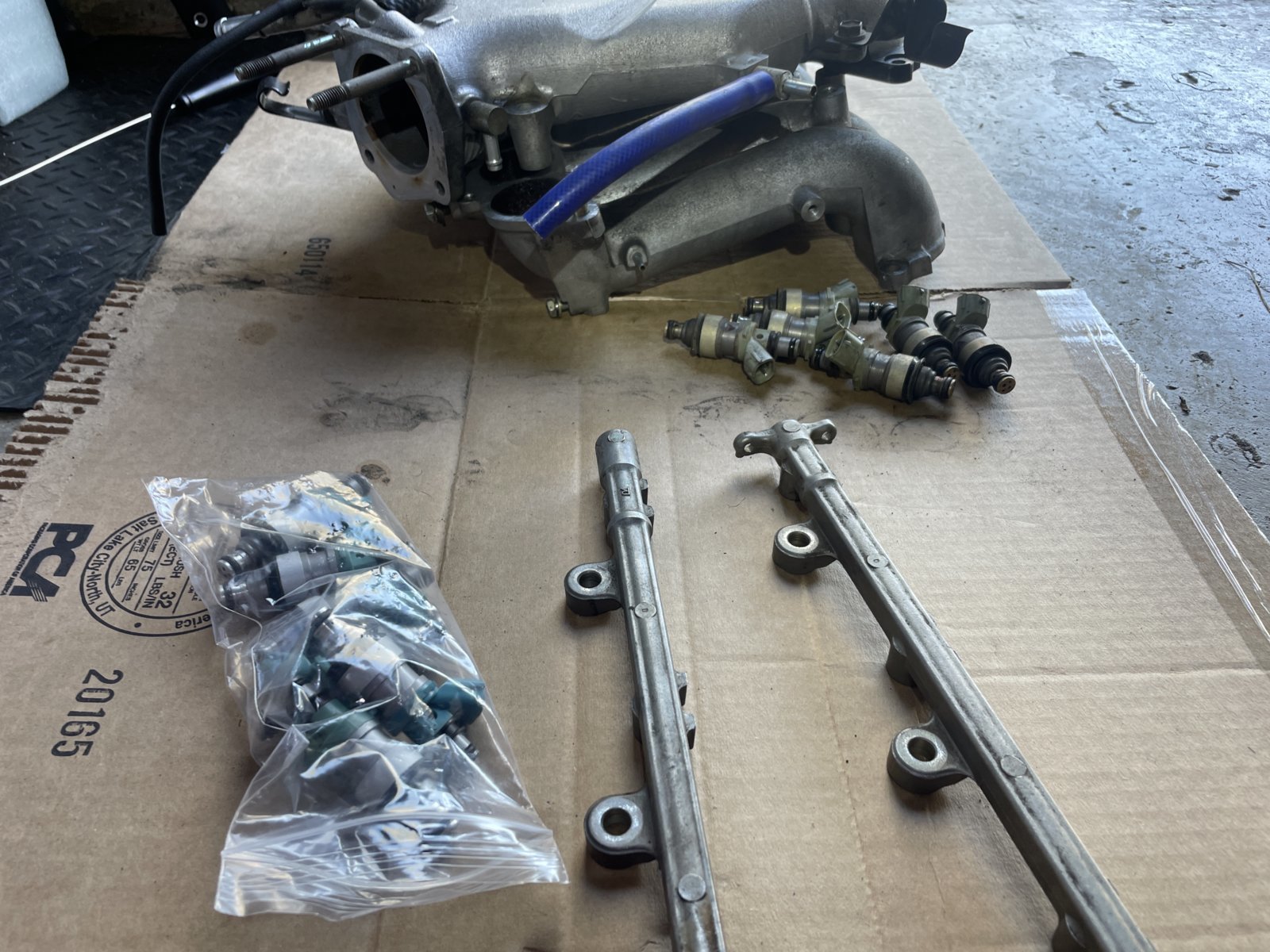

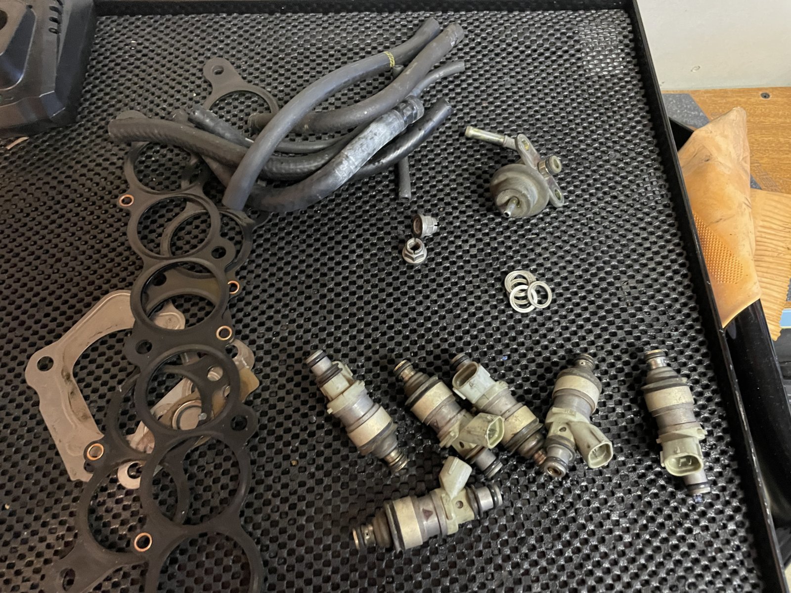

    On cold starts it was taking 5-6 cranks to start, more than it used to. On warm starts I was getting behavior that I can only describe as the engine roaring alive after only one crank, too soon, as it does a few cranks too rapidly, and then the engine finishes starting and sounds normal thereafter. The best theory I heard was a leaky injector was dripping fuel into the engine, causing a rich start for a certain time period. Otherwise if you wait some hours the leaked fuel evaporates and the engine takes an extra couple cranks to regain fuel pressure it lost.
    I used Motor West refurb Denso injectors, and Timmy's video.
    Aside from the injectors, I put in a new fuel pressure regulator & O ring, gaskets for everything, and some heater, fuel, and vacuum hoses.
    Some fuel dumped out when I removed the #6 injector, just before the FPR. I don't remember if it came from the bottom of the injector, as in a leaky injector, or from the top, as in a partially clogged injector. Unless that's just where the fuel remained after I depressurized the fuel system and it means nothing.
    Given that I replaced the FPR, I wouldn't know if the FPR was actually the problem.
    Now it starts up on the third crank every time, and smoother. At 60mph the MPG went up from 23 to 25 as measured by OBD2.

    Motor West has such good reviews here that I had to get them.
    The hard part was the tight space behind the engine, trying to get everything off and keeping track. My model has the EGR and two VSVs back there. But I was prepared with written steps all the way through, and the vacuum diagram. The fuel rails and injectors were easy. I triple checked afterwards, no leaks around the rails area, except I learned that it's a bad idea to replace a fuel hose like the return hose from the FPR unless you have a perfect match with a snug fit and a strong hose clamp.
