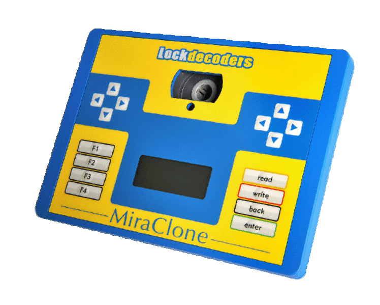

    Unfortunately I think you're going to have more issues than you think.
    Programming/cloning transponder chips has become infinitely more difficult than it used to be. (you used to be able to do it in the vehicle).
    Most of the time they require a special machine like the one pictured, and even at that, the new "G" chips are not cloneable. Combine that with the fact that the trucks computer 'limits' the number of keys allowed to be programmed, and you're likely going to end up at the dealership with a much lighter wallet.
    Not to be a negative nancy, just worked ALOT with Toyota's stupid "G" and "H" chips enough to be fed up. Best of luck!
