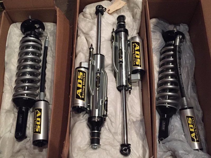

    About to pull the trigger on the following
    ADS 2.5 Fronts With Resi
    ADS 2.5 Piggyback Rears
    going extended travel, but keeping it at about 2-2.5” of lift. Picking up the icon AAL from iKonik.
    Plan to add UCAs later. Think I’ll be fine?

    Yes
    i think you’ll need UCA’s with that amount of lift but I’m not positive...

    I would say going ext travel period warrants needing uca’s as soon as possible. If I was dropping that much save a bit more and take it easy for a couple months and get them. Or do it all at the same time would be easier as well

    I think I’ve decided on icon Billet UCAs which are crazy money, so I’ll have to wait. I guess I can get them in the group buy and wait to install

    You can absolutely run stock UCA with extended travel. Is it ideal? No. The stock UCA will simply limit the travel as it will contact the spring due to the extra travel the shock will have vs the standard travel. This can easily be mitigated by not utilizing all the travel until you swap to aftermarket UCA.
    Long story short. Jump on the group buy if thats the kit you know you want. Hold off on the install until you can get the aftermarket UCA you want. If the urge to install becomes too much to resist before you get the new UCA, install away.

    Not only will you be fine, but all of us will be jealous!
    He should be ok. What @backcountryj said....
    Seriously though, he is going to be on the cusp at 2.5". The UCAs will definitely help and make an improvement. Once he starts moving closer to 3" is when the UCAs become a necessity (from everything I've read. no first hand experience....yet).
    When you do get to that point, I would consider the JBA over the SPC/Light Racing. Too many mixed reviews on the SPCs. I heard they redesigned the UBJ, but then I hear others who recently purchased and installed and have problems within a week. I've heard enough of the bad reviews to stay away from them personally. If you're looking at spending the money on Icon Billet UCAs, why not look at the Total Chaos? Those seem to be the gold standard...

    I've been thinking about balling out (buy once cry once) on some King's or ADS extended(mid) travel all around... Would my current SPC UCA's be sufficient to clear 2.5 extended travel shocks up front? Would there be any issue running this setup with stock LCA's? Also, does anyone know what kind of warranty ADS holds? I know King's hold a 90 day warranty...

    Petty sure you will be fine with the UCAs you have. Stock would also work, but would likely hit the spring on extreme droop. No idea on the other questions.
