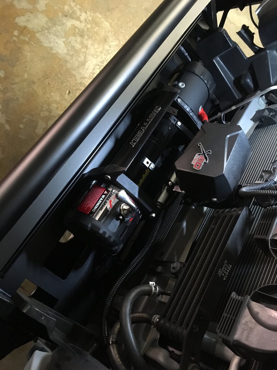

    You guys with winches, where are you mounting the solenoid box? Pics would be great if not in the standard place on top of the winch. I'll probably be getting a hybrid bumper soon. There's a company that makes 05-11 and said they would give me a discount if they could use my truck to fit their existing design to my later model 2nd gen. They said the winch only works with non integrated solenoid winches and most their customers mount the solenoid under the hood.

    I know mine is different but here's how I did mine in my hybrid, it's on the passenger side just shoved between the bumper and winch. Hasn't moved, probably should make sure my winch still works after dumping it :anonymous:

    Thanks. That does seem like the easiest location. Maybe i'll get lucky and there will be enough room to do that.

    I have done it two ways on two tacos.
    Side and Top

    From what i've been told by them, there probably won't be any room above the winch for it. Maybe I can do something a little similar to yours and fit it behind the grill in that area.

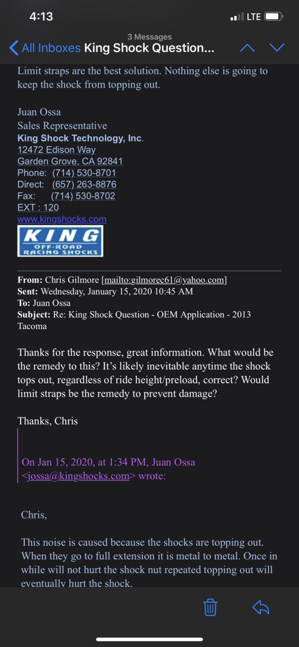

    As far as my suspension clunking issue a while ago: (read from bottom to top)

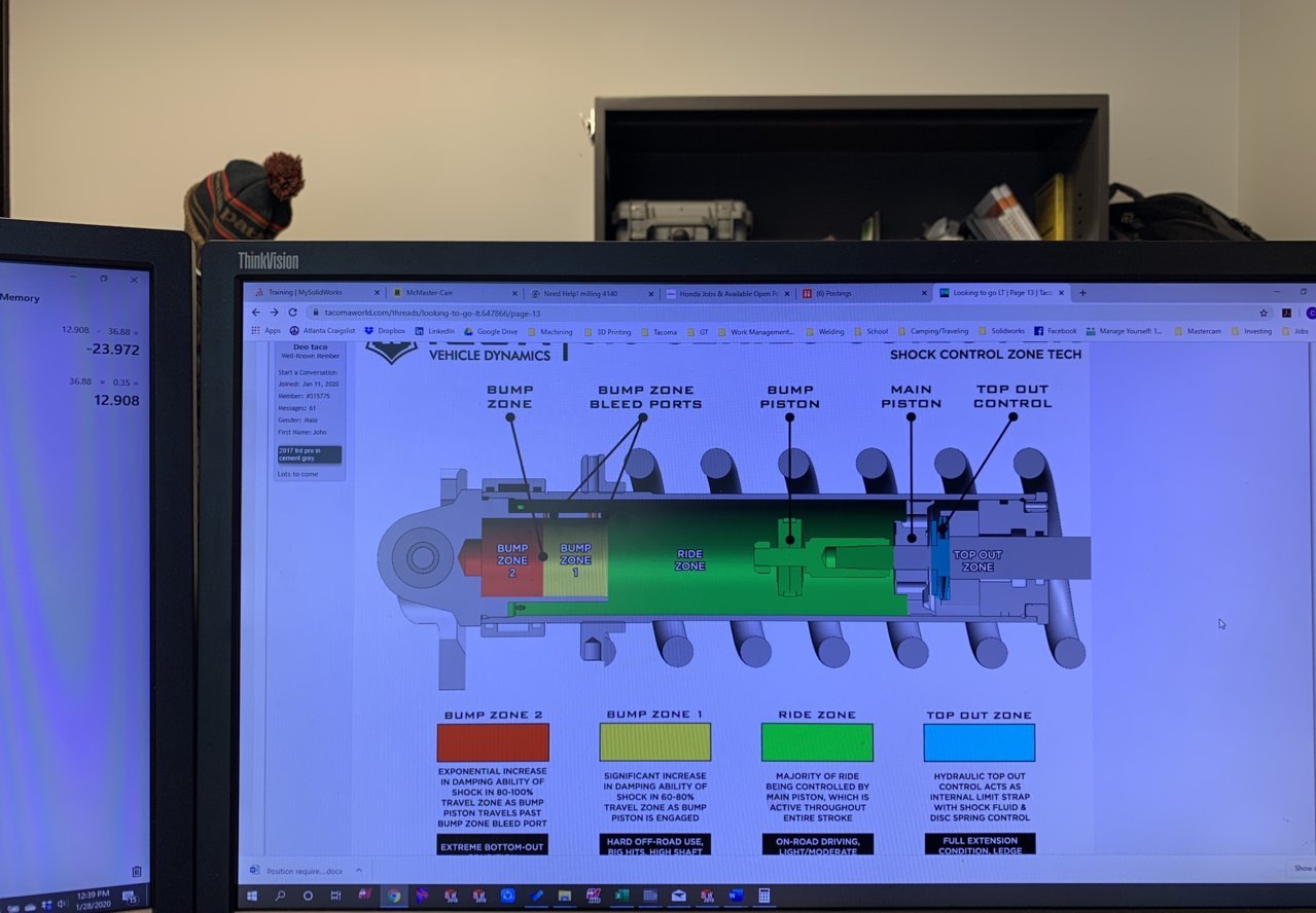

    Will either run limit straps, or pull shock apart and install internal bushings/ dampers like icon does if it’s possible: (Blue section)
