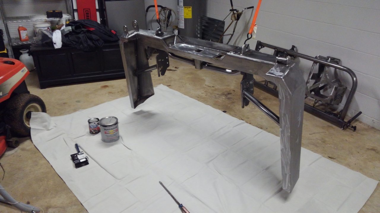

    I bought all my armor (streamline front, all 3 skids, sliders, hc rear w swingout) from SOS bare and painted myself.
    I did a few methods, but the best / most durable was to grind rough edges smooth with a grinding disc on an angle grinder then hit it with a paint stripping disc until it was corrosion free elsewhere. I then wiped it all off using an old towel to get all the metal dust off. I painted on a THICK coat with https://www.amazon.com/gp/product/B0070S7U4Y/ and let it dry for about a week to REALLY cure before putting it on. A basic foam brush from Home Depot works great, but buy a 10 pack (for like $5), you'll need 3 or 4 to paint a bumper because they fall apart.
    I had a few chips and they touched up great. Most of it has been on there for more than two years and still looks great. It's more durable than powdercoat and touches up easier, so it's definitely worth the labor.
