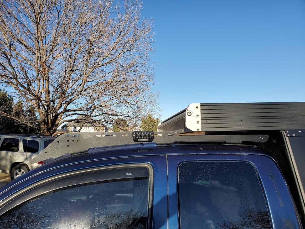

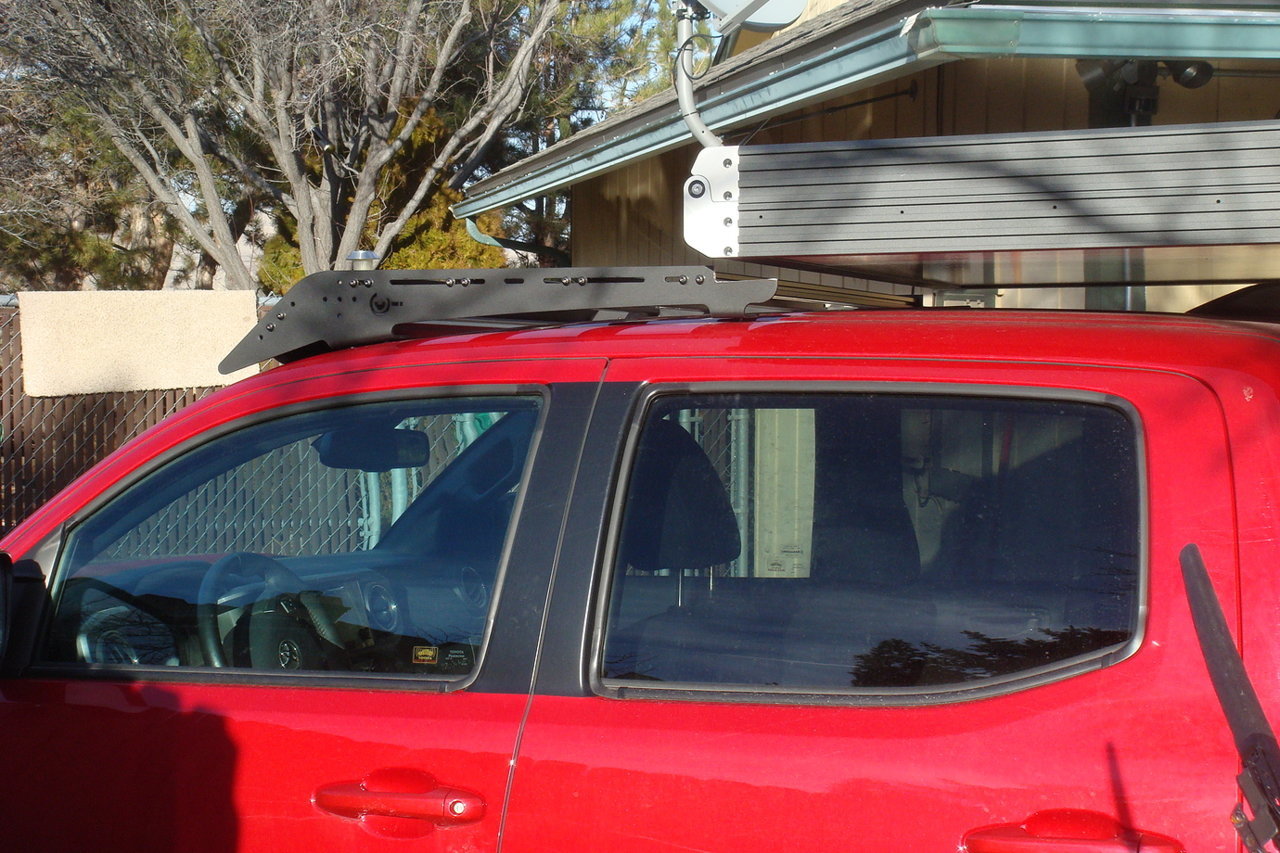

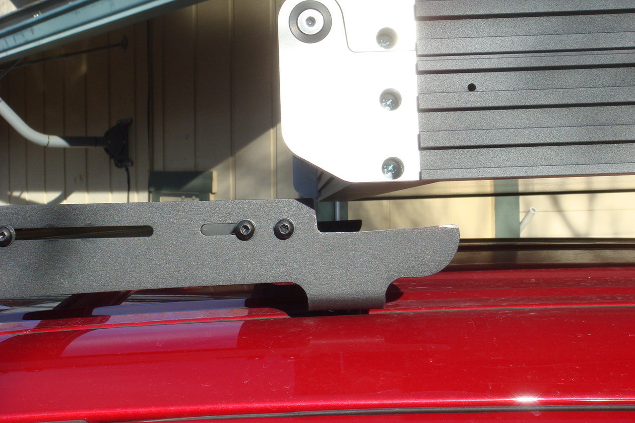

    Question for you guys and gals. So I have to cut my Prinsu Rack on my Taco, in order for the GFC Camper to go on.
    Can’t take the rack off due to a welded button in the cab breaking loose during install. So the rack has to stay unless I wanna get into the headliner.
    Anyways. Let me know your thoughts.

    You didn’t give me your opinion between the two options I gave above.

    My bad.
    Option 2 looks better to me. No awkward empty space. Your mentioning of the weld button dohikey made me assume all the prinsu mounting points would have to stay.
    So yea, option 2 looks better to me as long as there are no clearance issues with the GFC. Although option 1 will easier to execute if the rear most prinsu mounts can be removed...
    Built2Ride[QUOTED] likes this.

    That’s exactly what I wanted to hear.
    The front Driver is the nut that’s spinning.
    FYI - to all those who are missing one bolt for their Prinsu, DO NOT use a slightly longer bolt just cause you have one lying around. The tolerance in the roof ain’t playing, so use exactly the length of bolt they ask for.
    Mine was not even 1/4” longer and it bottomed out, causing weld but to break free on the last turn I put on the wrench.

    It’s staying on, the pain in the ass it would be to remove it and all the wiring associated isn’t worth it to me.
    I will clamp a piece of hard steel up against it as a guide for the body saw.

    I vote option 2. that option looks as if you ever remover the camper, then you might be able to salvage the cut rack and be able to modify slightly more to add bars back in. (I hope that makes sense)

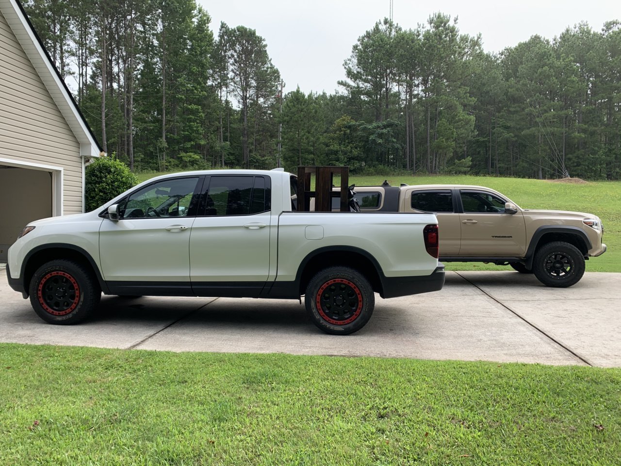

    My old man just got a new to him Ridgeline. Yup, laugh away ladies. Not starting any debates here, but Honda engineering + open bed + AWD is honestly pretty BA for most people. This is my dads second one and I can promise you he puts his rigs through more shit than a lot of TW folk ever will.
    The 3” lift helps the aesthetics a little. The wheels honestly look better in person.

    Another vote for option 2.
