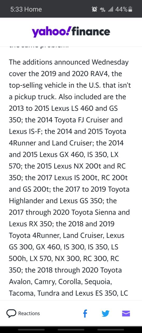

    It's so strange to me how 14-15 and 18-19 4runners are included but not 16-17. How are those magical good fuel pump years haha.

    Their whole fuel pump setup sucks. A silt sock in the tank?! This is bs and always has been.
    Wondering why your old truck is stumbling on throttle? Silt Sock is clogged up.
    Happened on 3 of my yotas.

    ‘17 are not part of the recall right?

    Nope. Haven't seen a single person with a 17 have the issue, but have seen a few 2018's, but its focused more on 19-20. There's a full list on my post on the last page

    Wells technically speaking it’s called a Fuel Pump Sock, but these bastards get clogged up and ya gotta drop yo tank to get it out.
    I get you they wanted a prefilter but this is a PITA!

    There is a mod, you can get a fuel pump made by Under Dog I have one somewhere, and it pairs with an external filter.

    Most people do a lot of shit to their trucks only to find out their fuel sock was clogged.
    I was chasing a power issue in my gfs runner. You would push the gas and feel the truck bogging in a cyclic way. After I did everything else I pulled the tank. It looked like a sand box when I cleaned it out. Sock was completely clogged. Changed the Sock and presto.
    same shit is currently happening to my ‘07 FJC so I will be installing the Under Dog pump and external filter.
    what can I say, we are paying for sand not gas at the pump.
