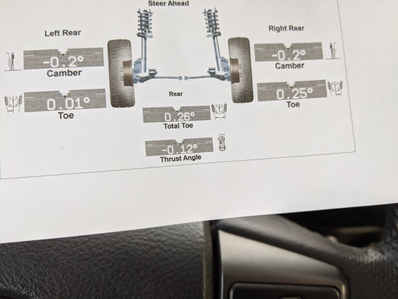

    anything an alignment shop can do about this toe if the camber is lined up? these are the rear specs.
    im feeling a little tie vibration back there.

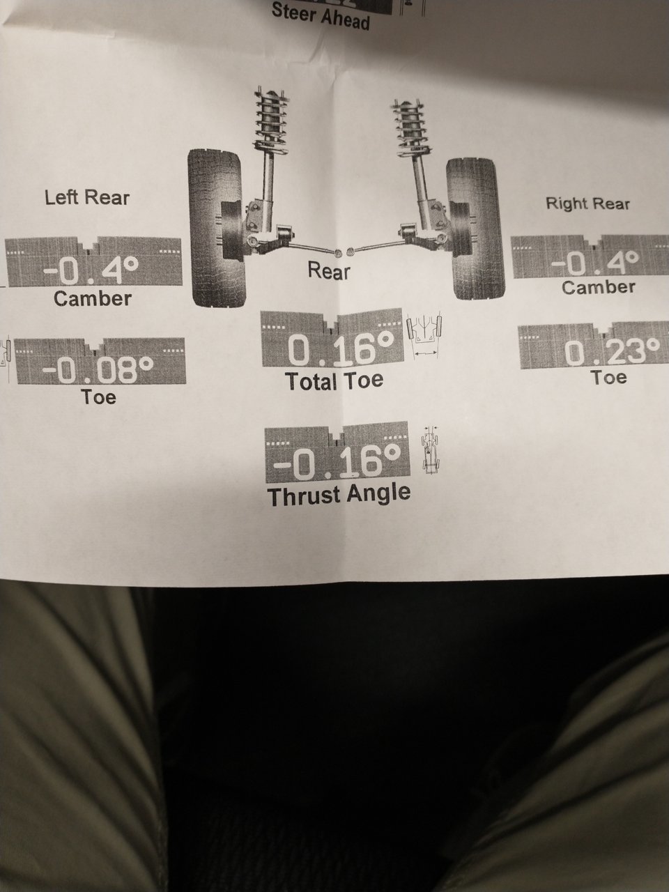

    This was mine from Monday. Mine seems to feel fine and I didn't do anything to the rear of mine so I assume it was this before also.

    hmm... maybe my tire is not balanced properly?
    If i drive for half an hour the vibration goes away

    Make sure your Ubolts are nice and tight. I think it the spec sheets they say to torque down to 37 ft/lbs but that is a misprint and they should be torqued to much higher. Probably more like 85-90 ft/lbs
    Also, since you lifted the rear you may have a drive line vibration b/c you're driveshaft is now at a different angle.

    i will try tightening the u bolts. the vibration is really like hearing and feeling like my back right tire is going over a rumble strip

    Loose u bolts could cause that sensation. Also drive line vibration could make that feeling. Also check to make sure all your lug nuts are torqued down too so you can rule out wheel wobble from loose lugs.

    u bolts were much more loose on that side! will drive now

    Get them good and tight.
