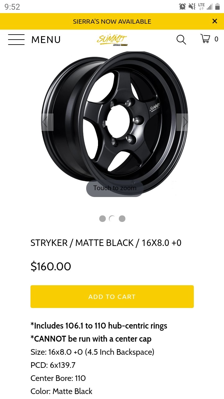

    A buddy of mine has summit wheels and they fit my truck just fine. I like the -25 offset as well

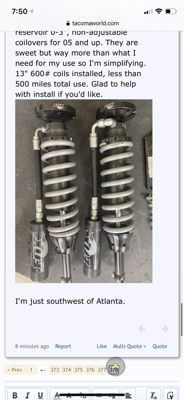

    Was someone in here selling fox 2.5 coilovers? I took a screenshot to see if they fit 4runners and didn’t get the username in it. Now I can’t find the post hahah
