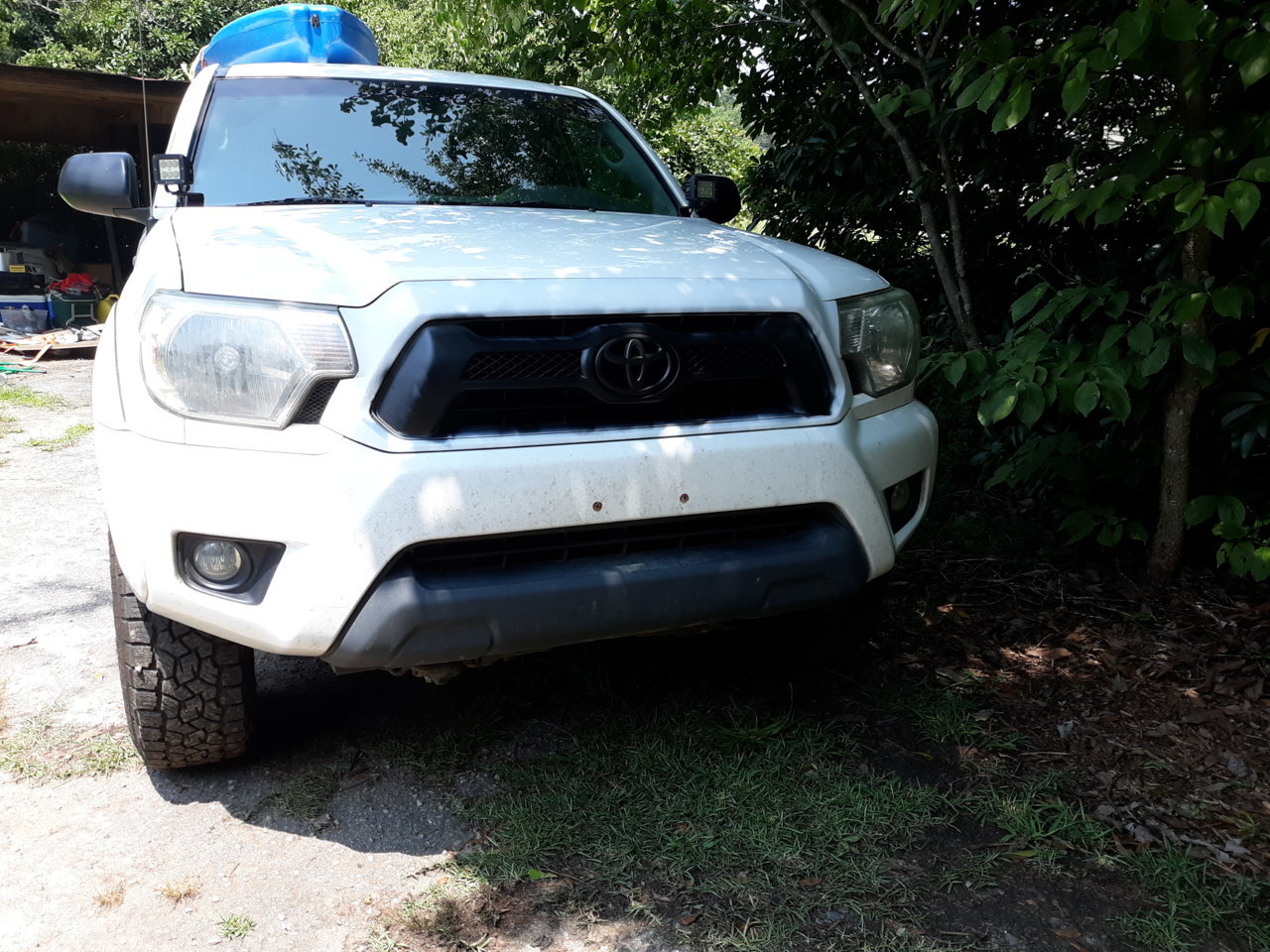

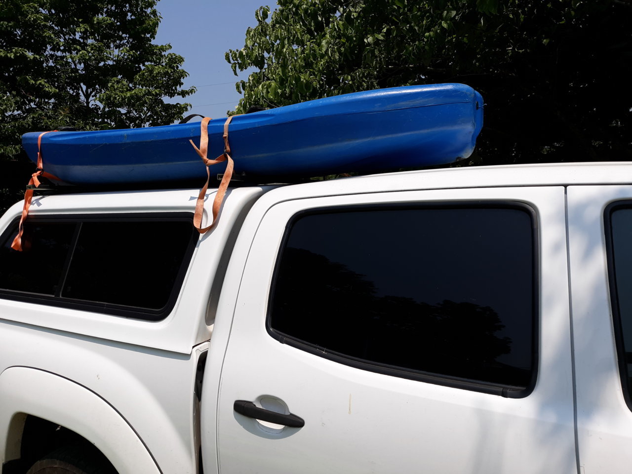

    I took advantage of a day off and plastidipped my grill. Then built a simple unistrut rack to carry my kayaks and paddle boards
