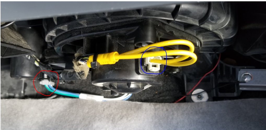

    Have any of you guys dealt with the issues of your AC blower only working on high? I've clicked through a couple of threads, but I'm not sure where the whole burnt plug/resistor is supposed to be. Some pics make it look like it's behind the glove box, others make it look like it's behind the AC controls in the dash.

    Look underneath the glovebox/passenger side dash panel, it’s right there in the upper footwell. Like if you’re sitting in the passenger seat, you can just about kick it with your left foot.
    Right near the blower motor housing.

    Okay, good deal. Thank you! So the plug and resistor that can go bad are all located there? If I don't have to take apart the dash to get to any of this stuff that will be wonderful.

    Yep, should all be there, no disassembly required for the resistor other than the two easily seen screws holding it in. It’s a flat 4-pin connector if I remember right.

    Yes. Just went through that.
    If it only works on high, the issue is your resistor or the plug connecting the resistor. I thought that was my issue, so I replaced the plug and resistor. Turned out that wasn't my issue. So I have a perfectly good plug and resistor if you want.
    As for location, it is right where the carpet line ends under the dash.
    Resistor and connector are circled in red.
    Also check the connector circled in blue. This picture was taken after both connectors were replaced in my truck. No disassembly for access required.

    Thank you guys so much! Going to dig into this this week and do some testing. Friday was fine. Nothing worked except for MAX on Saturday. Sunday it started back working mostly fine again, I think. So it's intermittent, but I want to go ahead and fix before it completely fails. Read through your thread @CowboyTaco got all the points of failure on a list to check.

    What they said but the first resistor I got off Amazon was DOA, returned and next one is fine. My connection on the blower pigtail was so toast that I had to replace my blower motor too but it's three screws and takes like five min. Also I had to cut back 4/6 inches to good wiring that wasn't shorted and burnt.
