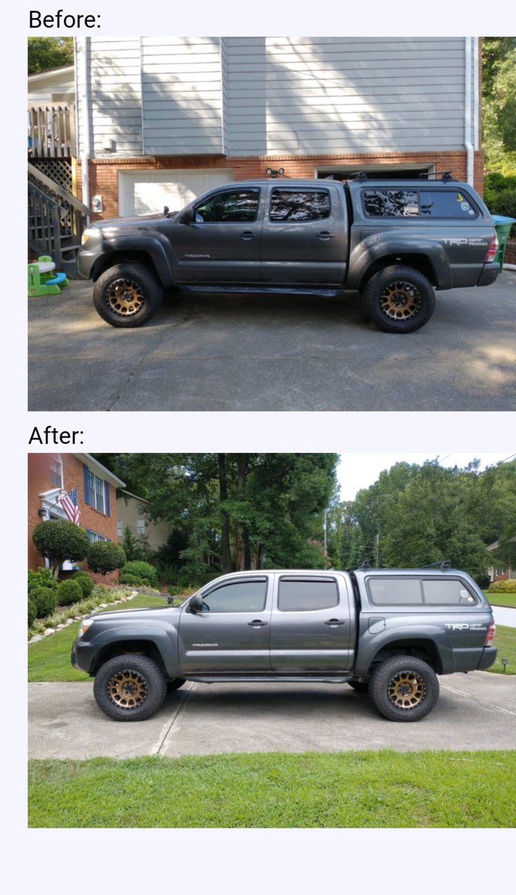

    Psa for those of you that will ever run a shell or weight in the back. Skip the aal and go full pack from the start.

    I agree. I need full leaf pack. I'm not happy with the AAL

    Putting the factory OL leaf back in brought back my factory rake with a shell and 3 leaf AAL. My butt dyno prefers the ride with it that way and the rig handles getting loaded/towing much better than prior.
    Obviously results/preferences vary. Admittedly I’ve had a brand new full replacement leaf pack in my shop for nearly a year now. I just haven’t taken the time to install them, and have frequently considered selling and leaving the rear as I have it. My current set up works for my needs these days.

    Mine was a single aal with the stock 4 leaf pack that had the OL in it. The single aal just does not handle weight well.

    Mine is the incon 3 leaf aal. I had to lower the front coliovers a little so the rear didn't look like it was squating.

    Right on. What’s kinda funny is I’ve always heard/read (both TW members and from some vendors) that the single AAL should be used with toppers and towing as the 3 leaf AAL can’t handle the weight as well. I went against those directions since I wanted what I’d hoped would be a smoother ride with the 3 leaf progressive pack.
    Just goes to show nothing with lifts is uniform or a one fits all kinda thing.

    I would assume the 3 leaf aal would naturally handle weight better then a single aal. All I know is I've had the single in for about 30k miles and the shell has been on 25k of those and sagging occured about 10k ago.

    Raise it back up and search for a used leaf pack. I got these ome Dakars for $100.

    Yea man I didn’t fully comprehend the suggestion on single vs 3 leaf. If I recall it was primarily because most 3 leaf packs at the time suggested running sans the factory OL leaf. Whereas the single AAL was intended to be used in conjunction with the factory OL.
    After similar mileage on my 3 leaf with a topper I tossed the OL back in and regained rake and it’s been holding strong since.
    I fell on a deal for the full pack I couldn’t pass on. Verdict is out if/when I’ll install them.
