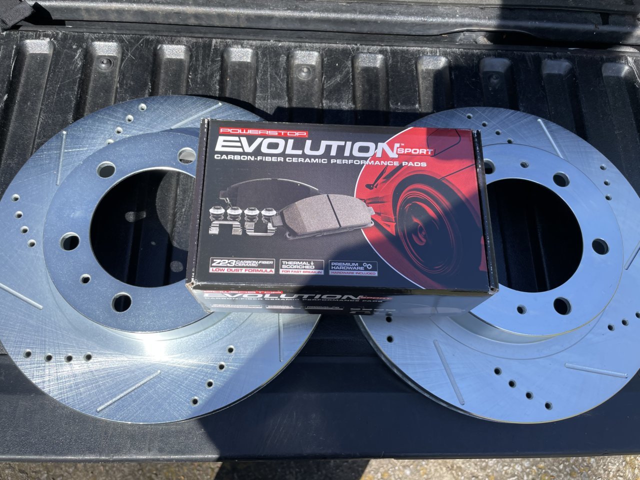

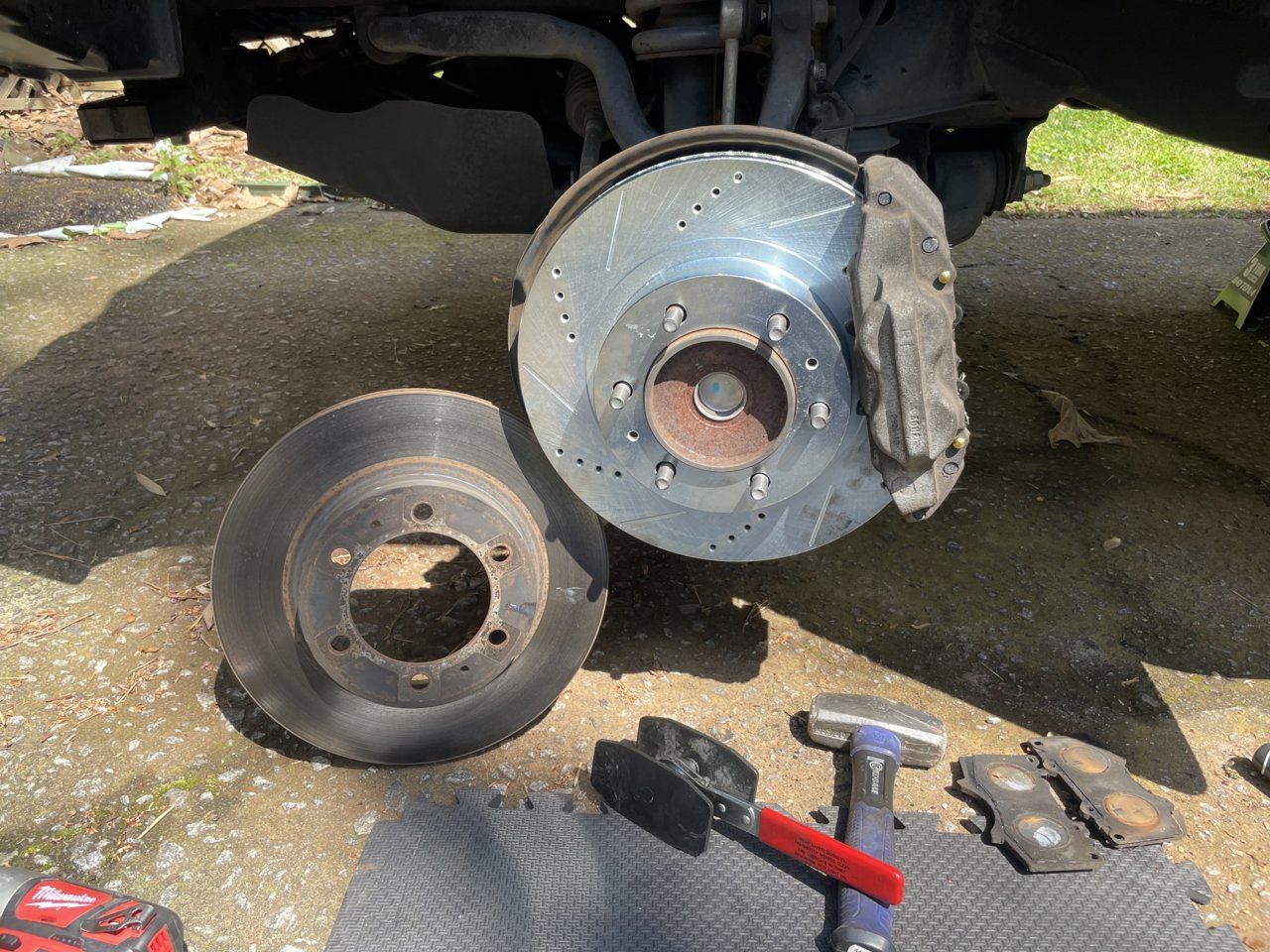

    First attempt at doing my own brakes and TBH a lot easier than I expected. Only one 17mm bolt to the knuckle was stubborn and needed a breaker bar. Got these PowerStop off rockauto shipped for under $200 and done in about 2 hours. The caliper spreader is a coworker's and quite helpful.

    Aye I changed my wife's gx470 rotors and pads too!

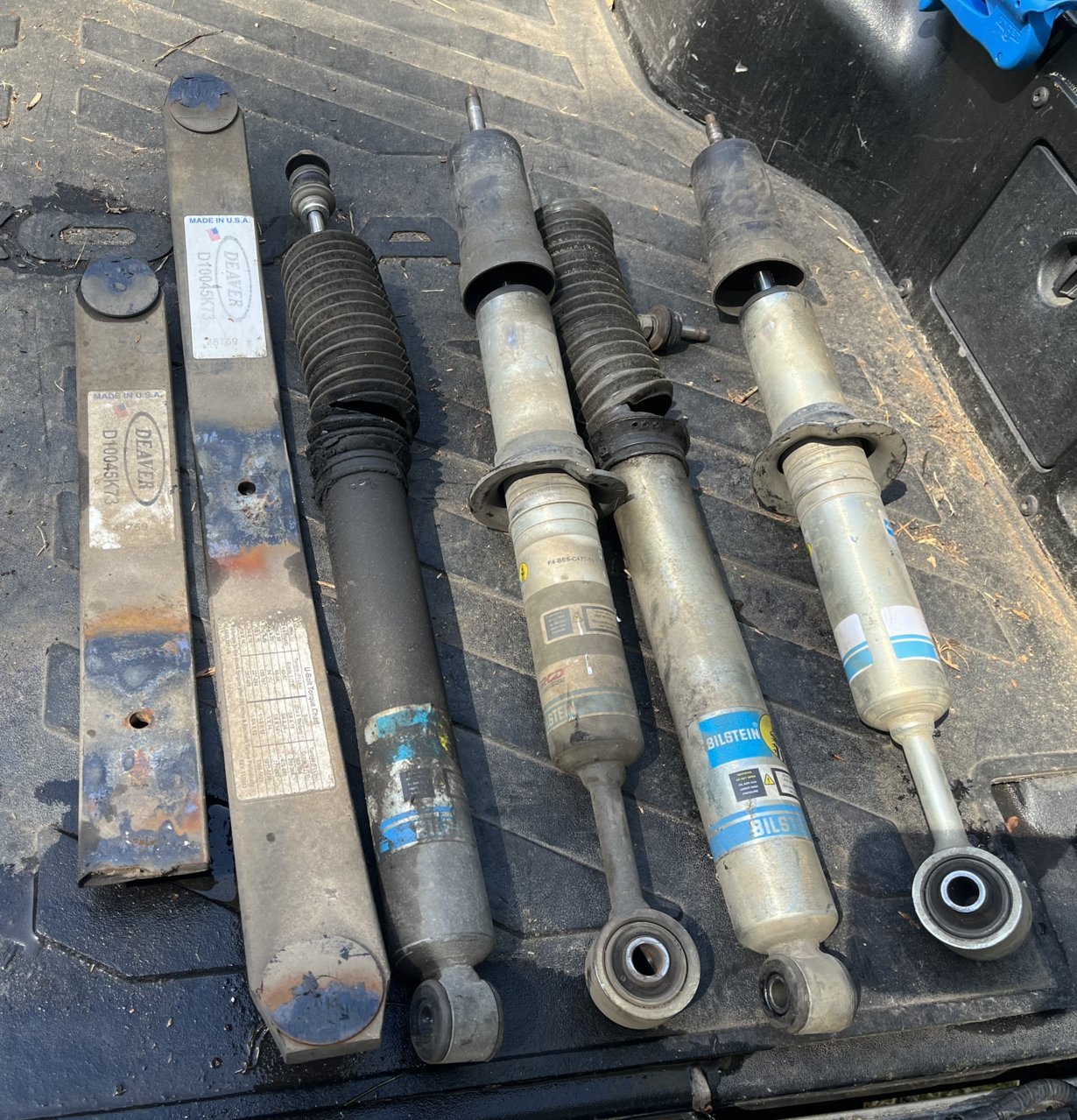

    New suspension installed. Had no clue I was riding on a broken leaf. I’d never noticed it upon visual inspection.

    Thoughts on the Powerstop kit? I have been contemplating that one or just replacing a lot of my junk with OEM. I'm at 175k on the original drums and Powerstop has a kit that includes the rear brakes too.

    I have purchased and installed about 5-6 power stop kits from rock auto. Excellent.
    I would recommend doing standard rotors and pads, not drilled and slotted

    I noticed brake fade the last time I did a 3 hour round trip. I've got SS braided lines ready to go on the front. Just wanting to figure out what I'm going to do, if anything, for the actual brakes. Pads and rotors look good, but I'm running the OE brake lines and fluid here 12+ years and 175k miles later. I've read that the rear only handles ~20% of the braking, but that can be significant if worn. I get a little bit of a squeak from the rears when the truck first moves after being stationary for a while. Other than that, they are quiet.
    I know that more surface area is better for rotors, hence not wanting drilled and/or slotted rotors. However, PowerStop says the Z36 kit is for trucks that tow and/or are lifted with oversized tires. Seems like all of the "performance" options are drilled and slotted.
    I've also read that the EBC green stuff with OEM rotors is the absolute best combo.

    First off, change/flush your brake fluid. 12 years is way too long to run the same fluid. Flush the lines until clear fluid comes out at all 4 corners. Also, change your rear brake lines as well - steel braided are preferred here also.
    Second, you don't want drilled rotors. They are fine for race cars (debatable). Drilled rotors develop cracks - the holes actually weaken the rotor. Slotted is OK.
    I've heard mixed reviews of the EBC pads.
    Personally, I run Raybestos Element3 pads and Raybestos S-Groove rotors. Works really well - and I tow trailers.

    I've been running extended ss braided rear lines for a while now.
    I kind of figured that, if I decide to do the front brakes, that it would be better to bed them in with the old fluid.
    I've never had any rotor other than flat. I'm not really concerned about the looks, which seems to be the only reason to get drilled/slotted rotors. I just find it odd that all of the "performance" rotors are drilled and slotted.
