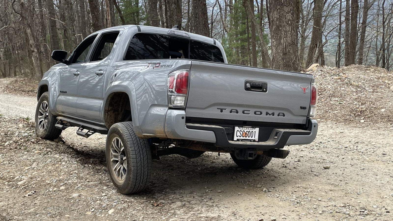

    I did the Georgia Traverse in stock form last month and I did end up scraping in a couple of places, but nothing too bad. I do like the look of a lifted truck, but am mostly hoping to gain just that extra inch or two to clear the crests of whoops off the pavement. The stock sport suspension is also VERY stiff. I honestly don't need 4wd that badly as long as I'm carrying some speed behind me.

    Just for clarification, lift won’t really help that. You need to cut and trim the areas that are hitting. Adding a “lift” only makes it easier to clear bigger tires. Bigger tires is what makes you get the “lift” aka ground clearance. You could take out the front suspension and jack up the tire until full bump and then see what it hits and cut it out.
    I’d recommend doing that to get better clearance and if you want the “look” go with a decent shock, AAL (for reasons stated above about learning your truck and the time it takes). Keeping it cheap until you can get/need bigger tires to justify everything else. Best of both worlds, cheap, rides smooth and you won’t be rubbing anywhere. But alas I’m a 1st gen Tacoma who still rubs :anonymous:
    edit: yeah you need new tires, get a good All Terrain tire in whatever size you’d prefer (32 or 33) get that cleared by trimming the fender wells and full send. Then if you want the “lifted” look go down that path. Invest in sliders and skids and you’ll be set
