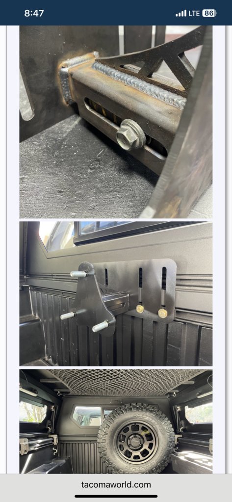

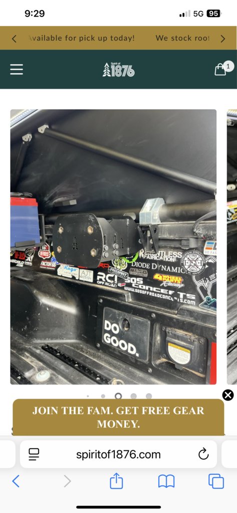

    The 2nd one seems unnecessarily complicated so between the two I'd pick #1, but personally I wouldn't mount a wheel/tire to a bed rail. The rails aren't super stout.

    I know. I’ve seen some post about it cracking the bed when flexed. Was hoping to strap it down and mitigate that. And don’t want to go the other option but may have to. https://www.roughcountry.com/product/univeral-bed-mount-spare-tire-carrier-99073

    Pretty sure those are pics of @aturk rig. You could ask his input on that unit.

    Just a thought. I don't know if this would hold, but could you do a cargo bar across the width of the bed to hold the tire in place against the back of the bed, and if needed using tie down points on the bed rail to help secure the tire and hold it upright?

    Yup that's my truck. The BashFab tire holder is great, I couldn't think of anything you'd want more in it. I do like the BashFab unit over the other one linked, the BashFab one uses actual wheelstuds pressed and tacked into place, which lets you use actual lug nuts which is a great way to carry a few spares.
    With that said, you're limited by the strength of the rails on the truck. I had mine mounted to the front rail and then used a tie down strap to make sure there was no movement getting to the actual front rail itself. Think of it as the front rail was holding the tire vertical and the tie down strap was doing most of the work. Worked out great.
    I've changed my setup like 3-4x since then, I now have a swing out bumper with a tire carrier on it and while that's the best option by far, it also prevents my truck from parking in the garage so I'm usually rolling around with no spare.

    I dont do a quarter of the fun adventures a lot of the people on here do, but but skinny ratchet straps have worked just great at securing my spare.

    This would be my suggestion. have one go across to the 2 attachment points on the sides of the bed and then have one go over the tire and get 2 D rings for the rear 2 bed bolts to attach the strap to those over the tire.
