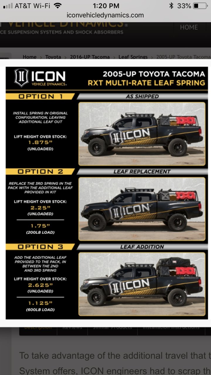

    I appreciate the response, was looking to see if anyone had thoughts on other setups.
    The one I pointed out gives you the ability to adjust between option 1-3.
    Oh, and Icon is the jam as well.

    I am looking for the plushest ride I can get to compliment the progressive rate I have now.
    If I run Heavys that sucker is gonna skip around in the back in the washboarded areas.
    Oh and I drive it like a sports car.

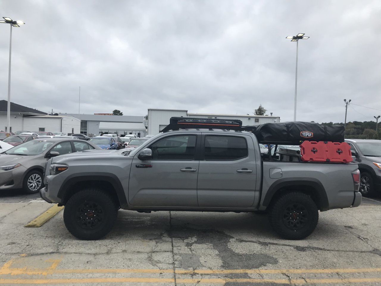

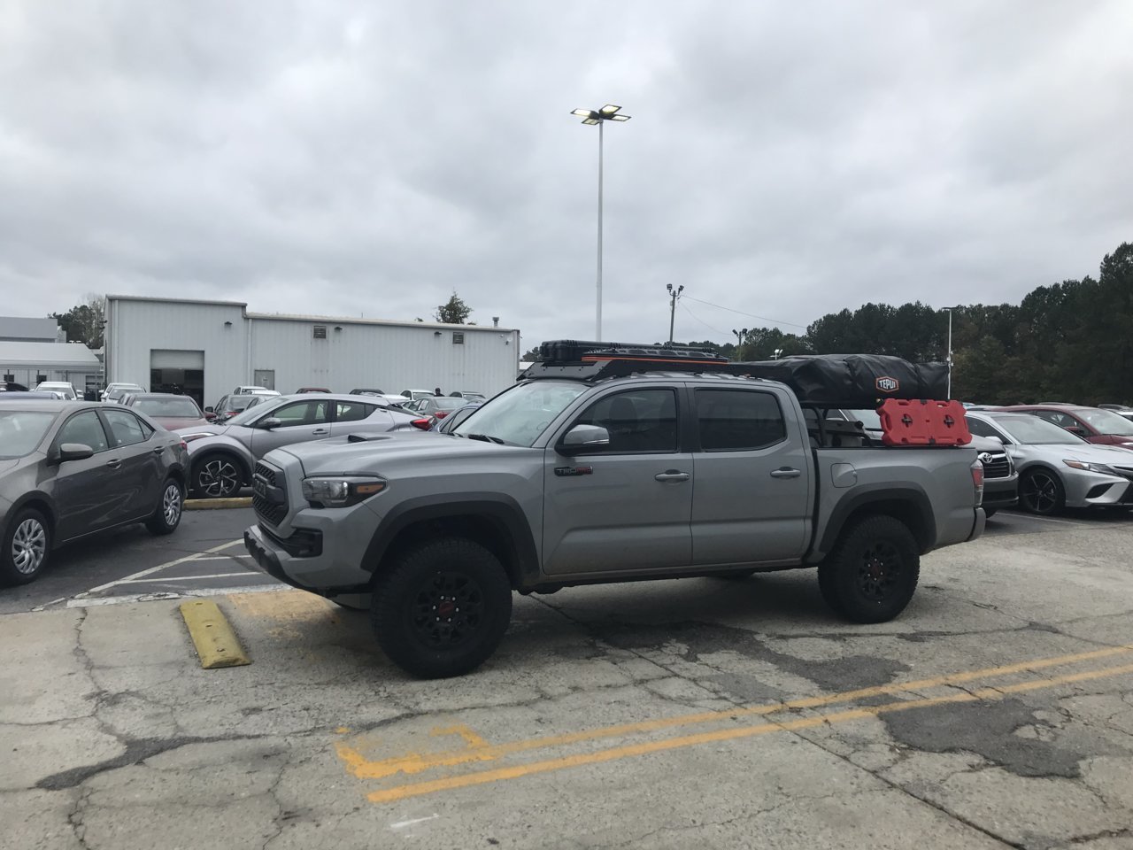

    Definitely looking a little sad in the back. I've all but made up my mind I'll be going with Dakar mediums depending on how well my current setup handles the trip with the RTT next weekend. ~2.75" of lift empty is higher than I want, but if I keep the RTT on like I'll probably end up needing to do, it'll bring that lift height down a bit. That Headstrong Offroad Dakar kit with the Leafs / Bushings / U Bolts / CB Drop / Free Shipping is a super good deal.

    I am curious, the Pro model I have came with progressive rated springs. That being said the front is tuned with a shock and coil setup that is more plush than other models. So I want a set that will compliment the front, so when I hit stuff I don’t get that throw from the back.
    If you look at the leafs (Icon vs Dakar) you can see the spring rates are lower on the icons (more thinner leafs), for this reason I thought they would compliment the fronts better.
    Due to the fact my truck is stock, and I won’t be replacing the fronts at this time... I just didn’t want to over lift the rear.
    These are just my thoughts.
