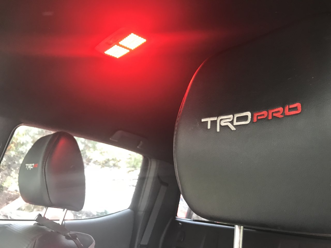

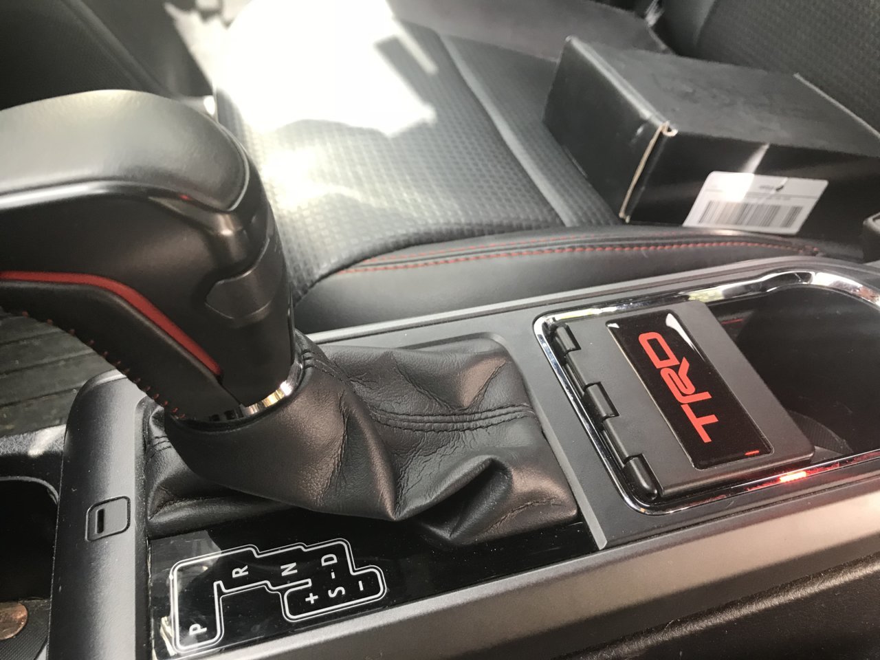

    To all you Vader-haters out there of GA. Welcome to the Dark Side!!!
    @mesojdm Red Dome light and Change Bucket!
    If you have not seen this man’s mod, all I can say is get some.

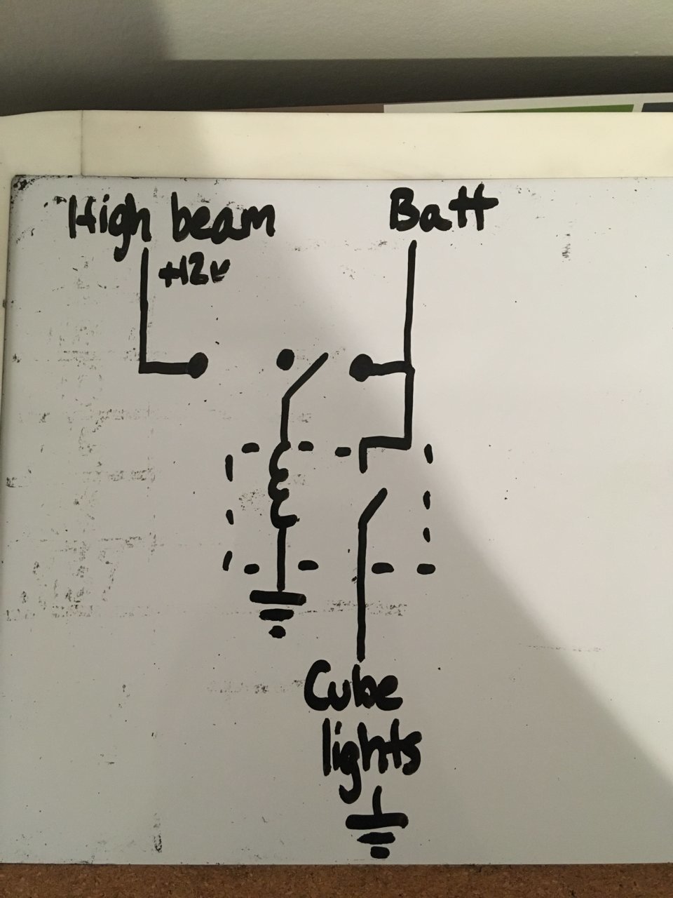

    Making sure I don’t blow up anything up. I got some cube lights that I wanna mount in front of the A pillar on my truck. Function wise, here’s what I want to happen using an on-off-on switch I’ve already preinstalled:
    “On” Position 1: automatically on with high beams
    “On” Position 2: override switch (cubes on anytime)
    “Off”: of course is just always off
    Will this wiring scheme work? Sorry if my schematic symbols aren’t exactly right, it’s been a minute since I had to draw a schematic.

    Pretty much, I have my piaa's wired up the same way on my 1st gen. One hot going out to the lights (middle post maybe?), high beam on one side, and battery or key switched hot on other side.
    Doing so if your switch is lighted or not, that takes away the function. Or it did on mine atleast, tapped the dash lights so it just comes on with marker lights

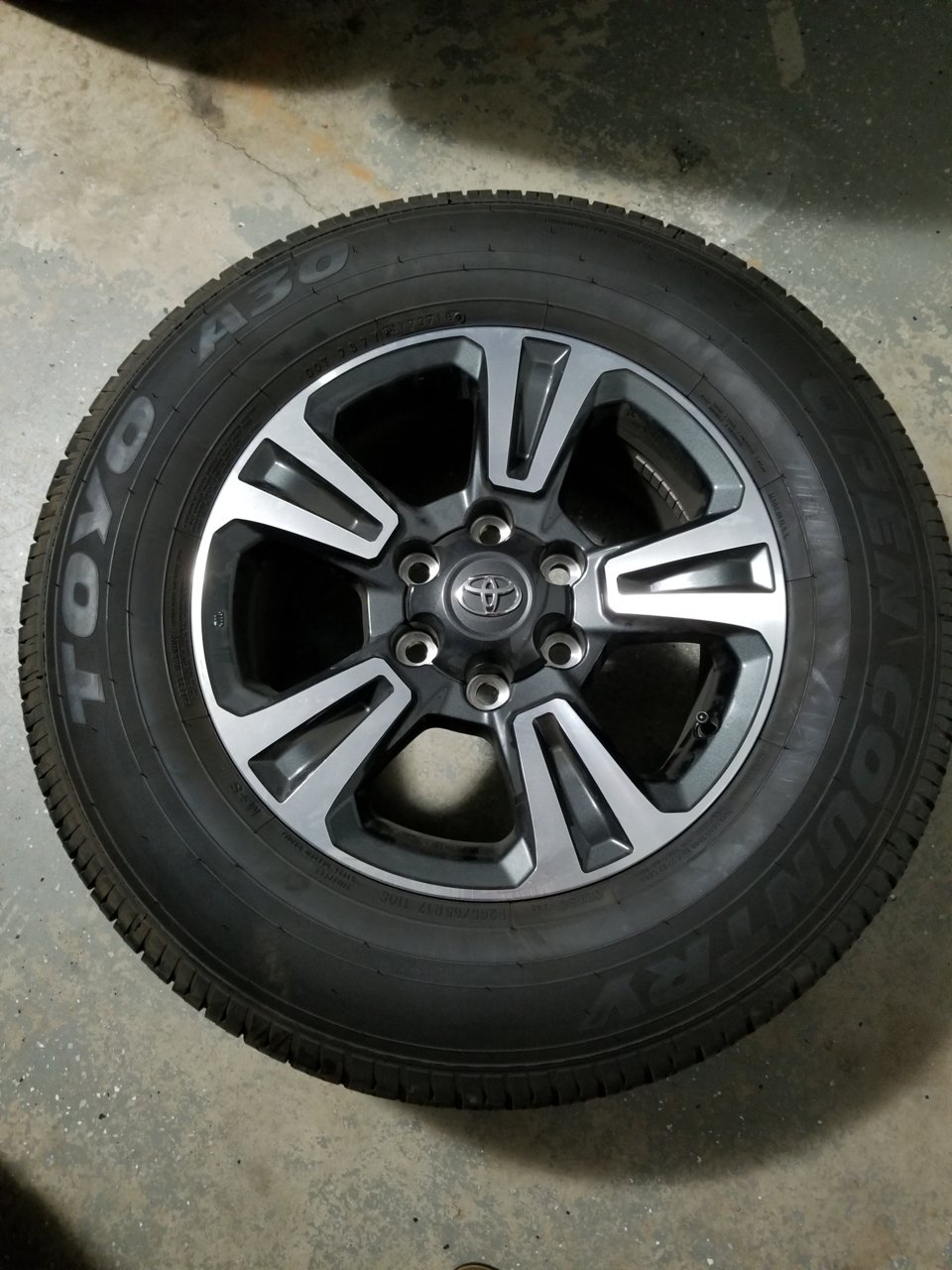

    I have been trying to sell my stock tires since i upgraded. Cant seem to find any takers. Tires only have 3000 miles on them, 2019 Sport Rims.

    Are the red ones actually bright enough to read with?

    Yup
