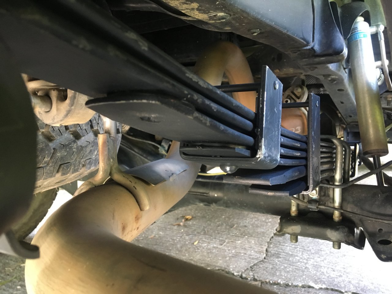

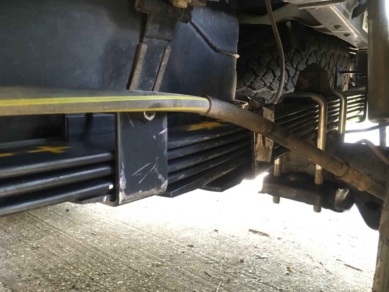

    I did a thing yesterday!
    Icon 3-leaf AAL will be up for grabs very soon. If anyone is interested go ahead and shoot me a PM.

    I don't see the bracket that holds the e-brake line in place. Hopefully, it isn't resting on that bolt head. They also look kind of flat already...not quite frowning, but almost....do you have a lot of weight in the bed, or is the other side jacked up off the ground in this pic?

    I think that photo angle makes them look that way. There's no weight in the bed other than half a tank of gas and my 2 steel bed bars. Here's a better shot that's not from such a high angle:
    And yeah, I need to get that brake line situation figured out. If I install the brake line bracket where that pre-tapped hole is, I think I'm going to have a problem with the bracket putting way too much tension on the brake line. With the 5160's there's about 2" more droop allowed over stock and idk, it just didn't look like there was enough movement there to me. I need to check it again. I thought about just running wire loom over the contact points to eliminate direct contact.
    I'm not dailying the truck right now, so she's only got about 20 miles on her since the install.

    Curious why you didn't spring (no pun intended :anonymous: ) ahead for the u-bolt flip since you already had it all apart

    Already had the U-bolts on hand. U-bolt flip with SuperBumps will be soon(ish)™. :spy:

    I'm running or have run that exact setup, had medium pack, now heavy with 5160, no brake line issues.
