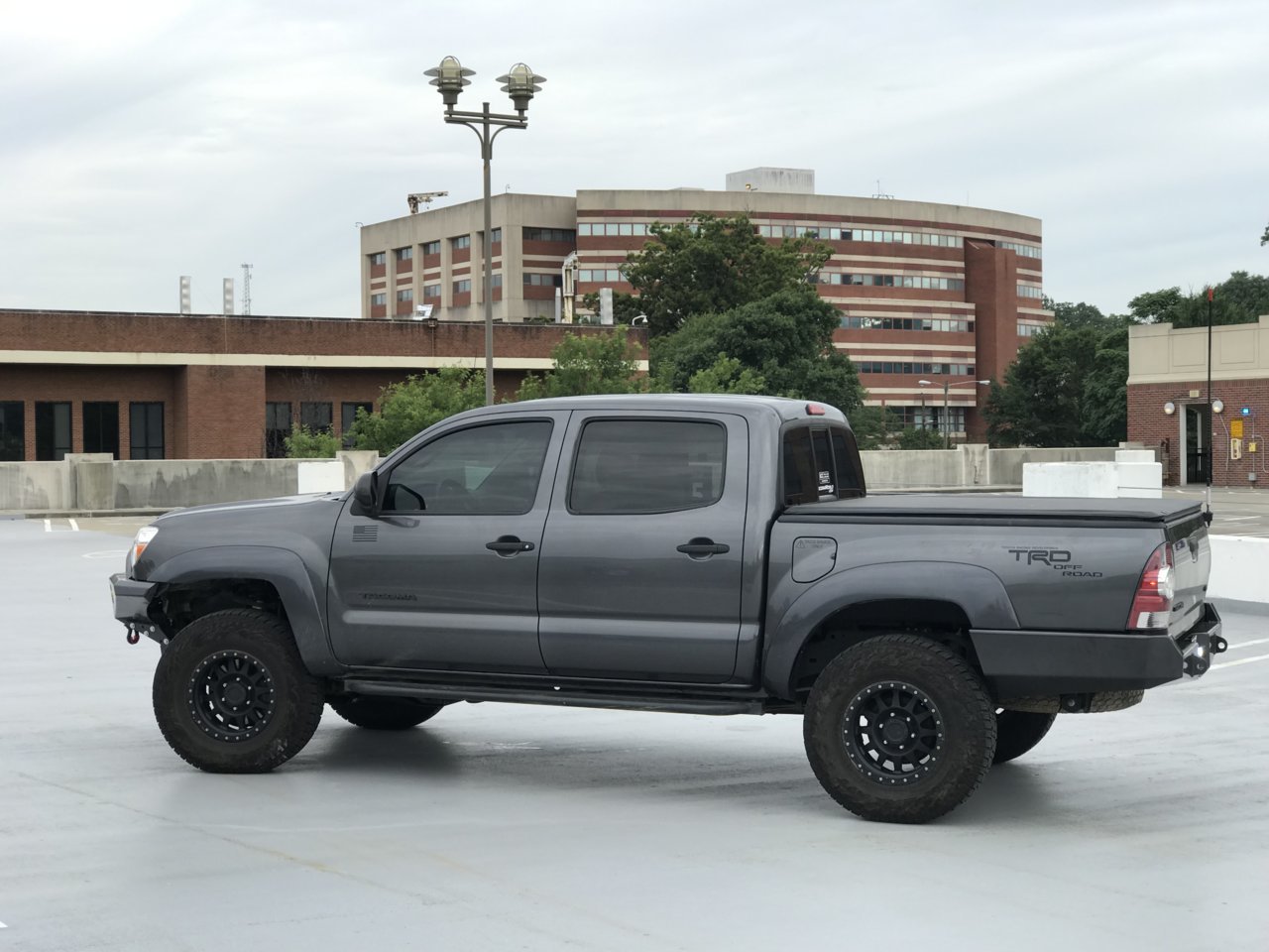

    Where do you work?? Its the North Campus Parking Deck which is right next to the Dalney Deck thats being built now...

    Not a clue, I dont know a thing about suspension. I just want to get some clearance back that i lost. I was talking to Brad last time we went camping and he was telling me about his setup (Bilsteins iirc), so that may be something i look into? Ideally I'd like to ball out and get Kings but I dont think thats realistic, or necessary lol.

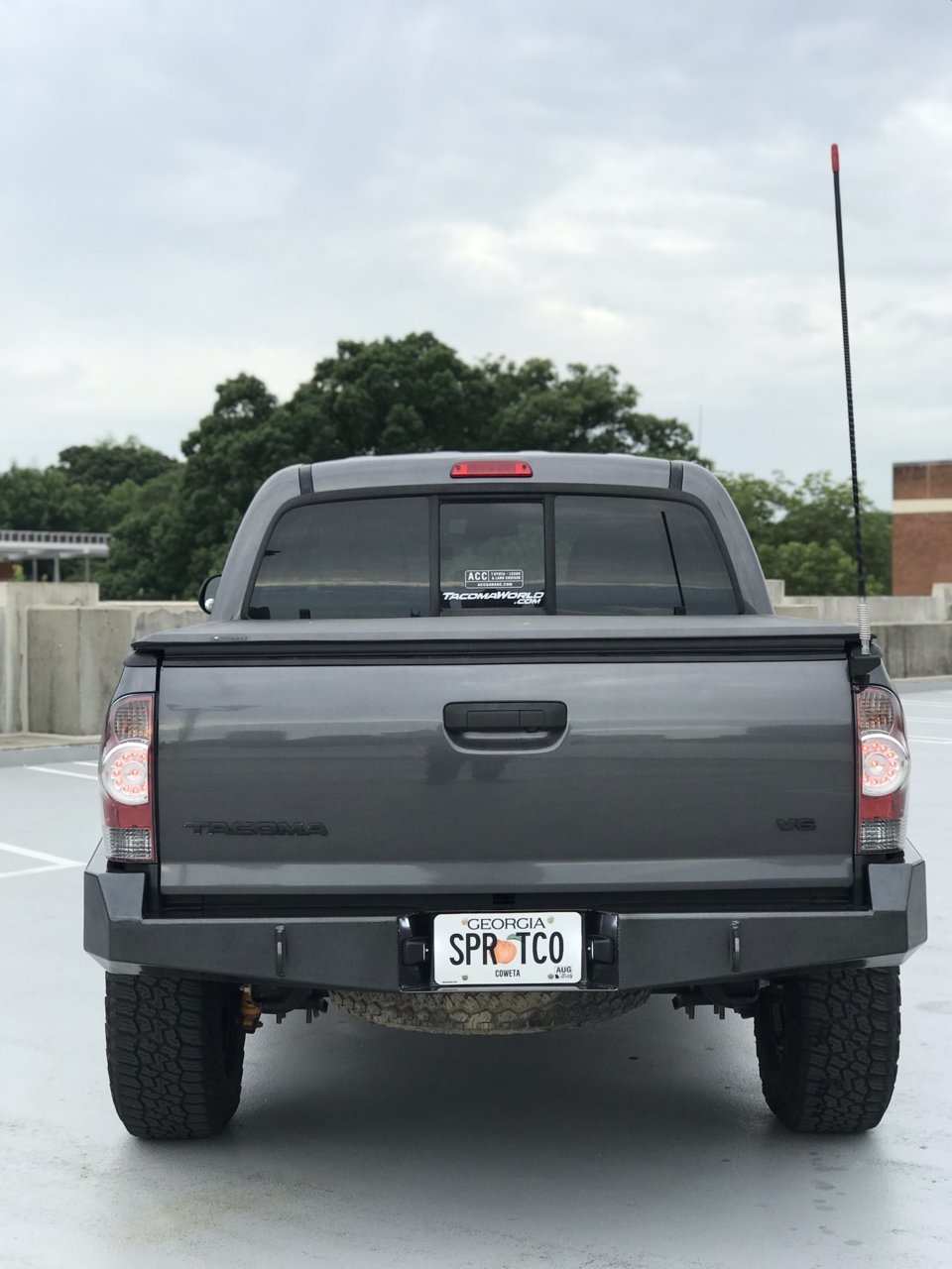

    If you have OME shocks up front, chances are high that you have the 885. I'm not aware of any marking on them other than the sticker, which may or may not have held on. Only way to tell is to look. If comfort is what you want with that bumper, go 887. If you want it to feel more stiff, go 886.
    You shouldn't have lost much height in the rear. The OEM bumper is steel and most aftermarket weigh close to the OEM. You might have a little more weight since it is HC, but I wouldn't think that would have much negative impact. AAL can be a temp stop-gap for the OEM leaf pack. From how I've seen you drive your truck, you want a full leaf pack. So either AAL to an aftermarket pack (like the Dakar) or get a new leaf pack. I would save the money on the AAL w/ OEM leaf springs. You'll upgrade that down the road and then have wasted the money on the AAL.

    I dont think I did, however I wouldnt mind a little increase anyways. I forgot to mention that full skids have also been installed, so there is a little extra weight.
