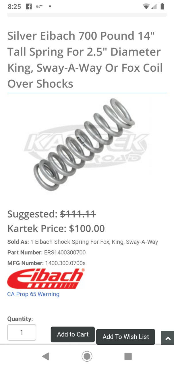

    Do you have a 2.5" shock body? These are what I went for with my Fox springs to get my front height back after a winch / plate bumper: https://www.summitracing.com/parts/EIB-14003000700S - they're Eibach's, just like @BadgerBoy was talkin about.
