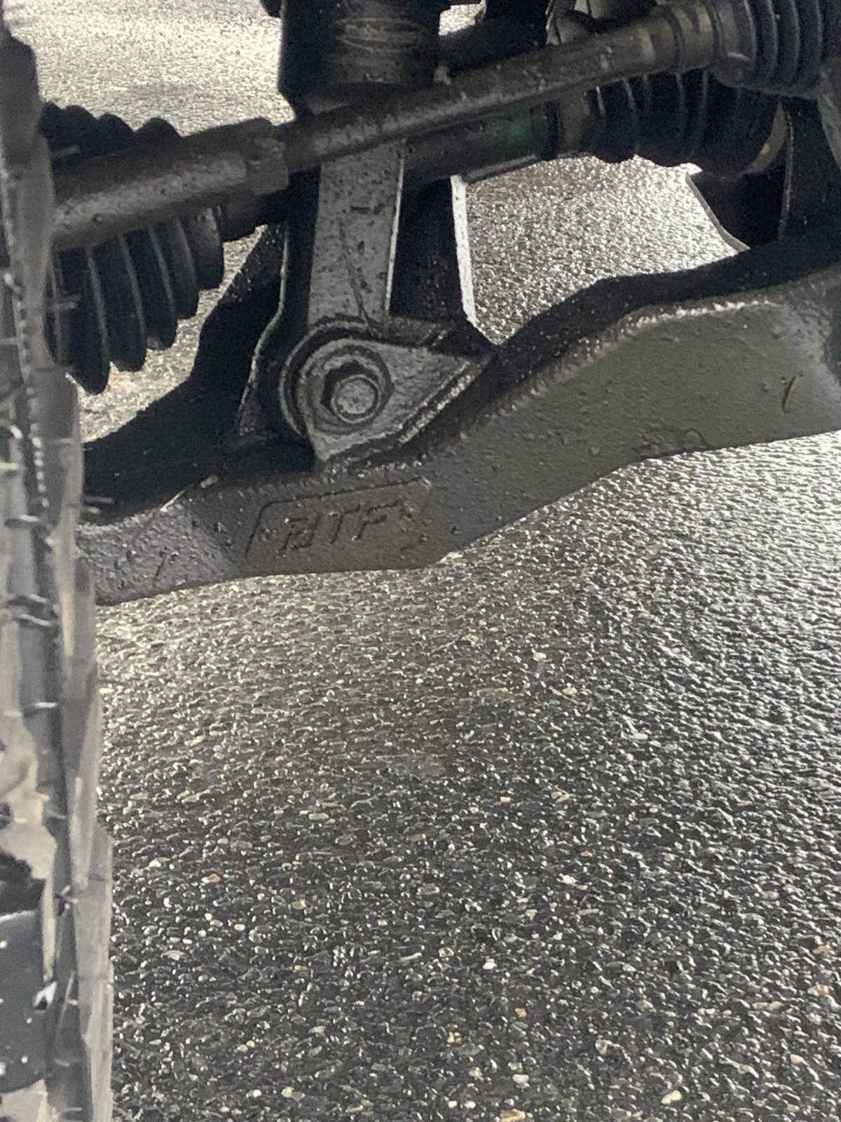

    Under coat them if you’re worried about them rusting. I trimmed my stops all the way and they just barely hit. IMG_3064.jpg

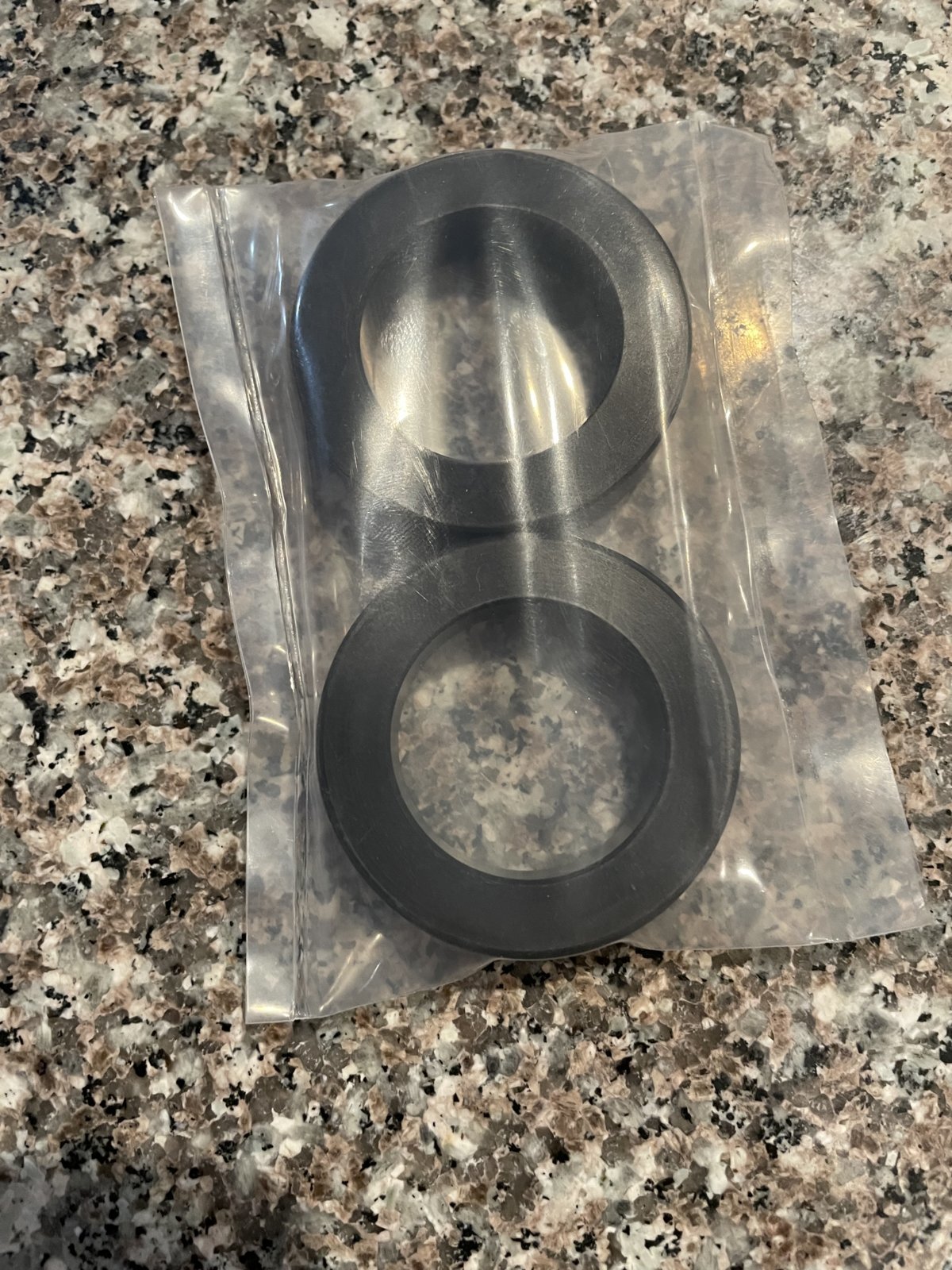

    They charged me $85 for them. I was gonna do these arms but I think I’m gonna make my own lowers to stock specs and then run the jd fab kit for greater adjustability and durability.

    Did you have to call them? I didn’t see them on site at all. Do you have any pics ?

    Emailed them. I believe they come with their long travel set ups. I attached a photo of them. They are fairly simple, and $85 was definitely a good bit for what they are but worth it for me to not play with getting the width right.

    I could have actually done that washer method to find distance and then machined spacers out of delrin at my job. But I don’t have that kind of time usually and camburg knows their stuff.

    so, ID and OD
    what about determining thickness or how many to stack?
    if the idea is to replicate the Camburg one (I don't even see it for sale on their site) for cheaper,
    in terms of copying their thickness, well that pic shows it pretty thick
    looks to be maybe 15mm thick but that's a guess not actual measurement to know for sure
    too many washers/too thick would probably mean less inner TRE thread going into the rack which I imagine could be overdone

    In my case it stops before the outer would go inside "inner rack", you could fine tune to wherever you want to set it to stop.
