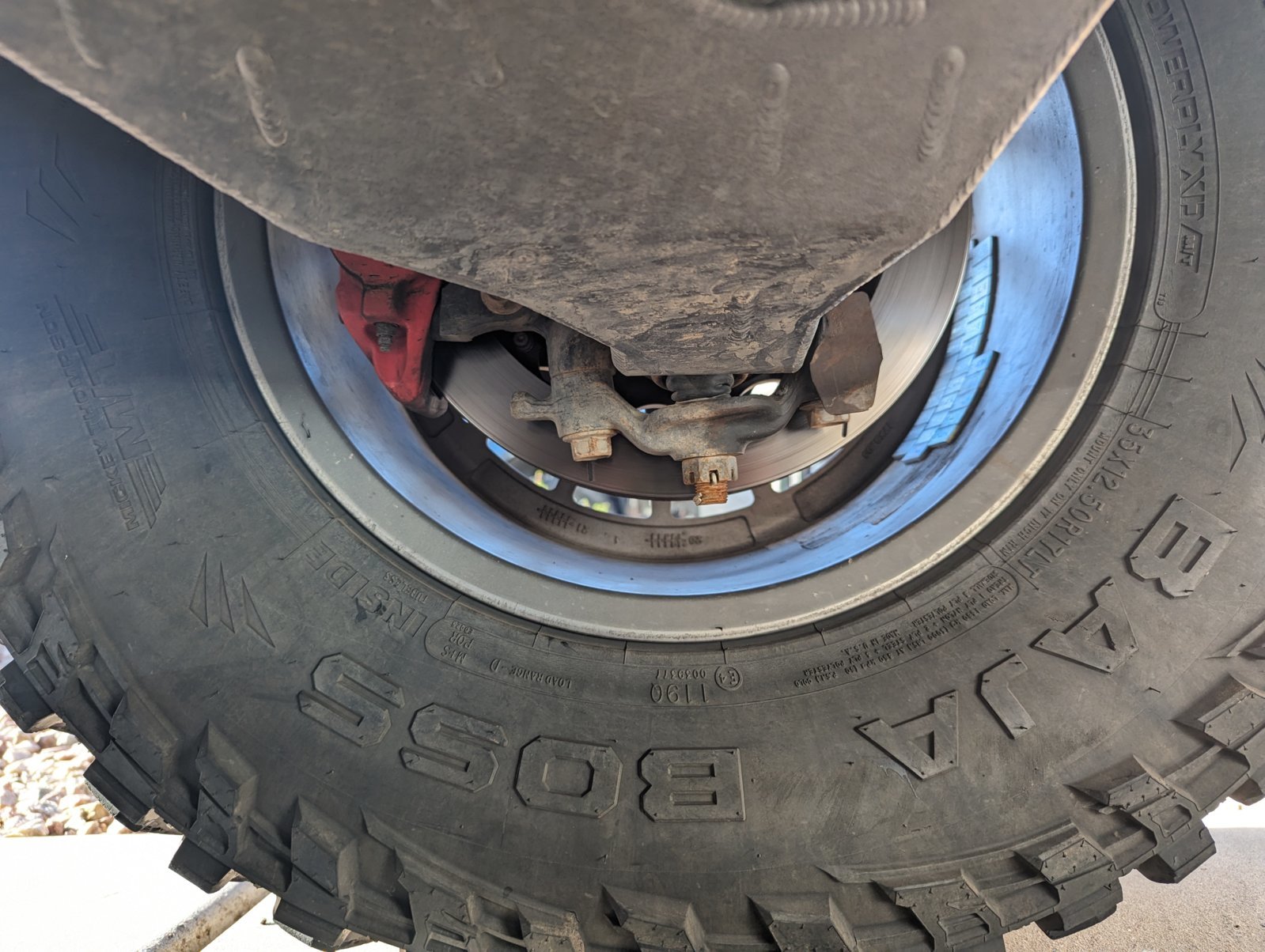

    Anyone running their UCA & LCA in combo?
    I'm currently running 305/70/17 with OEM LCAs and Dirt King ball joint version UCAs it rubs a bit on the firewall. Wanting to go with 315s but wanting to fix clearance issues ahead of time.
    CMR coming soon since the CMC is not enough***

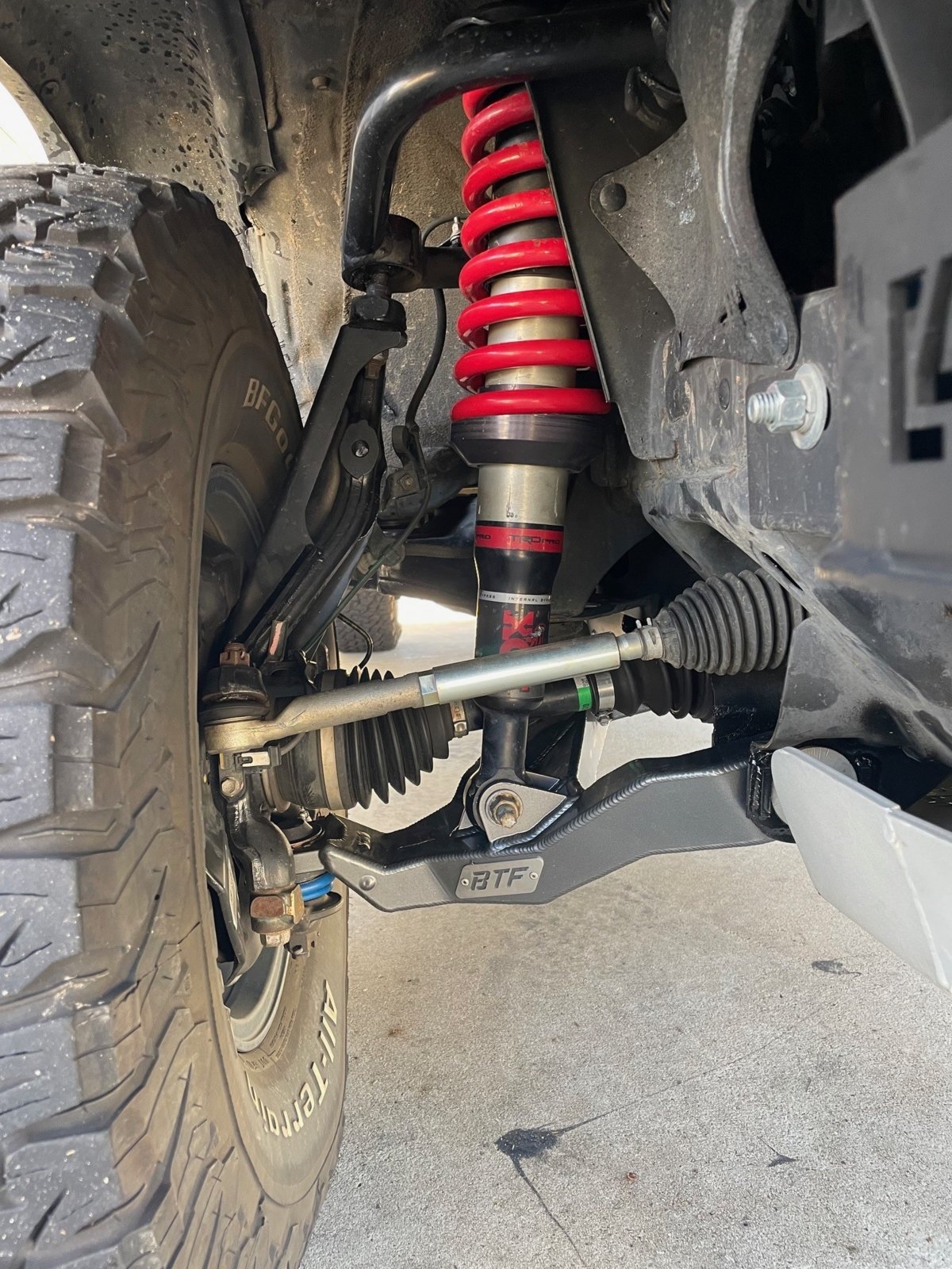

    Installed this weekend

    Who made the tie-rod sleeve armor? Plz & Thank You.

    Dobinson's MRR coils, Deaver Stage 3 leafs, 295/70/17 Yokohama Geolander MT, ATHFab front & rear bumpers, DRT CMR, WarFab sliders, Archive Garage U-Bolt flip kit, SPC UCA (soon to be swapped)
    War-fab is my guess

    Yep it's a fabricated jam nut from War Fab. I don't know if they're still being made now.

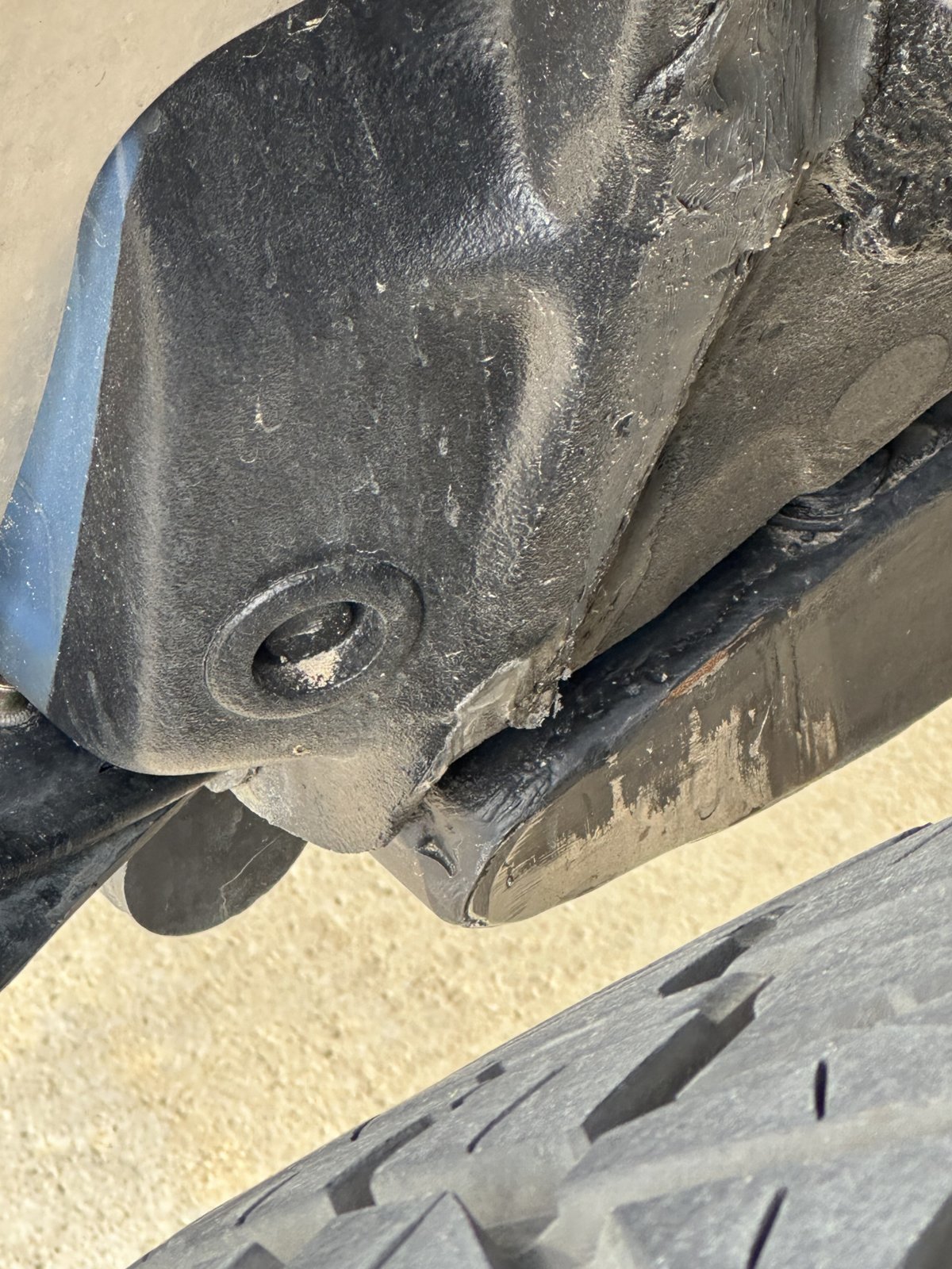

    Mine are Icon tubular UCA with Delta Joint. I trimmed off my steering stops and haven't noticed any ill effects yet. Even with the stops trimmed you lose a little of your turning radius due to changes in geometry.

    this. Havent had an issue with my stops trimmed and cv angles. Have hung a front tire a few times, while steering locked and its all still pretty happy. no sounds, no binding or popping.. just limits radius a bit.

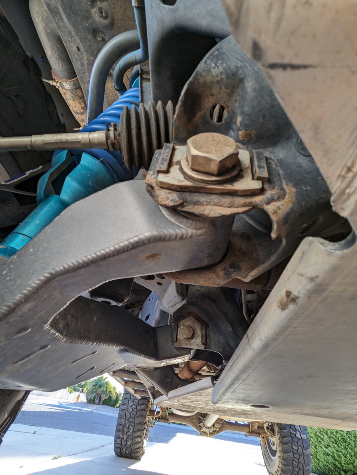

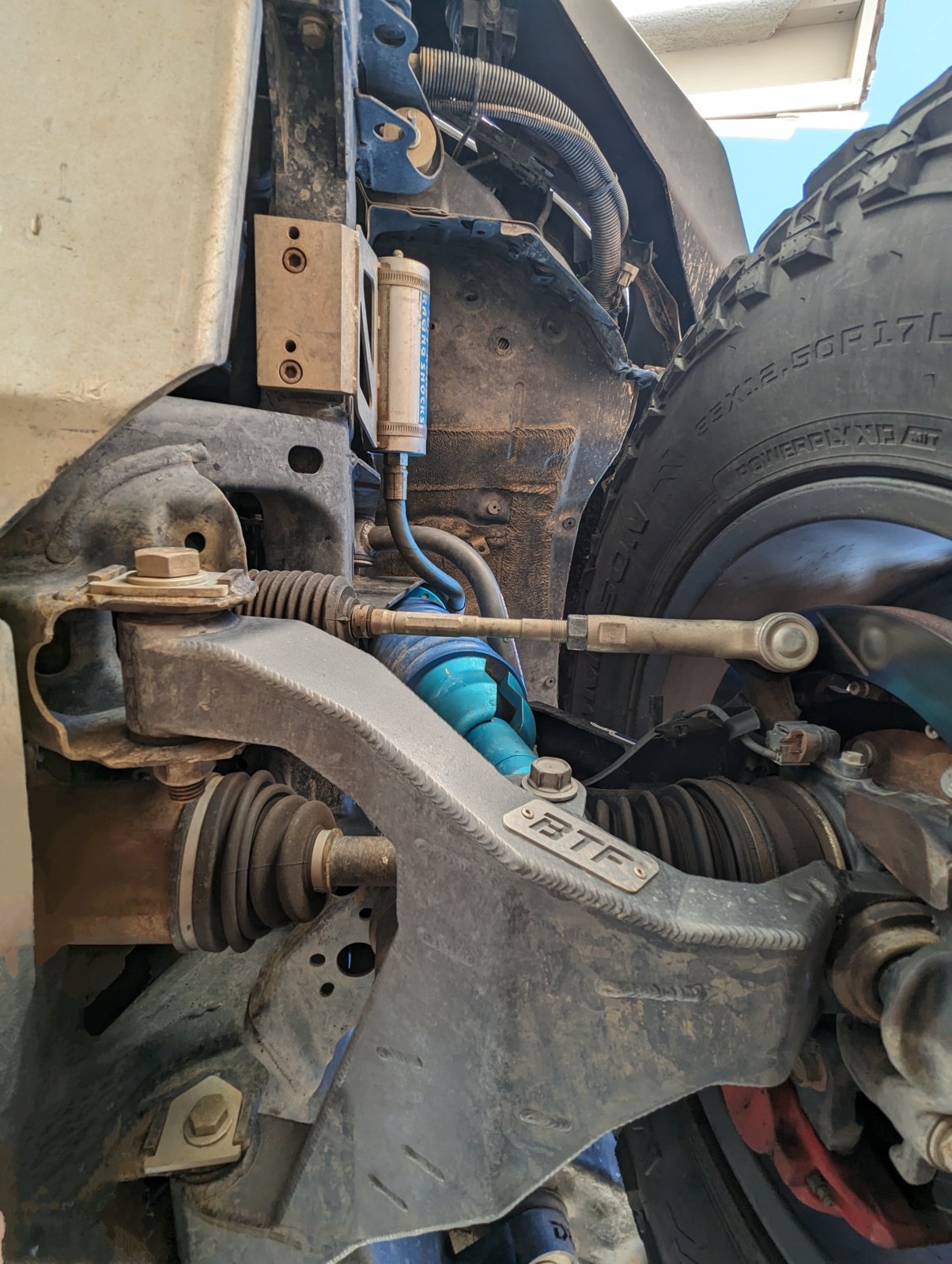

    Any issues with these BTF LCA’s - particulalry with dialed tie rod sleeves getting closer to the shock? Running kings and was about to order but wasn’t sure if the combination of tie rod sleeves and a thicker shock body with a different lca would cause a rub.

    no contact with my Kings, but also dont have the solid or sleeved tie rods. just running stock, easy and cheap to replace/fix, especially on trail.

    That’s helpful! Thank you. What gussets and cam bolts did you go with?

    TC gusseted everything (spindles, UCAs, and cam tab gussets) + Poly Performance Taco Tabs (cams)
