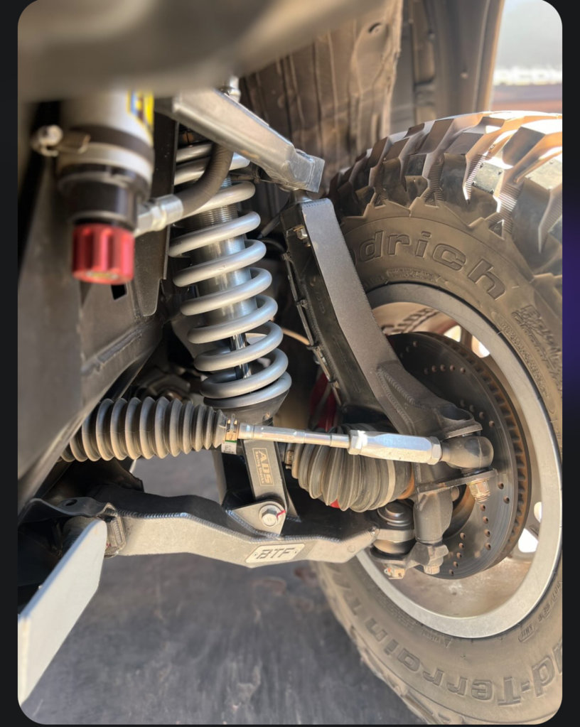

    Looking at a set for black Friday sale and need to confirm something.
    I was trying to setup a time for a rebuild on my king coil over shocks and mention to my guru at the off-road shop, I want these BTF LCAs.
    He looked at BTF website said with my current JBA HD high caster UCA with 3° already built in, going with high caster LCA pushed forward the 3/4", its going to push my alignment numbers into to 5.5-6° range making self return to center on steering non existent and very heavy on hand feel to steer.
    He also said that there may likely be contact between the rack tie rod to the king lower coil mount area at lock to lock steering.
    Any buddy with high caster UCA along with BTF LCAs confirm all this or have ideas?

    You will be in the 5.5-6° range but that makes self centering better than say 3° not worse. It’s not enough to cause a heavy steering feel. I have run 8-10° on several street driven trucks with no ill effects and up to 14° caster on dirt only trucks. It makes them go straight.
    I haven’t had any feedback about tierod to lower shock mount/coil contact but that could be a concern for sure, but I haven’t had that come up yet.

    Over a year and a half on my setup. No issues. 35s clear nicely. Trimmed steering stop a bit. no shocks, no bumps. clears lock to lock as well. fenders cut 2". DRT cab mount relocate.
