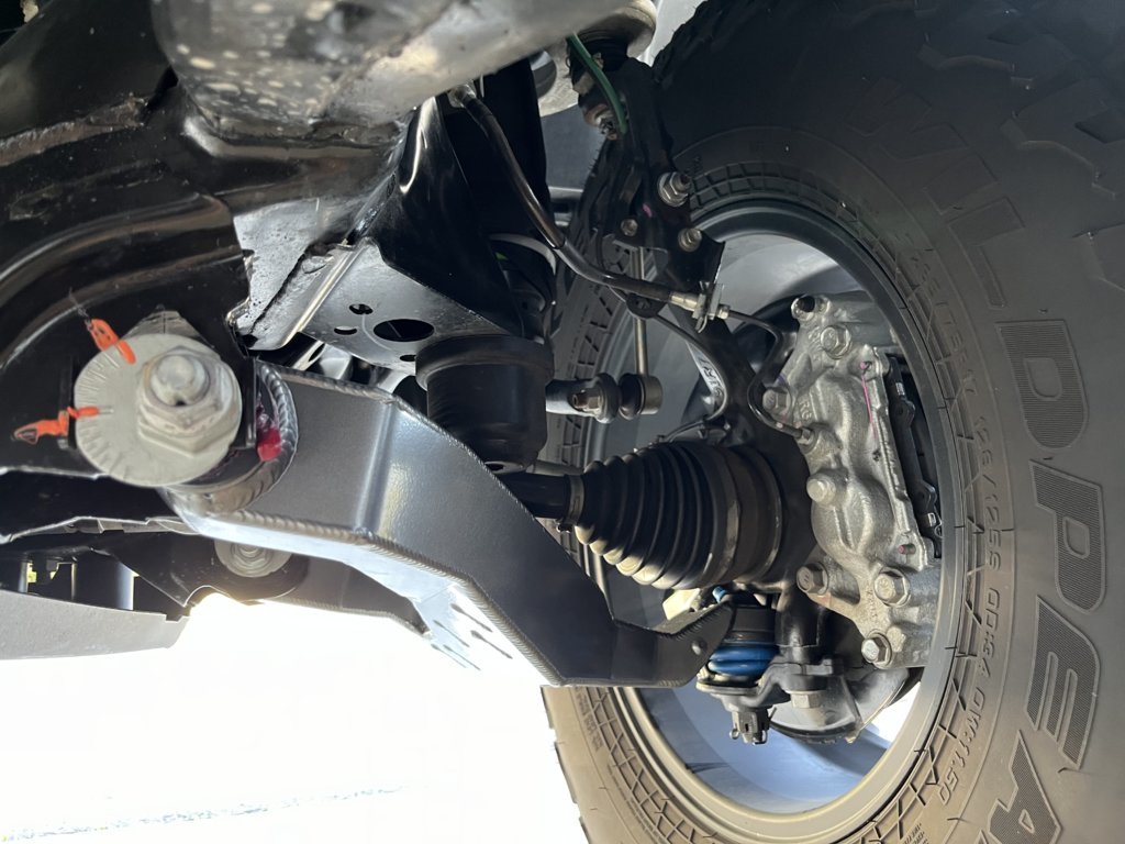

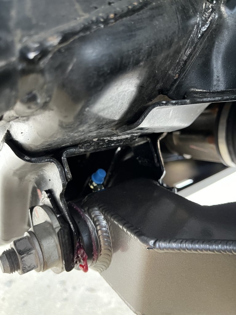

    Installed, aligned, and then drove an hour on the highway. Caster is 7.0/7.0. Ended up getting limit strap mounts welded to the rear of the LCAs rather than mounting them to the eyebolt, and swapping out that LBJ zerk to a needle-style for accessibility. Feels great so far. Should be taking it for a test run at a OHV park tomorrow before I head out to Utah next week.

    so how much tire clearance did you gain with this? Looks like you could get more caster out of them if you really wanted. That’s insane.

    Didn't think to do a before and after measurement, but there's definitely more space towards the firewall, although it's worth noting that my uptravel is probably more limited because I was already hitting the inner fender under the battery cage and wiper fluid reservoir, and probably will be hitting a little further forward and lower.
    Also didn't get a chance to flex them out yesterday, because the 4WD section of the OHV park was inexplicably closed. Going to give it another go elsewhere today.

    My outer fenders and flares are trimmed and I have an aggressive CMC with hammered pinch welds, so I just measured from the driver-side tire to the nearest point on the firewall at ride height. Tires and wheels are 35x10.5R17 Kenda and 4Runner SEMAs with a 1.25" Spidertrax spacer. YMMV.
    Wheel straight: 4" clearance
    Wheel turned: Just shy of 1.5".

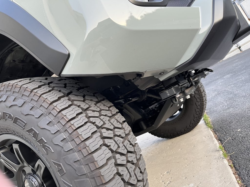

    2023 Gen 3 MT DC OR. Running 285/75/R17s on Zero offset wheels. Had some rubbing. Did not want to cut body mount but needed to move wheels forward. Live in the PNW and it’s sloppy for most of the year and wanted mud flaps. Came across this thread, ordered and received delivery in the spring, finally installed. Well built and easy to install.
    Had a bit of a struggle with the alignment shop and not happy with how they set alignment bolts and will be looking for a shop with a tech that doesn’t reek like alcohol and who can actually communicate - I guess it’s asking too much.
    Ended up with a Caster of 5.1/5.2 and have a bit of a wander I think because wheels want to return to center and I’m fighting it a bit on roads with a crown. Otherwise very happy.
    Was able to add mud flaps and only had to do a minor cut to the plastic in front. No rubbing anywhere and plenty of space. This is how the truck should have been built.

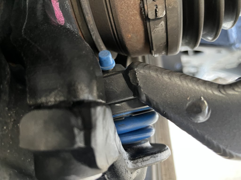

    I do note that as others have stated that after cutting the turning stop off the ball joint bracket it does contact the corner of the BTF LCA but it’s the bottom of the spindle that is contacting it not the bracket I would probably cut a little less off it if I did it again. I added a zoomed in photo of this at bottom.

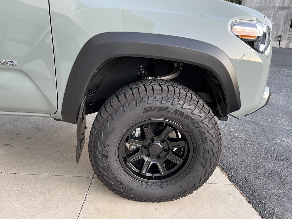

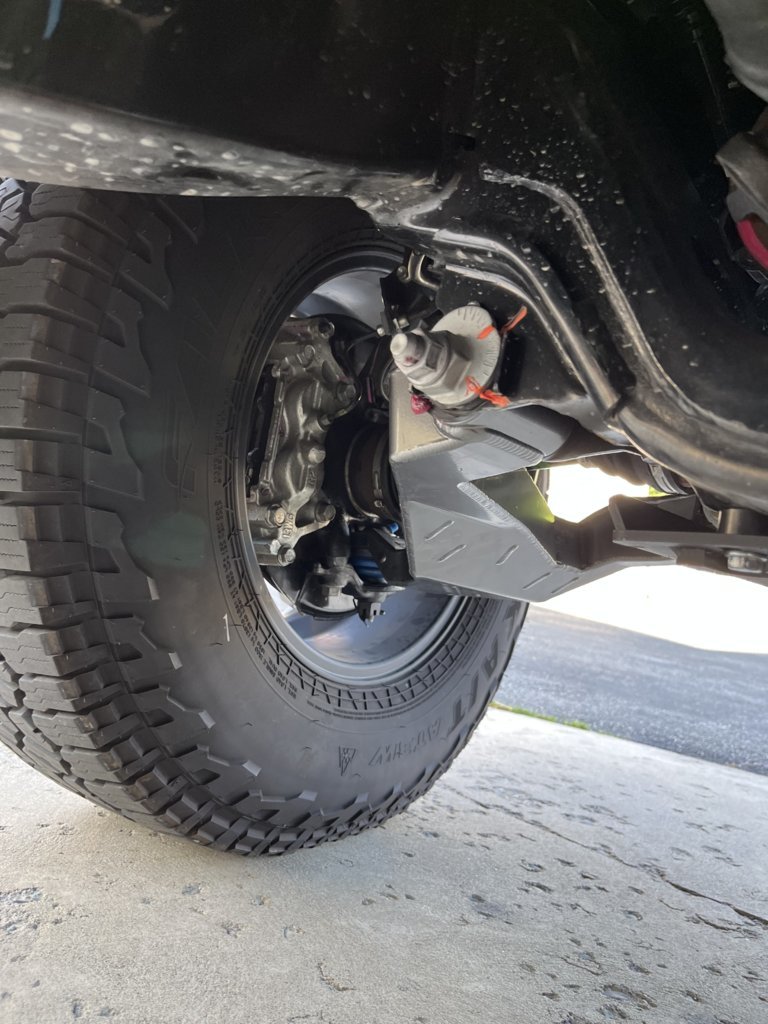

    Here is my updated set up with the BTF's and 35's. I ended up with the 22 trd pro uppers so that I get more forward clearance with no additional caster on top. Drives great. I'm guessing my caster is closer to the 4-5 degree range now.
    So far no rubbing anywhere. But I also have a 1" body lift too.
