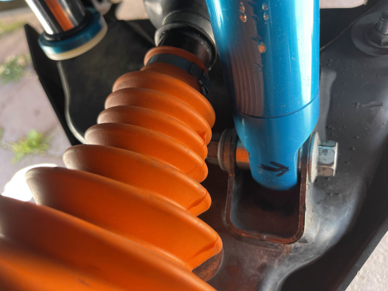

    If the lower ball joint is moved forward 0.75” then I would guess the CV shaft will get closer to the shock by about half that distance since the shock is about mid way along the CV shaft.

    That’s my concern as I am already about 1mm from contact with the stock LCA’s, because of my RCV's. If the shock mount was just moved forward, should be problem solved, wish I could get an answer..

    Shock mount is moved forward, but did run into some clearance issues where things were tighter than ideal. So BTF is working on a rev2

    That is killer to hear that they are working a fix. Thanks for that. My damn RCVs are so close it's ridiculous, I might unclamp and slide the boot.
    At full droop its 1mm, this pic is at ride height. That's even after offset spacers.
