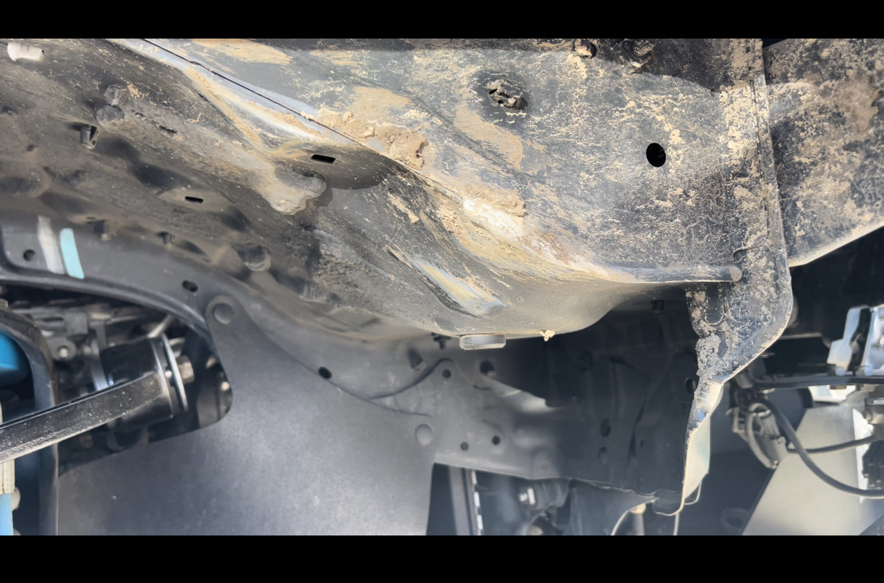

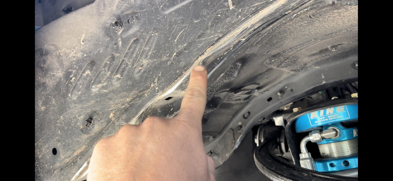

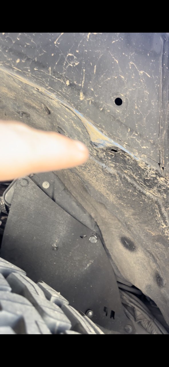

    100% you will contact 35’s into your upper wheel well if you do hard wheeling. That’s a fact no one wants to admit.
    I had to limit about 1/2” of uptravel with adjustable bump stops to keep this from happening. I’m pushed all the way forward with my lowers and all the way forward with my SPC uppers. If I was any further forward I would be making contact with that area behind the headlight.
    Here is some pics of mine, you have to really tub the shit out of these areas if you wanna truly not rub or limit your up travel.
    it’s also pretty dependent on your coil settings as well though, the more you lift your coils, you lose down travel and gain up travel to an extent.

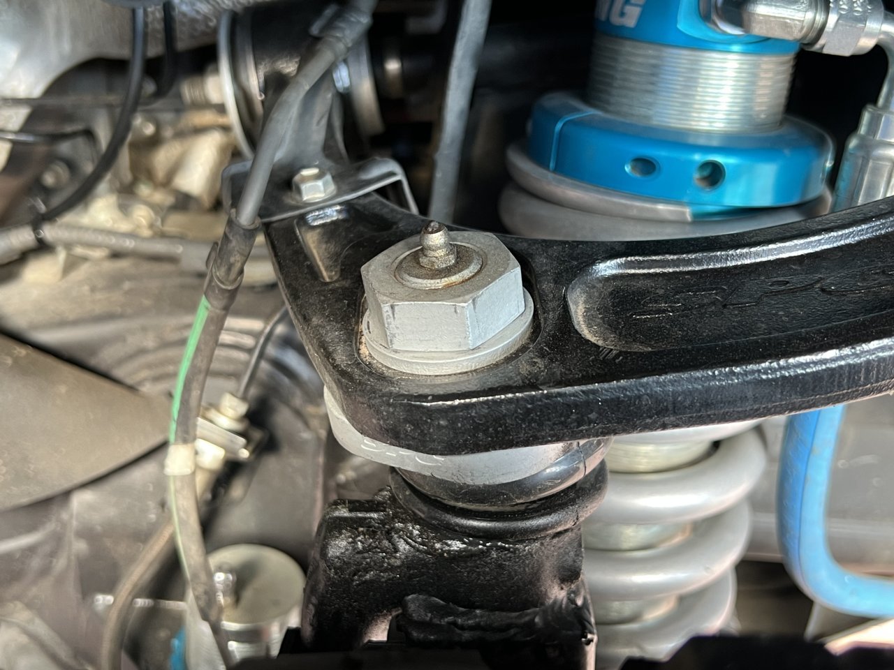

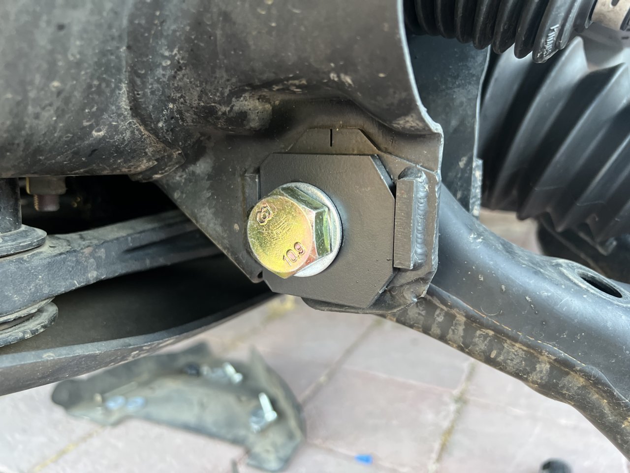

    You're saying both the LCR and the UCA ball joints are moved all the way forward? And you still have enough +caster for a good alignment?
    My understanding is that the LR UCA should have the ball joint neutral or pivoted towards the rear to compensate for the more consequential LCA that has more influence on the position of the tire. That's why the rear cam bolt on the LCR is rotated outward, and the front is rotated inward, moving the hub in an arc, towards the front. Being that the rear mount is parallel to the hub and the front mount is offset.
    This write up helped me a lot. I thought the LR UCA should be set with the ball joint swung to the front and the LCA is tuned off that, but it appears I had it backwards.
    https://www.tacomaworld.com/threads...-that-wheel-and-love-alignments.594309/page-7
  17. Jul 18, 2022 at 5:50 PM
    #57
    ZebraScissors
    ZebraScissors [OP] Well-Known Member
    Oct 3, 2017
    #231922
    398
    Drake
    Reno, Nevada
    2018 Cav Blue TRD Pro
    So my lowers are maxed and eccentrics are completely deleted. My SPCs are not fully maxed forward, but they are on setting E, which is -1.0°
    The lower does for sure have the most effect though. My caster is currently at 3.2° like this. Truck rides great, tracks great, turns great.
    I don’t even come close to hitting my cab mount or rear of the fender well, but I did stuff my entire tire straight up into the underside of the fender. I remedied that by adjusting my bumpstops down a little.
    You can really only do this with SPCs or I guess the Icon billet adjustables.
