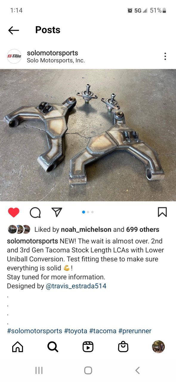

    Solo also coming out with an arm, supposedly moves the wheel 1" forward and runs a uniball setup.

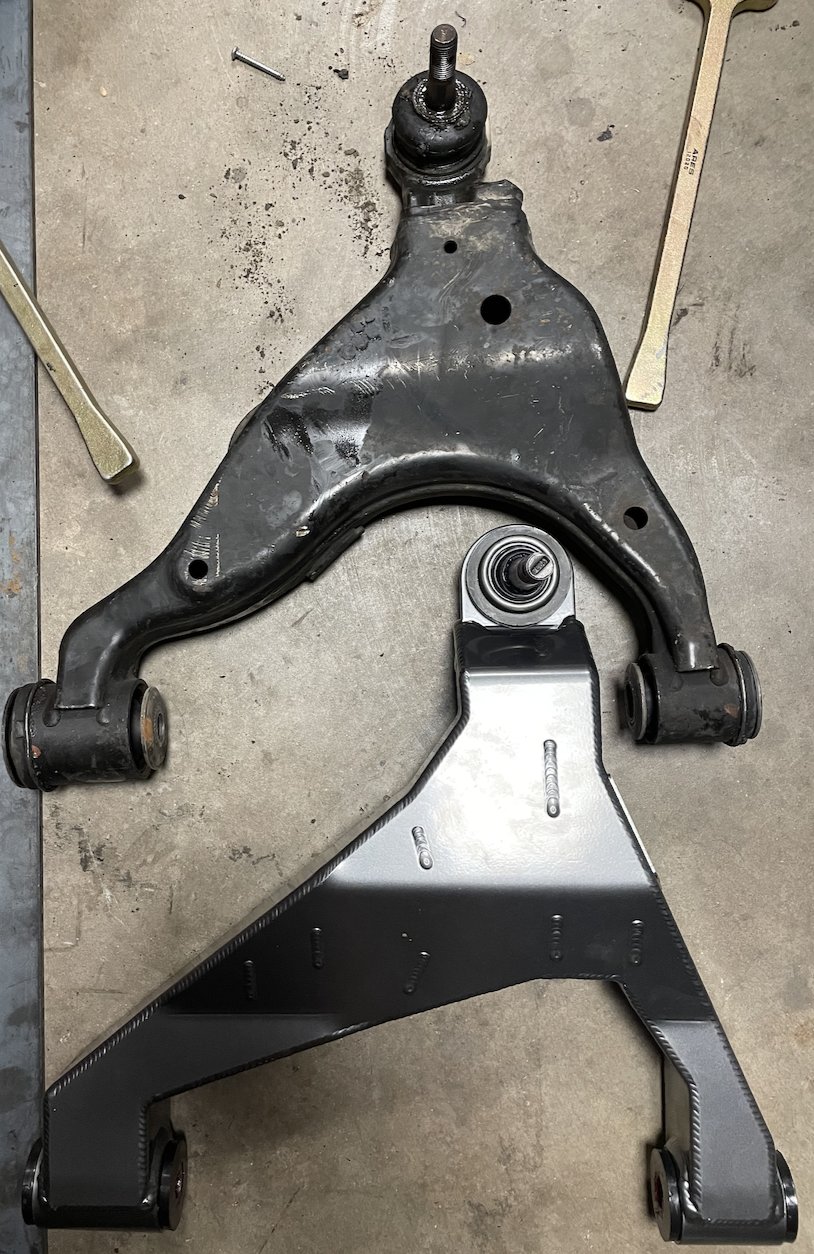

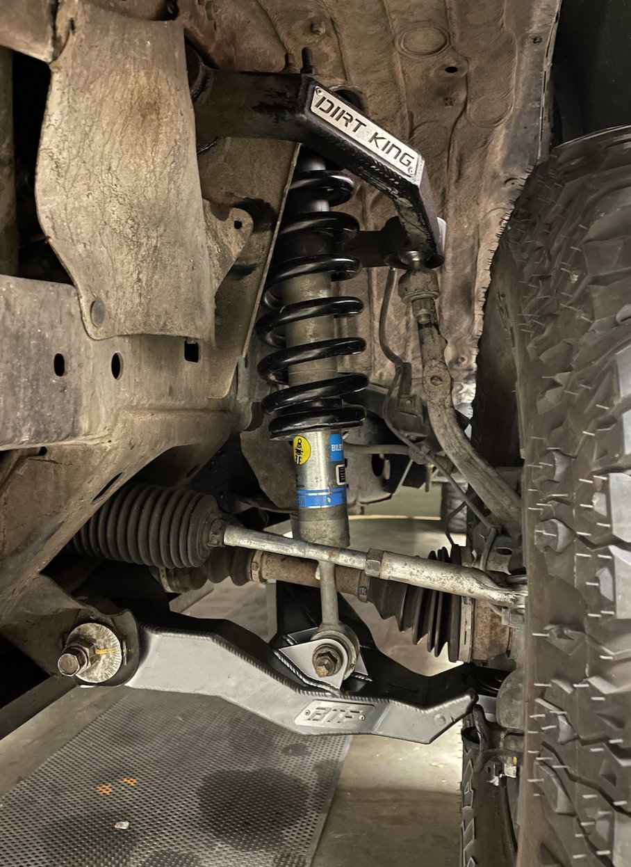

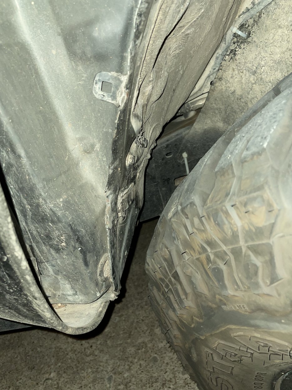

    These gems arrived on Wednesday so I tossed them on last night.
    My old LCA ball joints had play and I'd get a pop-pop on bumps - when I removed the LCA I was able to easily pull on the ball joint and get the up-down play - so those needed replacement. The bushings were also shot so rather than new bushings / new ball joint I took this as an oppty to upgrade ... It's probably a mix of the overall LCA, the new ball joint, the bushings, and my general excitement, but the front feels much tighter, in control, and I no longer have the pop-pop and other sounds as I hit the normal bumps on the road. I'll be mall-crawling for a few days and will get to the trails next weekend and will report back on where I get contact.
    I tried here to show the difference in the ball joint.

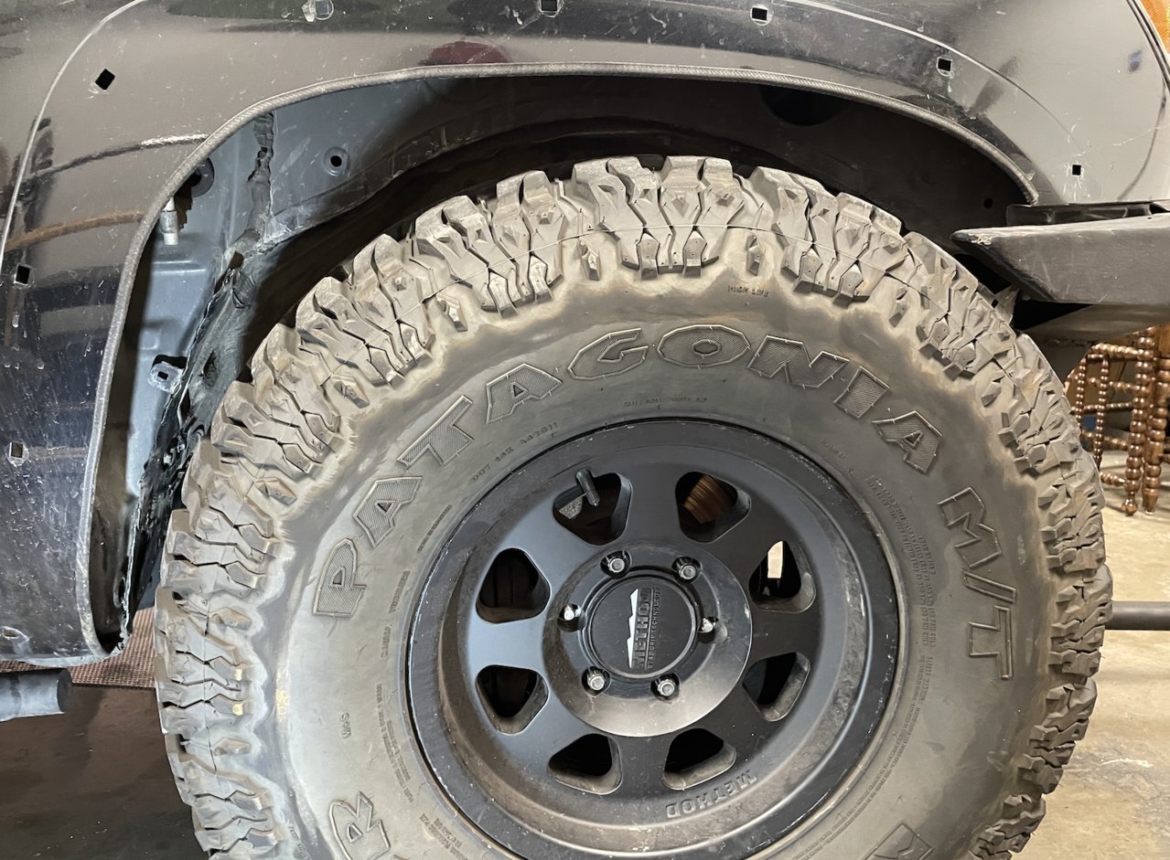

    Here is a pic with no shock sitting on my bumps - cams are pushed all the way out (forward) in the rear and in on the front - the same way I had them before these LCAs and how I have them now. It is now very much centered in the wheel well. And yes I plan to cut the end of the front bumper.
    Looks good ...
    Before these, I would rub the rear wheel well backing out of my driveway on a fairly steep decline with the tires turned close to full lock. Now as you can see I have plenty of room.
    I did take a few measurements before and after and I'll note the DS changes below (the PS was similar). For reference I have 315/75/16 MS Patagonias on those method bead grips (0 offset / 4.5 BS) with a 1" wheel spacer to keep me from hitting the UCA at full lock. I also have a 1/2" top hat spacer on the DS with super bumps up front. 5100s with headstrong coils (don't know the specs). Measurements are before --> After . These are all at ride height with everything buttoned up.
    • tire to closest point rear fender / wheel well: 8.5 -> 10cm (~.5")
    • tire to the front closest point on front bumper that I need to cut back: 14 -> 15.5cm. I thought this would decrease. It turns out the height increased ...
    • ... top of the tire to the fender: 21.75 -> 23cm
    • the low point on the LCA (just off the wheel): 29.5 -> 30cm
    • measured from the ground straight up to the LCA shock bolt and measured to the low point on the LCA through that line: 30.5 -> 31.5cm
    • front skid ground clearance: 34.5 -> 36.5cm
    Using the scientific flat bar method in the DIY Alignment thread for camber I am at 89.7* on both sides after a few miles driving around.
    Overall - I am thrilled and can't wait to hit the dirt.
