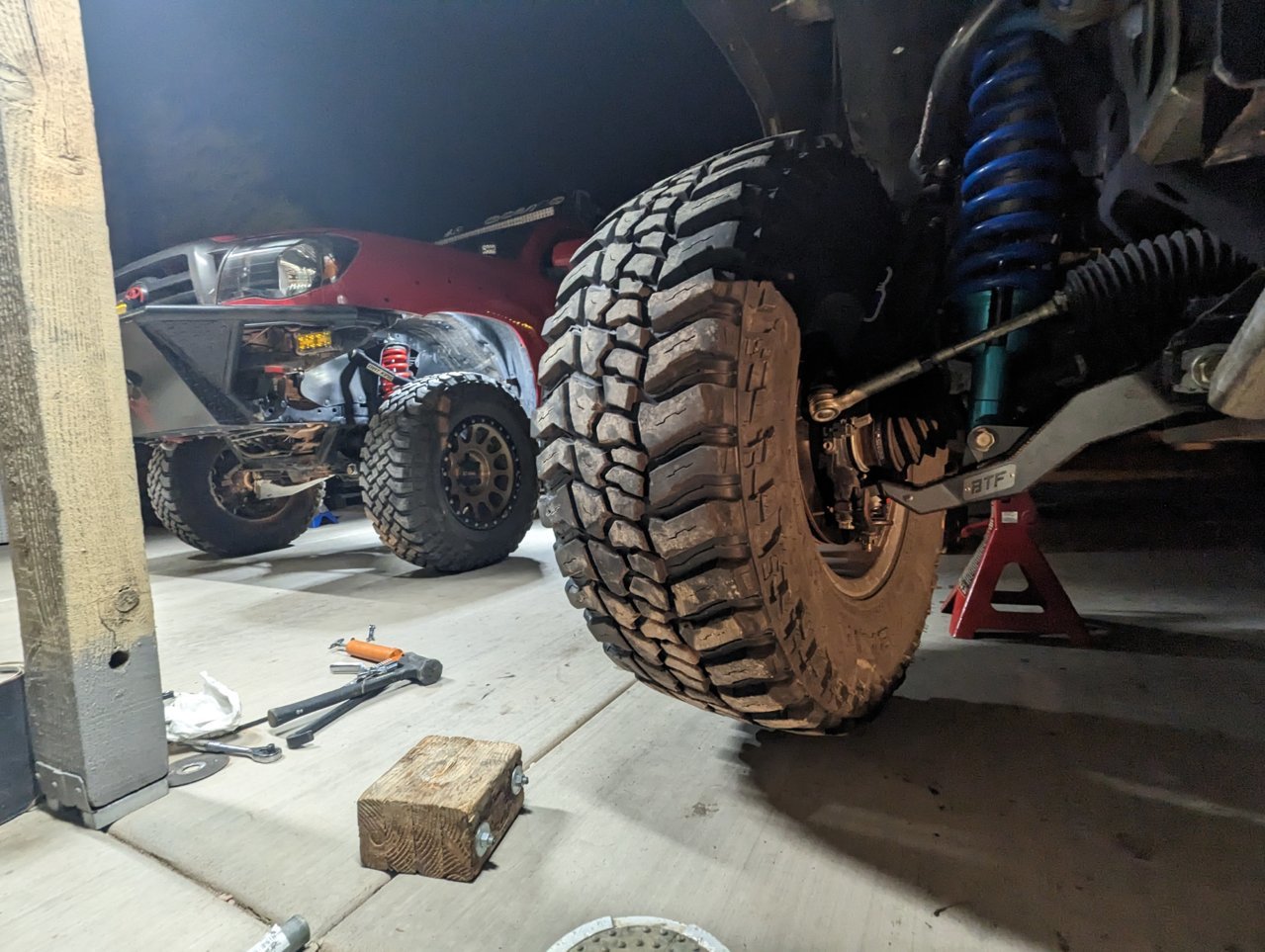

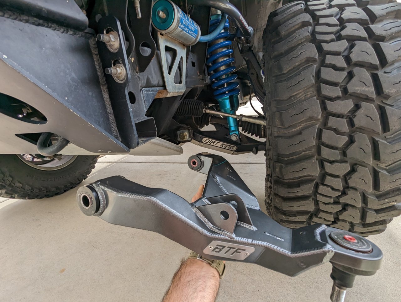

    Damn that was fast! @BTF Brandon. Thank you! :cheers:
    Ordered Tuesday.. arrived today. Slapping these on this weekend!

    Swap went smoothly last night.. so much room now. Excited to try these out wheeling! Thanks again @BTF Brandon

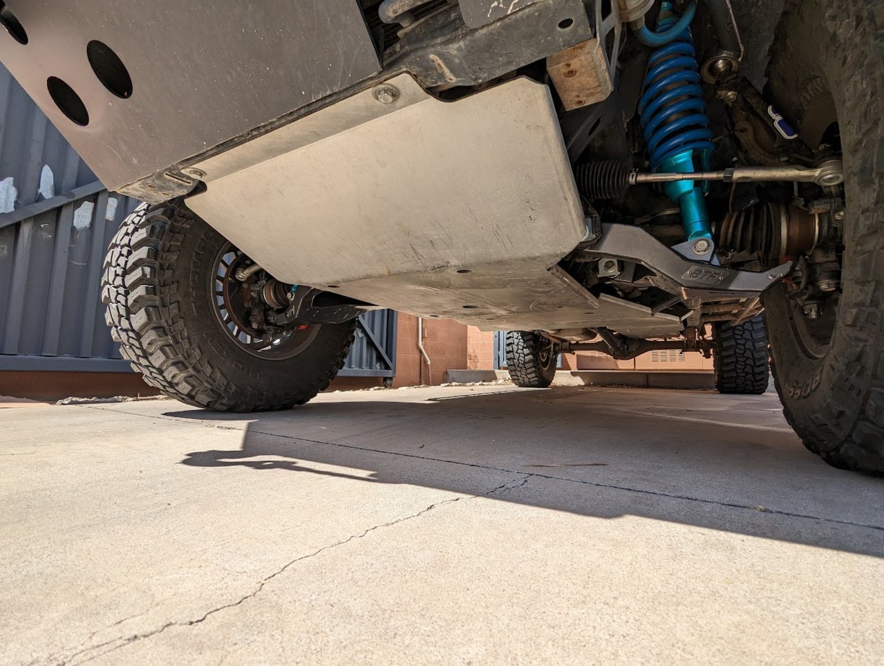

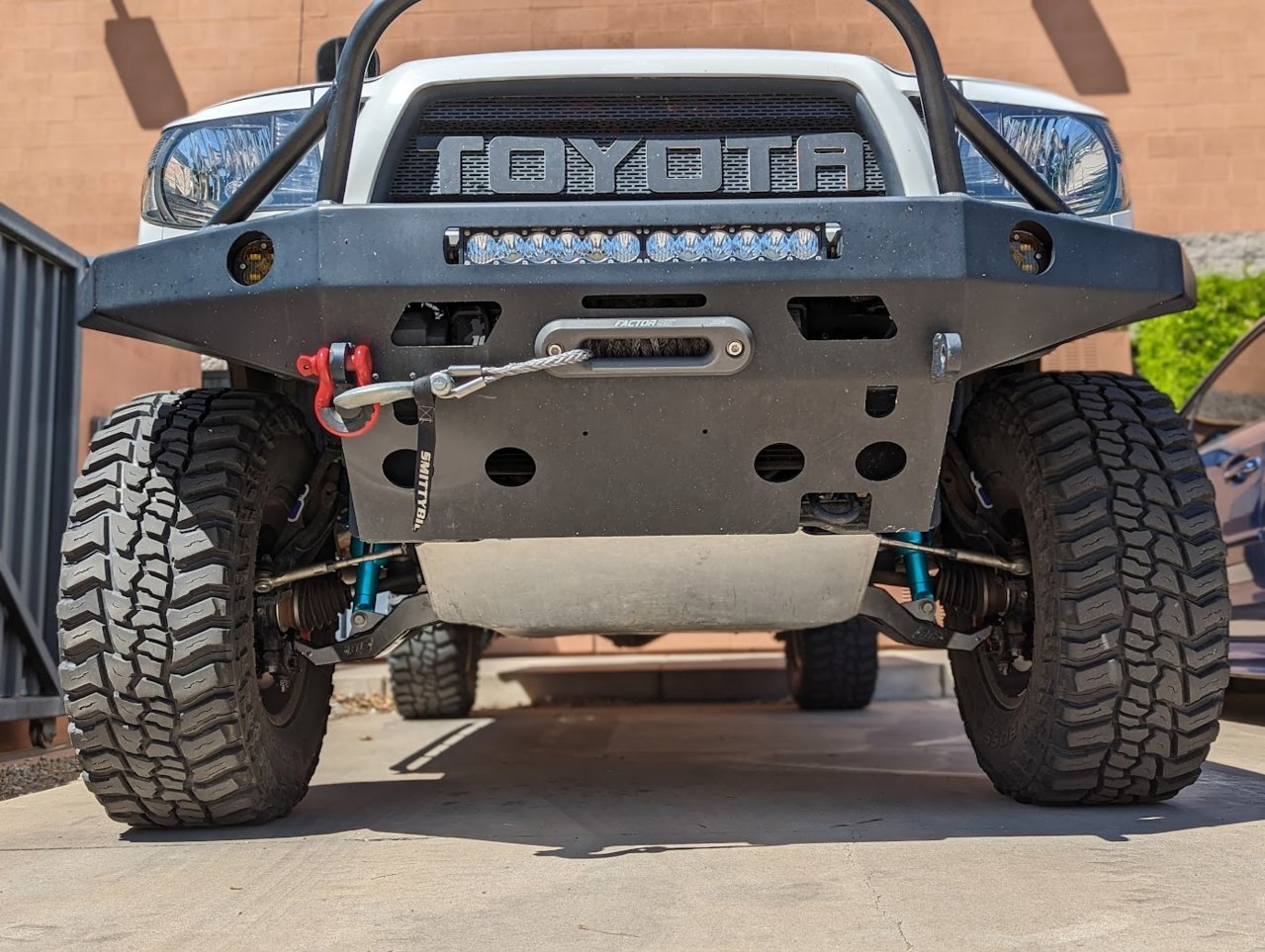

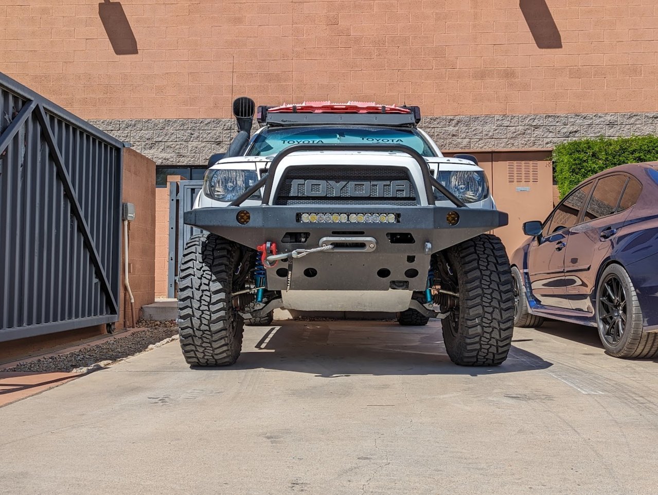

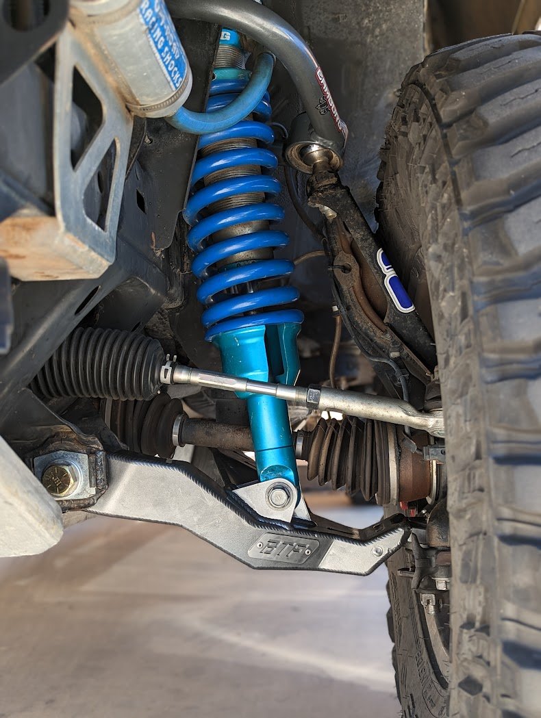

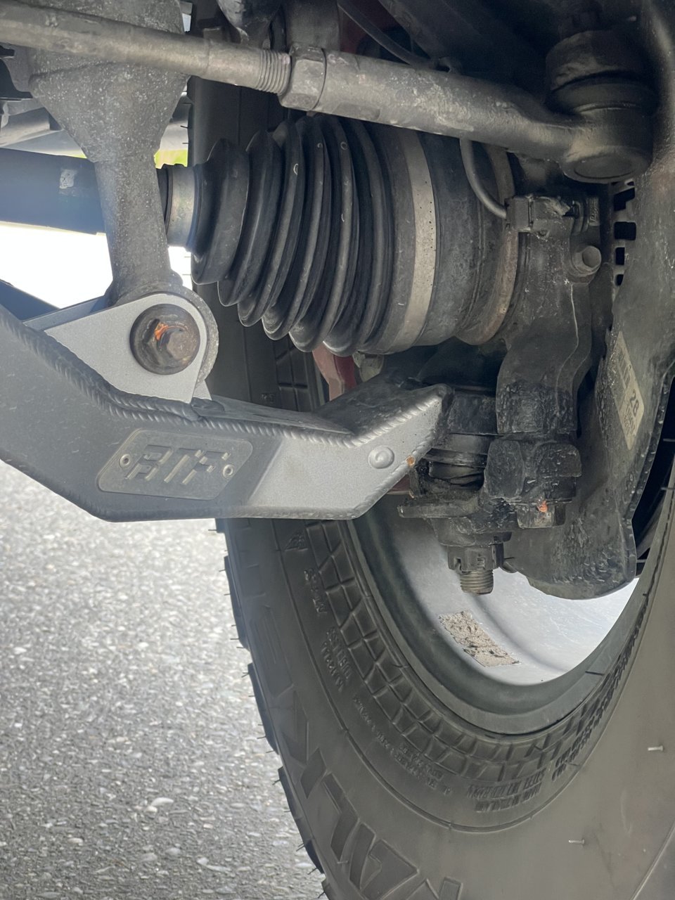

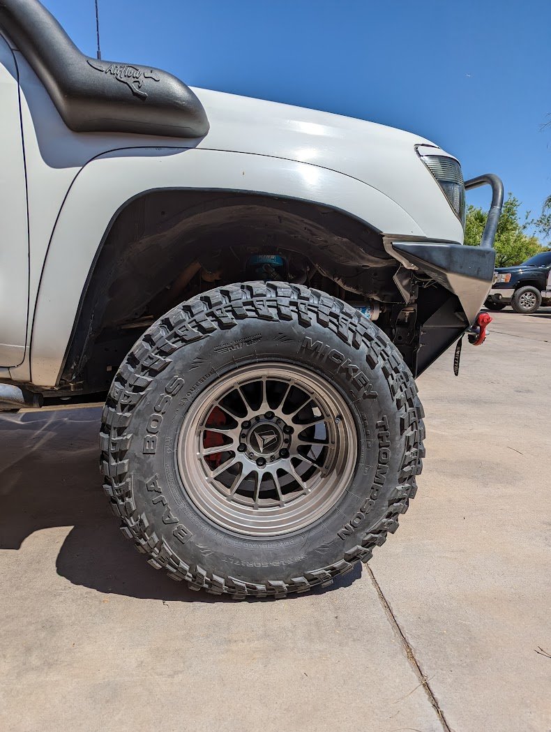

    Some better pics of the BTFs..

    Looks great. did you keep the hex tabs you have in the same spot? Have you gotten it aligned yet?

    I did keep them in the same orientation/setup, yes. I knew the truck was aligned with those in place prior (really just setting toe at that point with the Poly Taco Tabs) and since the BTFs shift everything just forward, I decided to keep them the same as before and start there. It drove great on the 30 miles back after install. I will take it in to get the alignment checked and toe adjusted if needed.. but mostly just to see where its at caster wise now. I should have a decent amount between the BTFs plus my max caster alignment. Noticeable amount of added clearance at the firewall now, especially with the Taco Tabs maxing rear caster.
    We'll see how it does the first time out wheeling. :thumbsup:

    yes they do. you can see them in my pictures above
