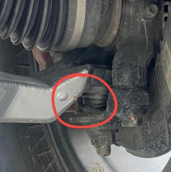

    Also, it looks like the LCA is maxing out against the knuckle.

    That was from when I first installed the LCA and didn't cut the steering stop but the turning radius was really bad as it would contact prematurely.

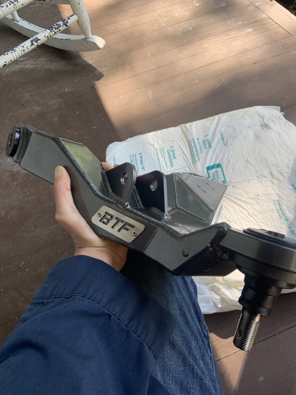

    CF61893B-ADF8-4EED-9975-BC253083C718.jpg Just got mine in Friday!
    JDSmith and XPOTRPR like this.
