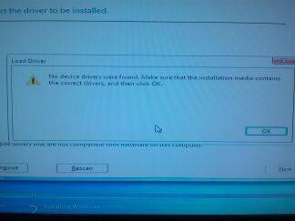

    Its small but thats where i got stuck

    ohhhh, that's for drivers. Skip all that shit for now. Should be an option for no, or do later, or what have you.
    You'll install all your drivers later so you get the most recent versions.

    I just posted one pic of the driver screen i got stuck on with the windows install. I know its small sorry.

    That looks like a bad installer. You may have copied the Windows 7 installation wrong... Either way try to skip it and hit next.

    I am getting no options to skip the driver part... I can't click next or anything. Only browse or rescan, or exit the installer. If I browse I don't know where to look. TurboGT answer your phone man!!!

    Try to plug it in to a USB 2.0 port. A black one not a blue one.

    Well shit I think that worked. Now I'm at a different page. Asking whether I need 64 or 86 bit, I am assuming 64 lol

    This is worth a go. Otherwise, throw your mobo driver CD in the CD drive and select that in the "Browse for Drivers" option.
    Right now it's not trying to find your hard drive, it's trying to install the drivers for the mobo and the other bits.
