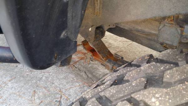

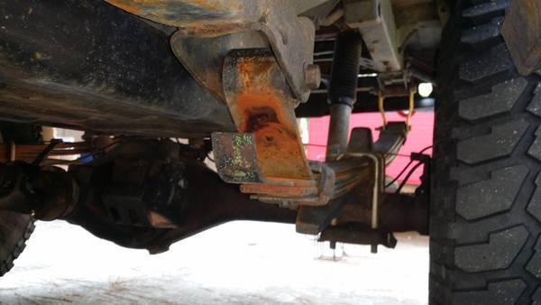

    Not sure how this happened but came out of the gym to find the truck leaning to the right. The driver side is now about 2 inches higher.
    The great thing about broken parts is that I get to buy new ones but I'm stuck between the dakars and deavers. I probably would have gone with Alcan's if I had more time but I'd like get these swapped out soon.
    What do you guys think? Is this safe to drive on for a few days?

    Wow! I'd check for other evidence of it possibly being hit in the parking lot.

    That looks like rust failure to me.

    Just took a closer look and I don't see any signs of a hit. Rust is definitely a possibility, especially since it spent its first 6 years at the Jersey Shore.
    Is it strange that its bent upwards though? With my years and years of experience I would have thought it would have bent the other way....

    X2 I was thinking the same thing... That's really bizarre. Also the fact that it happened while it was just sitting in the parking lot is weird to me. Got any other pics?

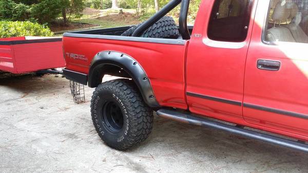

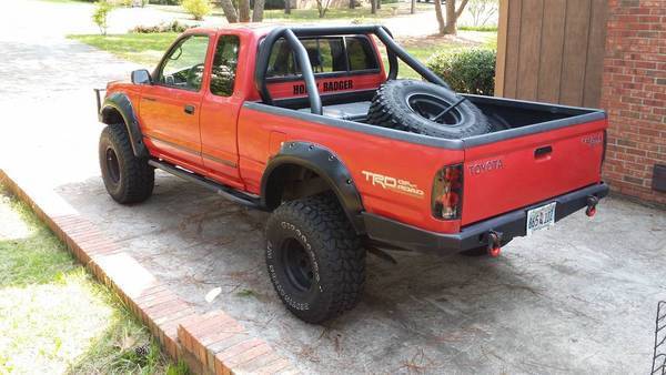

    It probably didn't happen while it was sitting. I was running around town yesterday and coming out of the gym was the first I noticed it.
    Here it was a couple of weeks ago
    Today
    Passenger side
    more pics

    It would not be able to bend the other way as the bottom leaf's would prevent it. Looks like it hit a pothole and when it flexed back, it just failed.

    I would say either rust failure or the axle got pushed forward somehow. Have you backed into something fairly hard lately, maybe a stump or something? Also, your truck is probably crab walking pretty bad because with one leaf being shorter, because it's bent, it will pull that side of the axle forward.

    It definitely looks like the rear driver side wheel took a pretty good hit from behind. Either from backing into something or a car hitting the back of the tire while parking. I suppose a sudden hard launch off the line could cause something like that to happen.

    definitly looks like something pushed forward on the left wheel. looked like my old leaf when someone bumped my rear wheel.

    Wow, ....That leaf is going to break soon...

    Dakars and ubolt flip kit on its way :taco:

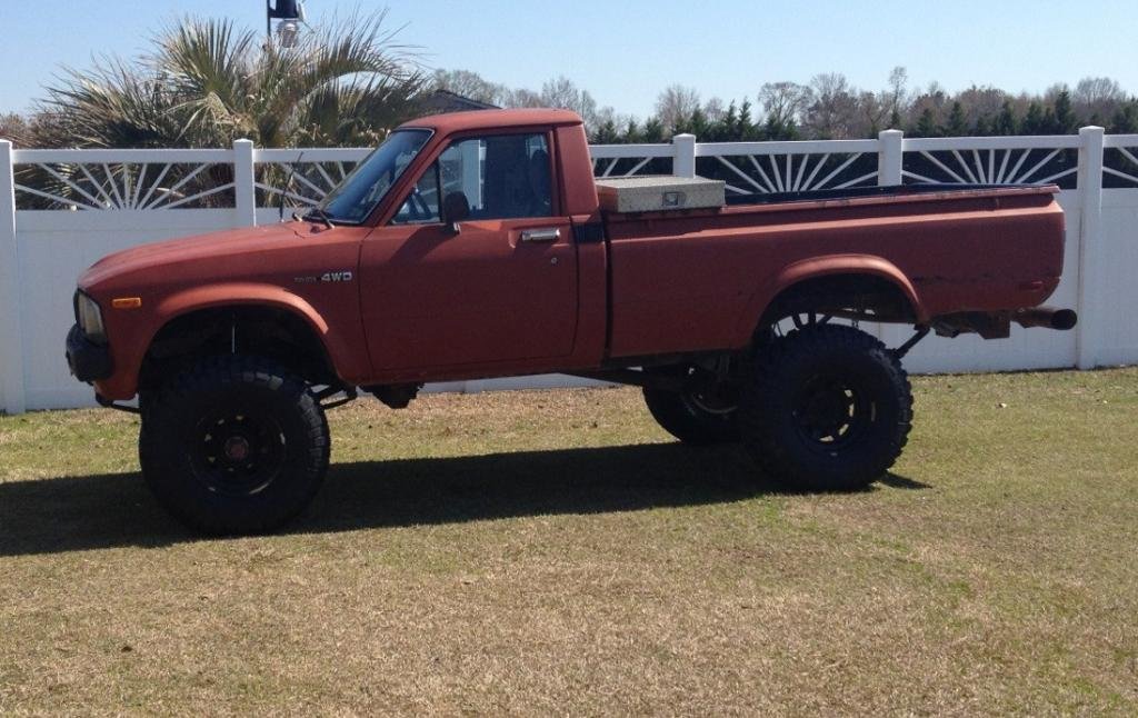

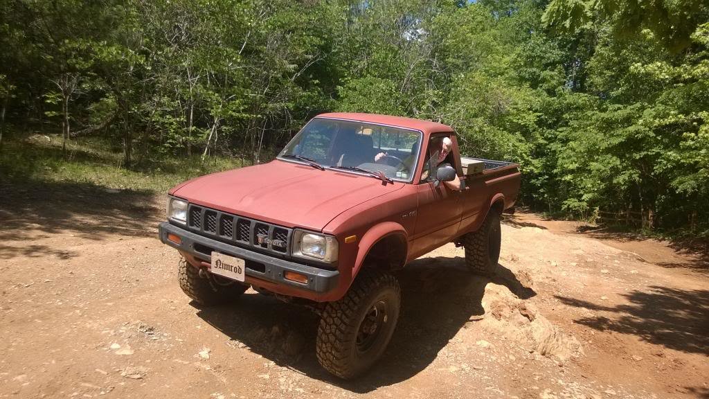

    Chads currently got the 83 broken down to rebuild the front axle, bob the bed, and put on some sliders. You'd like it, it kinda has that same pink-ish color the badger has. Here's some pics of it before the surgery though:

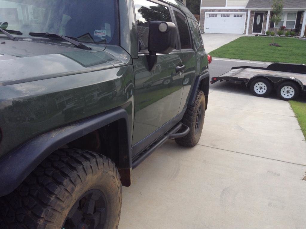

    And here is a pic of the small kickouts Chad welded onto my factory sliders a few weeks ago:

    Both of these trucks give me a throbbing hard-on.

    The faded pink joke aside that truck is awesome! I'll have to swing by and take a closer look.
