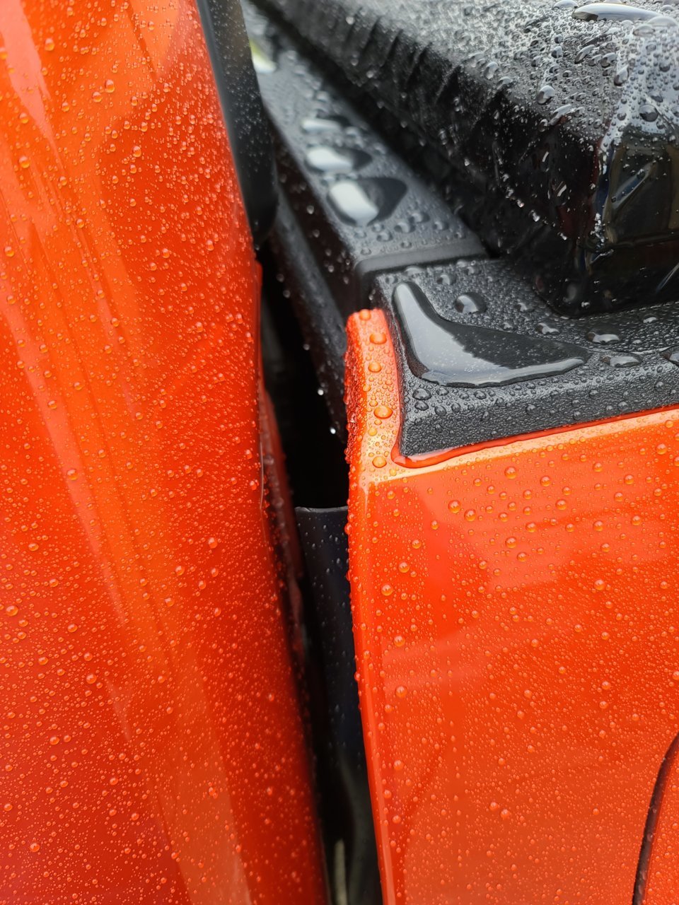

    Anyone have a clue what the measurements are between the bed and cab? Mine is out of whack need to align.

    Its like my passenger front bed side got shoved foward . I can get my hand and wash mitt on driver sied between the cab and bed ,but my passenger side is a different story i can barely fit wash mitt and hand. Never was like that before

    I had a heavy load on my first trip in my truck to montana i noticed after the trip but that was several months later which i thought i was going crazy till i read that other tacomas were experiencing the same issues

    Well thank you guys for your responses ill just have to loosen bed bolts and finesse the bed into appropriate position

    Takes a Torx T55, loosen the bed bolts, jockey the bed (look at the gaps at the cab and rear bumper), then retighten the bolts.

    You are gonna be amazed how easy the bed moves.

    The bed has a locating pin just aft of the forward left hand bed mounting bolt. So it isn't going to move alot.
