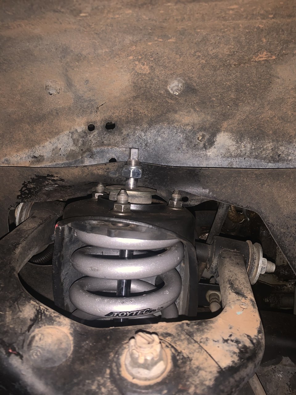

    77DB7F6E-A20D-4026-99DE-B0F0EAA7846F.jpgJust under the locknut, there is a gap between the nut and the washer/bushing, is this ok? Do I need a larger bushing?the coil only has the weight of my truck on it.

    Who assembled that coil and shock. Possibly missing parts below the top hat.... ie, a washer and bushing.

    I assembled it with all the parts that came in for it, it was a full lift kit, bilstein 5100s

    Pretty sure you were suppose to put that washer and bushing under the top hat and reuse your old ones for the top.

    It didn’t come with new ones

    Hence, reuse old ones.

    They say it comes with new ones though, :(.
    I got it figured out, I just had a moment of stupidity. :thumbsup:

    So what, prey tell, was the problem? (There are no moments of stupidity, just temporary lapses in memory)...;)

    The bushings were on my old shocks :anonymous:
