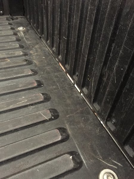

    Hey everyone I just was wondering if you all have a gap towards the center of the tailgate. Not sure if this is by design or not...image.jpg

    Mine does, I tell myself it's for water drainage

    Mine looks the same.

    gap is normal
    but mine is exactly straight across not slightly bowed

    Throw a straight edge across your tailgate when its down to see if its bent. Should be flat. Lots of bent ones out there though

    looks like everyones tailgates are slightly bent...

    Mine isn't like that?? Maybe you guys put a lot of weight constantly in the back?

    My 2013 is straight as an arrow... even gap all the way across.

    Holy shit, there's a gap between the bed and the tailgate! What am I ever gonna do???? Alright, all asshole aside, it appears that you have a slight bend in the tailgate which is creating the gap. My tailgate is bent as well, but it doesn't effect its capabilities for my uses. If you're placing heaving loads or hauling moto's/atv's, I'd probably reinforce it with some steel. Considering new tailgates are anywhere from $500-$1000, I wouldn't purchase a BRAND NEW one.

    Tailgate looks pretty bent.

    The gap on mine is much smaller but I filled the space with some auto/marine seal tape. Keeps dust/water off of my stuff.

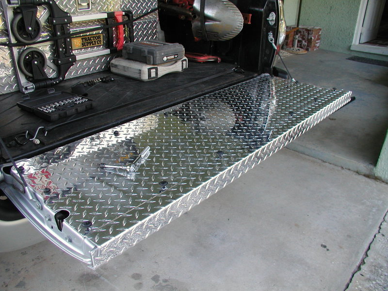

    If you add the Relentless tailgate reinforcement and reinstall the plastic over it, there will be no gap. Plus you have a sturdy tailgate that feels the way a tailgate should weight wise.
    C46E3C56-7C09-4F87-964A-2564C5BB71F2_zps_8726ed2e645ae06d169a523ef034dd01da5b7f96.jpg
