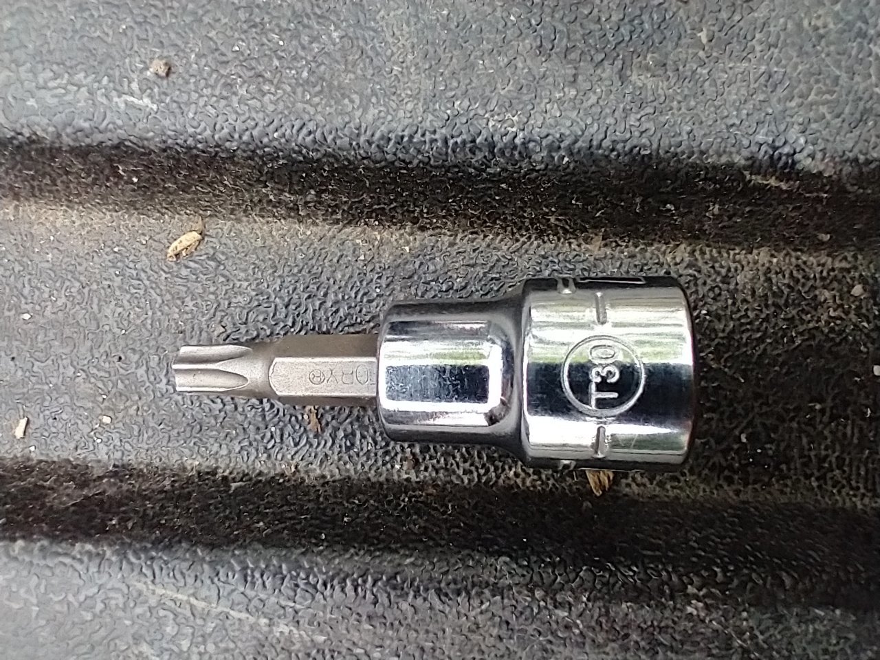

    a crap guide to install:
    Time to install: take you longer to read this post and these images than it'll take to install the panel.
    tools needed: a single T30 Torx bit, make that 2 incase you break one, hopes and dreams, ducktape, idk maybe a few beers to help focus.
    step1: admire Toyota's craft work
    step2: admire this crapsman T30 bit.
    step 3:unbolt everything; torque specifications to untorque screws; non-zero flbs, your kid can unbolt this thing.

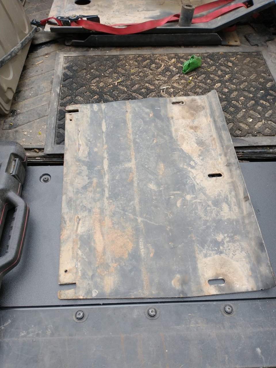

    big screws hold bot the tailgate cap and the existing panel. Small screws everywhere else.
    step 3: slide panel towards the bed and pull up.
    step 3.2: admire that someone from the Texas factory wrote on my panel expecting no one to ever see it.

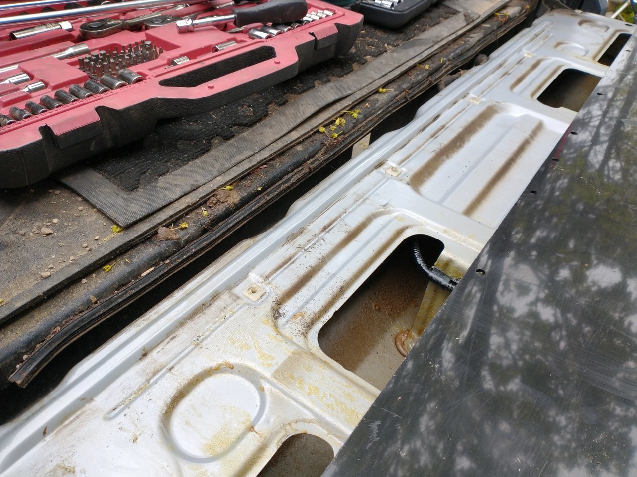

    Step 4 (optional): clean this ridge
    step 4.2 (optional): add ducktape because of my insecurities and felt like adding it

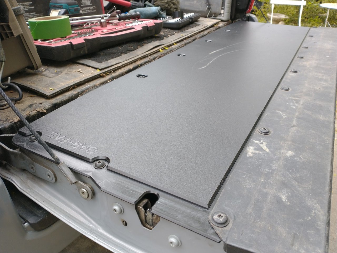

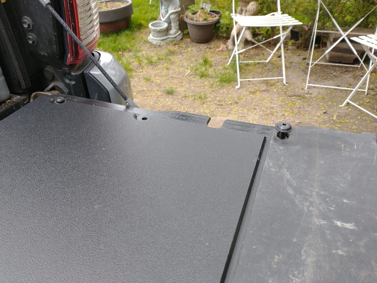

    Step 5: align holes to bolts, make sure orientation is correct and you dont somehow install this updside down inverted. very easy to make this mistake on this step
    step 6: start to thread bolts on the corners to the panels
    step 6.2: close tailgate until latched and tighten the top 2 bolts when desired fitment is achieved.
    Step 7: finger tight every bolt into place and done. Torque specifications - my measuring tool is not fine enough to measure the 1/2lb it took, idk it's a guess - stop screwing it down when the washer stops spinning/ the plate stops going down further.

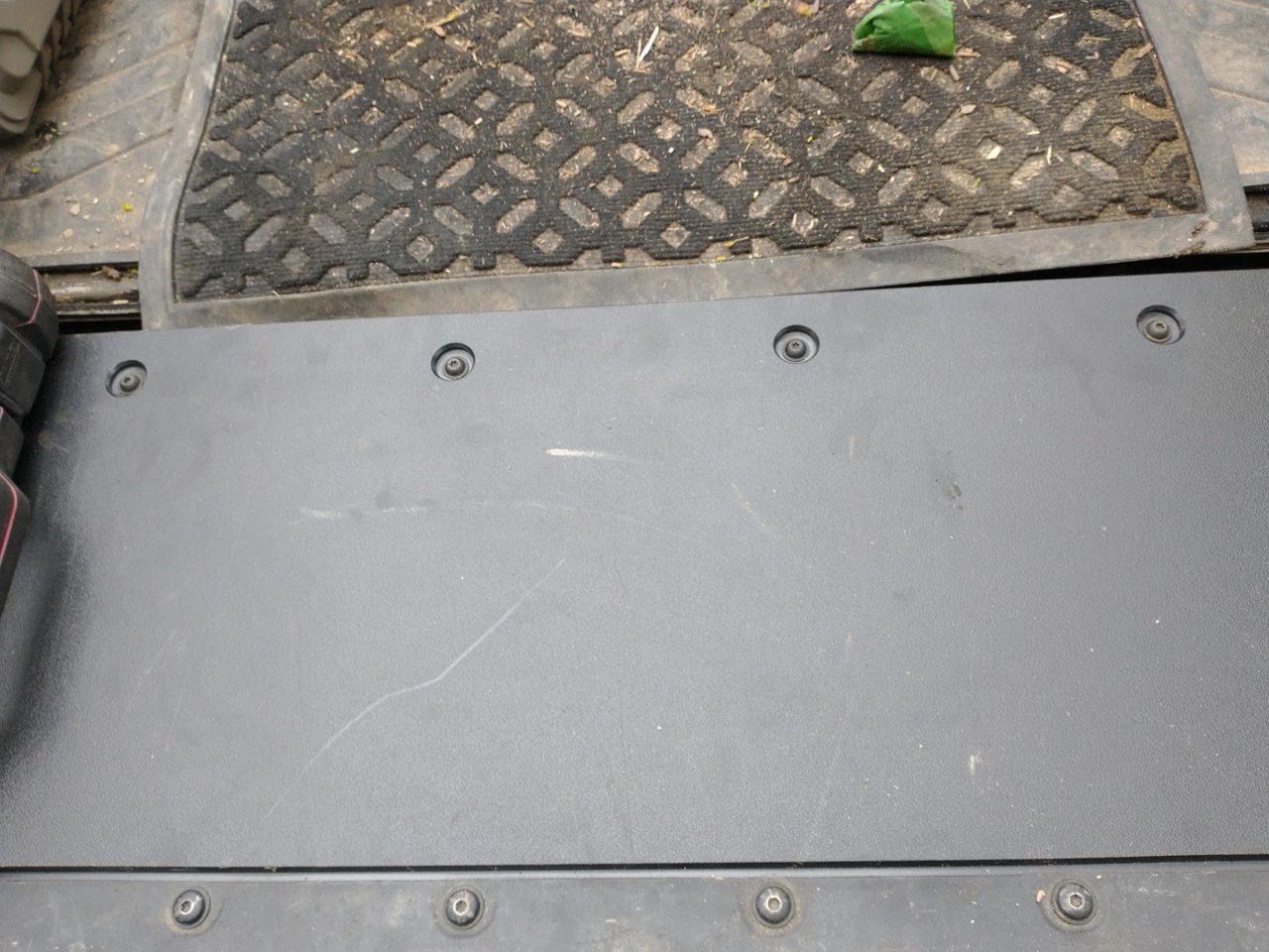

    step 8 (optional): drag 65lb skid plates across the panel to make sure it holds up as well as it's scratched up now so you dont need to worry about the finish looking bad due to damage.
    step 8.2: Admire your handy work of scratching something you just bought
    mmm yessss
    sexy sexy scratches

    Why the duct tape on the bottom of the tailgate?
    Shveet[QUOTED] likes this.
  17. May 9, 2021 at 4:07 PM
    #157
    Shveet
    Shveet joe-shmo
    May 28, 2018
    #254719
    6,415
    Own-tario
    2018 shitbox
    mostly incase IF the panel started to move around over time. that way it wouldn't rub the paint back there.
