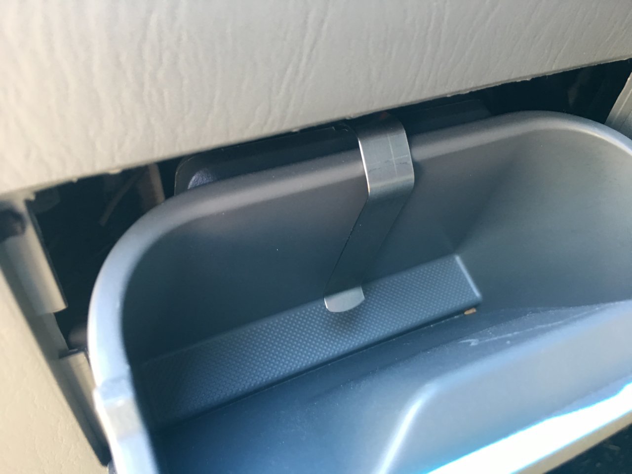

    Mine was pretty simple if you can solder just a little bit. Basically modded the garage door remote switch by adding a wire to each side. The button acts like I am using the remote and it ticks up nicely under the dash.

    That's what I did with my 06, but I put it in the overhead console, wired to a momentary switch, been that way for almost 2 yrs, virtually cost nothing.

    Now this is sweet, I wanna do it! Are you able to do a more detailed write-up? I'm curious how you got the switch installed, like how you popped the panel off and inserted the switch and what you soldered inside the remote.

    Once u open ur remote, there should be 2 spots by each button, find the button that opens and shuts the door, that's the one u solder to, 2 wires and a momentary button and ur done, mounting is up to u, I put mine in the overhead console, if u open up ur controller and send a pic of the circuit board I might be able to point u in the right direction
