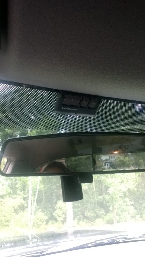

    I did mine the simple way. Remove clip from garage door opener and use 2-sided tape to mount to windshield over rearview mirror.

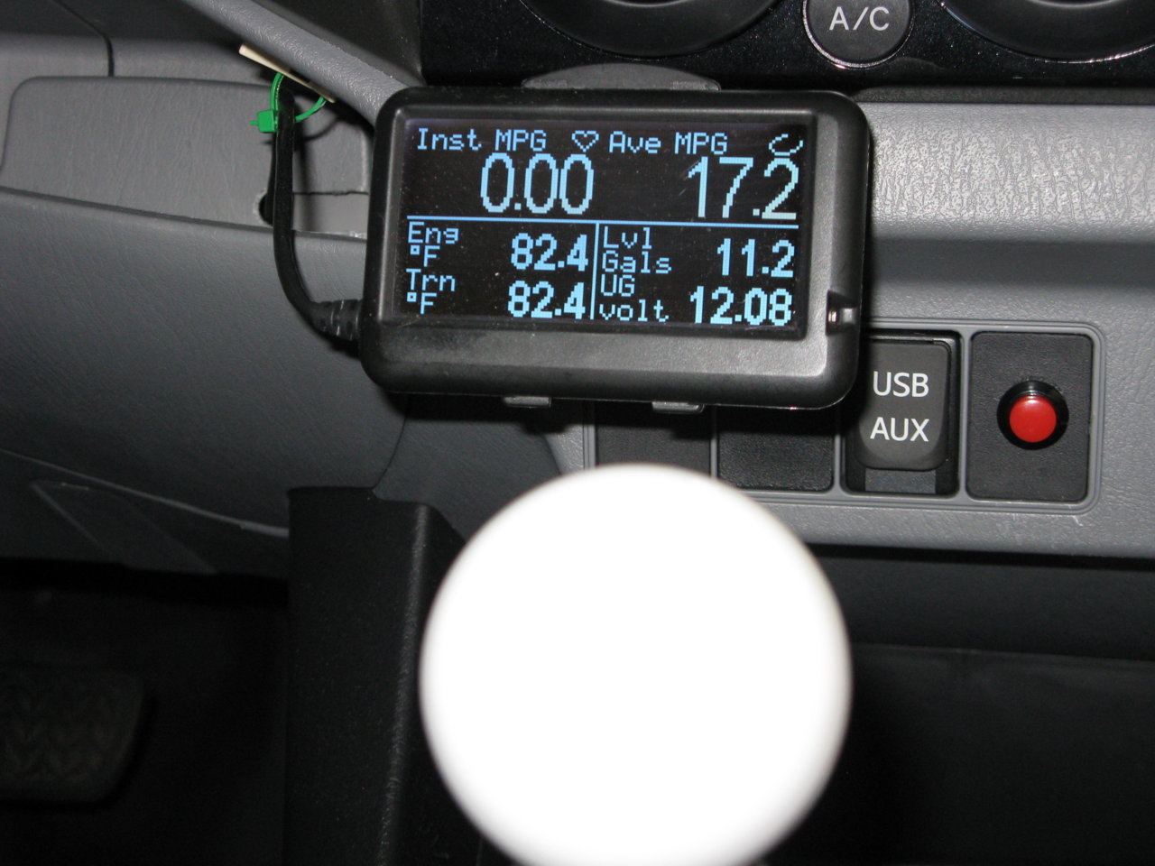

    Small red button to the right of USB / Aux port is hardwired to spare opener, zip tied behind the glove box.

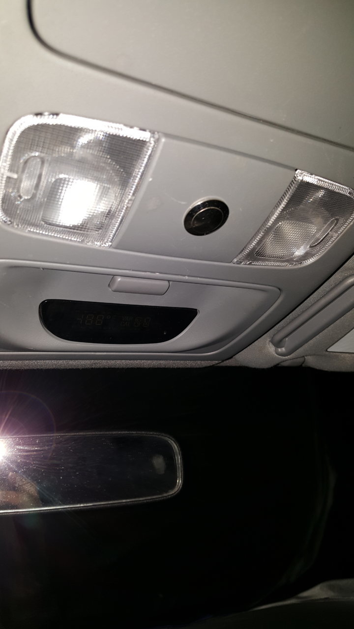

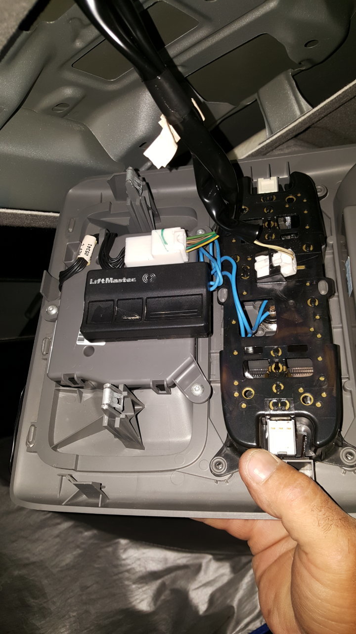

    I took my original clicker apart, soldiered 2 wires from the open/close switch, hot glued the clicker on top of the roof console, ran the wires to a button and drilled a hole and put the button in the roof console between the sunglass holder and the temp/compass, very clean and discreet

    Any pictures of the install?

    Nice! Been trying to figure out the best way to make use of that center piece. I'm going to follow your idea.

    Easy peezy, u could even just put the circuit board up there if room is tight, I had plenty of room, 06 DCSB
