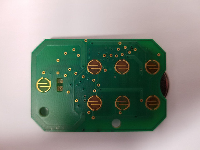

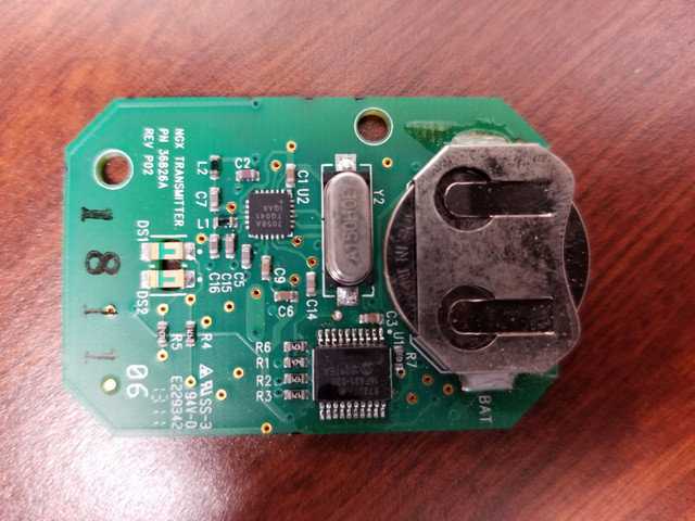

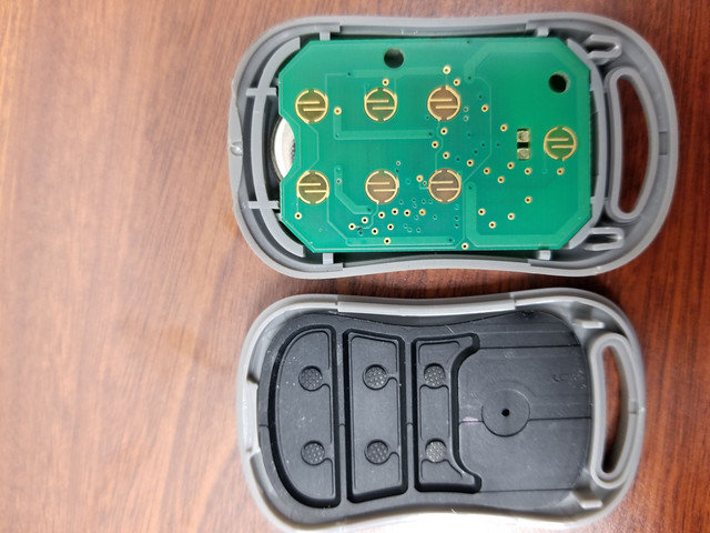

    Has anybody done the pushbutton mod with a Genie 3 button remote? Took mine apart and can't figure out where to solder the wires.

    Take a good pic of both sides of the board, maybe I can pin point it for u

    Thanks for looking Christian
    Pics of my opener

    See those round dots on the back side of the rubber buttons? Those have carbon on them. When you push the button, the carbon connects each side of the circle on the PCB together. So, you just need to decide which 1 of the 7 buttons you want to hardwire, solder wires on to each side of the circle for that button, and connect the wires to a push button momentary contact switch.
    Be careful that you don't let solder flow over onto an adjacent trace. Inspect your work with a magnifying glass.

    Thanks for the info. They are small and that is going to be tough. I have already messed up 2 of the buttons so will try on another one.

    I'm guessing that you're getting it too hot and lifting the traces. Either buy a better soldering iron or take it to a TV repairman.

    I messed up the 2 that are closest to the battery. I tried soldering a wire to each of them. This is another opener that I have. Going to program the other 2 buttons for my garage and try what muddinfun said. After looking closer I see what he means.
