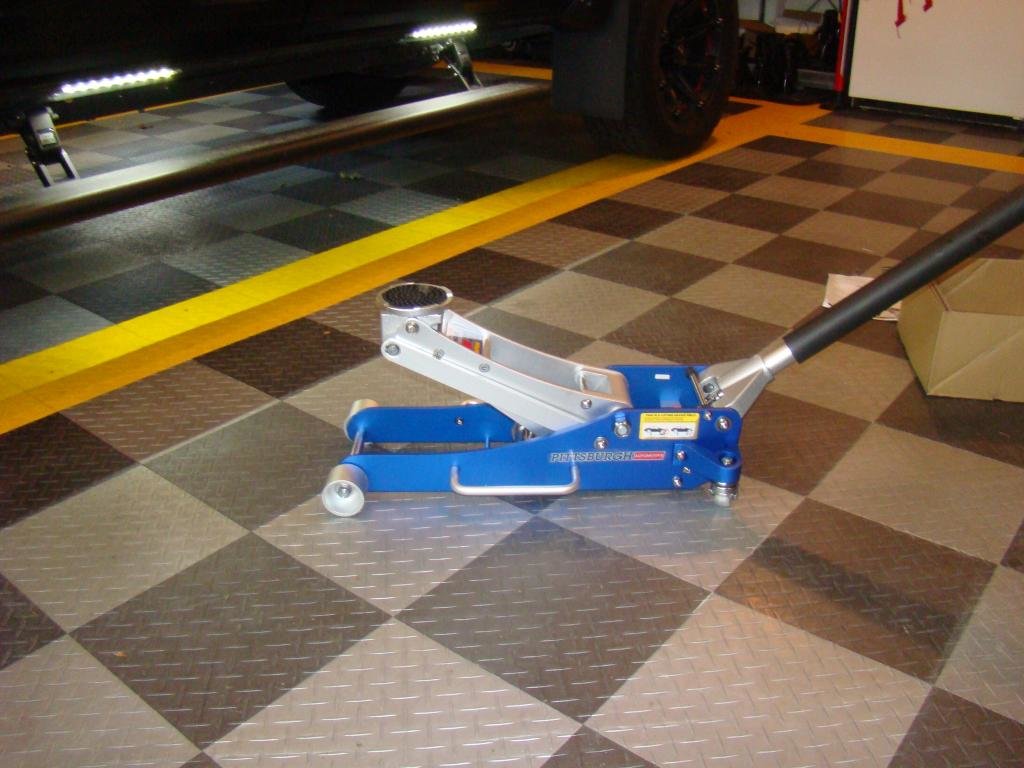

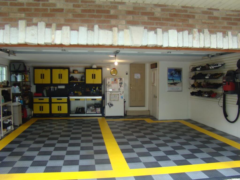

    As KB stated, hot tire pick-up is when a painted/stained/epoxied coating is peeled off of the floor after the vehicle has been parked on it for awhile, particularly if the vehicle had been driven for a time prior to parking it, meaning the tires were hot when parked.
    Pulling out then often can lead to this, which no coating manufacturer can guarantee against.
    i even asked a rep at a home show about this, and he stated they generally tell people to put mats down where the tires will be :facepalm:
    This is racedeck flooring i installed....................http://racedeck.com/

    I really like the look and ease of installation of RaceDeck and the Costco version (motofloor?).
    What I don't like is how liquids will work underneath them when spills occur, how jackstands and other heavy items can damage the tile, etc. It seems like it's ok for a park and wax event, but not for hefty work.
    It's why I spec'd a polished and sealed floor in my post above. 'Cause I want one I can work on.

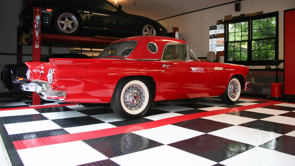

    i paid 2.99 s.f. installation is a breeze.
    racedeck isn't just for looks, and can be worked on. guys even place 4-post lifts above them.
    if placing jackstands on them, i will use a simple piece of plywood to be safe, but i've lifted the truck many times using the jack directly on the floor.
