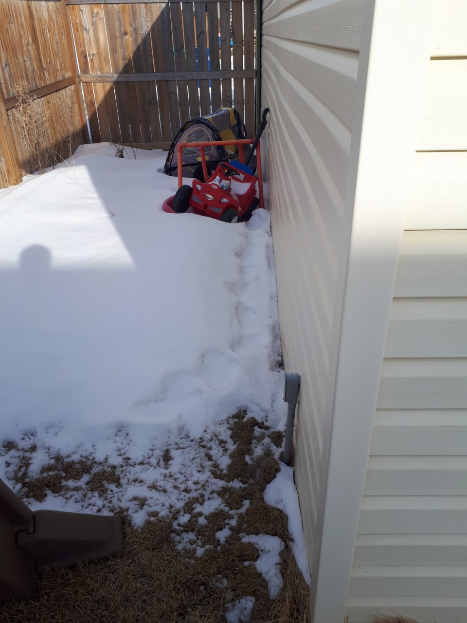

    Got a pic of what you're dealing with?

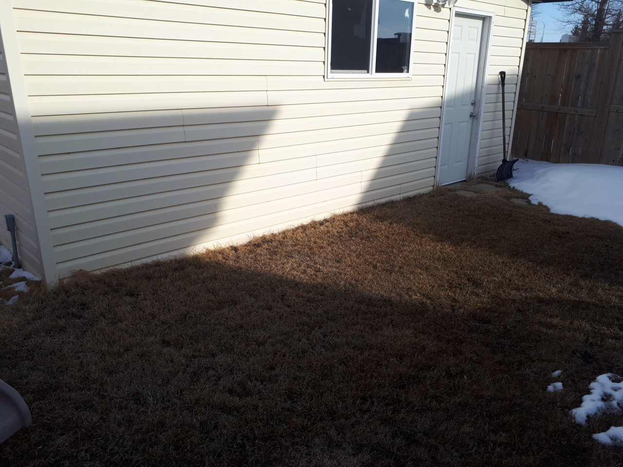

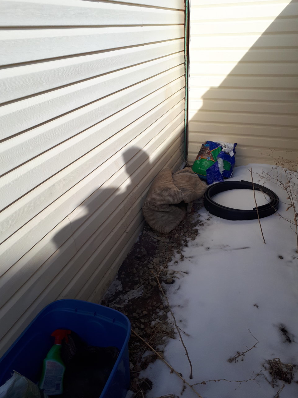

    Heres a few of the 3 sides where its seeping from for reference.

    Is that vinyl siding ?

    Yup

    Yep, you have at best neutral grading. When the ground thaws I'd be moving some dirt. You can do a lot with a rototiller and a rake ut a rented bobcat would be easier. You want your ground level lower than your slab and sloping away from the building.
    Youre also missing some trim in the inside corner pic. You have a leaky envelope as it sits.

    10-4. Including below comment Im going to go through the envelope and patch up as neccessary.
    Ive only lived here a year. But this spring the shop is getting set up.
    Thx for this. I overlooked it.
