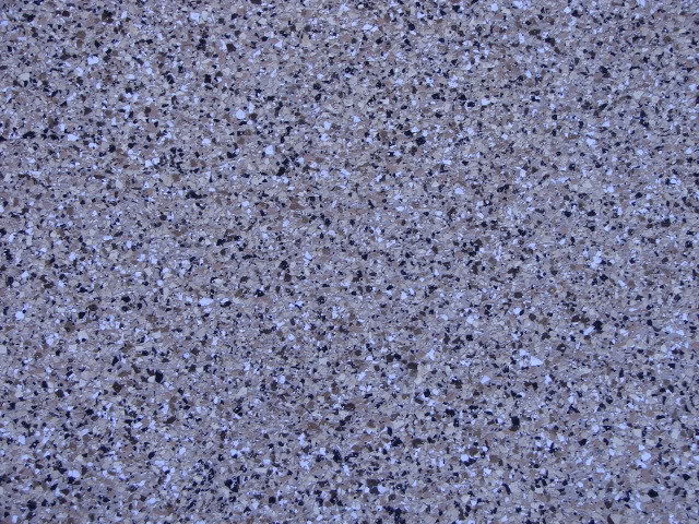

    So some of you guy may know that I do coatings on the side for people. I am actually coating my floor this week. The Company Name is Hungry Students Coatings. Anyways we do epoxy and acid staining for people. We are small. Made up of me and either me younger brother or My young cousin and my dad helps sometimes (He’s trying to teach my brother and cousin how be hard workers and how to do things the right way the first time “Life Lessons”) We do not advertise at all and only work from word or mouth and referrals. We have 7 Garages and one 5,500 sqft shop under our belts for epoxy and then for acid staining we did the columns on a $1.3 million house that a Cardinals Player now lives in. The product that we use is made for industrial applications and would normally used for Shops and aircraft hangers. This is not the home depot stuff. That is more or less almost house paint mix with some epoxy. The main problem with those kits are that most people do not properly clean the garage (Because it doesn’t say how to) and then it peels after a while. If you prep the floor right then it may last a little longer. That cleaning junk it gives you is just TSP, and its not strong enough to clean it well.
    Our Process:
    If any grease spots the day before we will mix a paste from TSP and Xylene and place on spots
    Next we come pressure wash the floor and then scrub it with water and TSP.
    Then we rise again. Then we start to acid-etch the Concrete with Pool acid and water. We scrub again to make sure its etching the Concrete.
    Next we neutralize the acid with a mix of ammonia and water. Once done then we rise again.
    After we rise we squeegee the water out for the most part and then primer the floor with a water based epoxy primer. This will need to dry overnight.
    Next Day we come back and lay down the top coat epoxy (Solvent-based) and add the flake if required. This will dry overnight also. If no flake this would be the last day. Epoxy would be a nice Glossy finish.
    The next day we come back and scrap the floor to make sure that all of the flakes are flat and smooth. Once scraped we sweep up the floor to get extras off and then add a coat of solvent-based polyurethane to protect the flake and give it a nice glossy finish. Then we are done
    Normally it takes 7 days before I tell people to drive on it. and 2 days before you should walk on it with shoes.
    This is our pricing (Epoxy Coatings):
    Solid Color– $1.50 per Square Foot
    Granite- $2.75 per Square Foot
    * All Garages will be a minimum of 400 sqft when giving quotes Due to how product is purchased
    PM me if you have any questions or interests. Also If you are going to use Home depot / Lowes stuff and want some tips feel free to ask :)

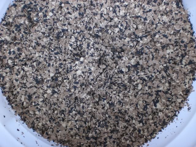

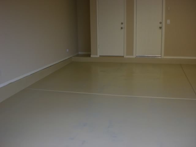

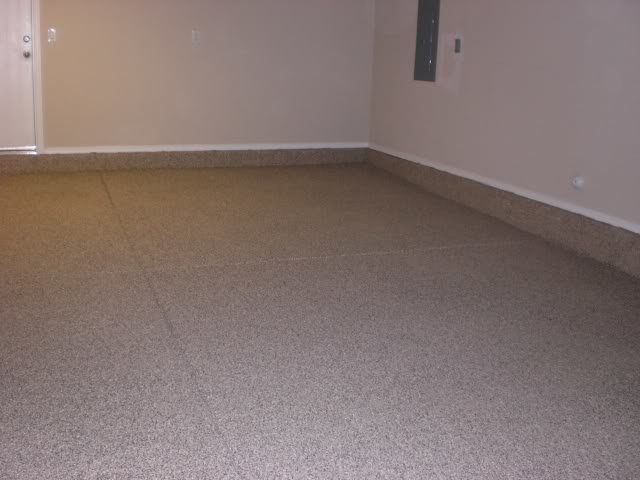

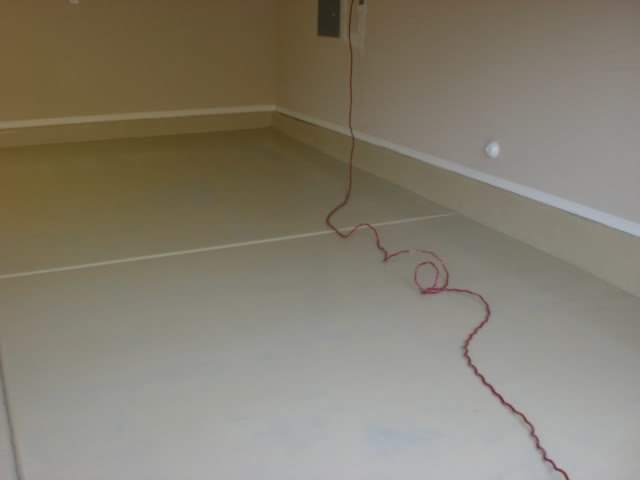

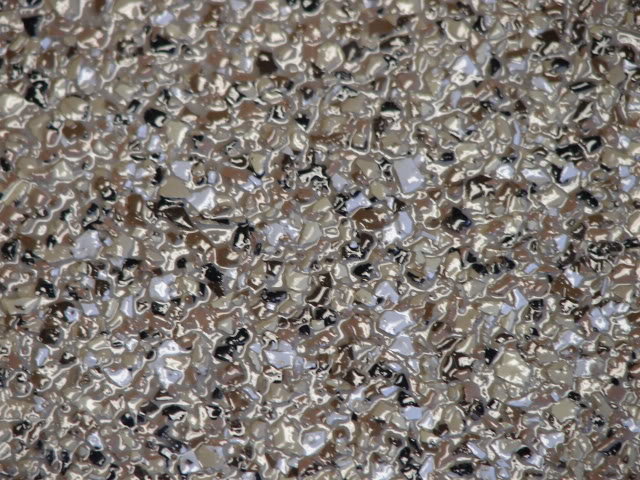

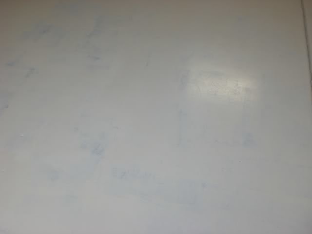

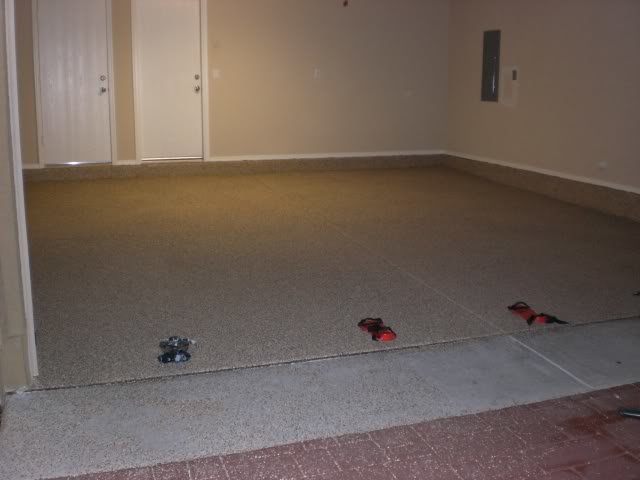

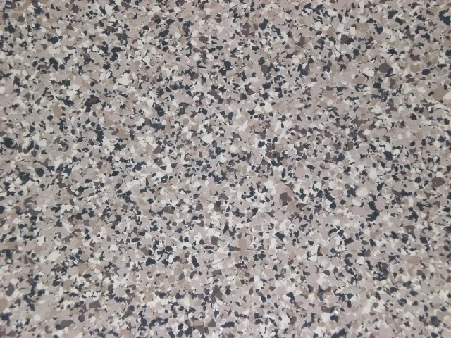

    Primer Stage of my garage:
    Top Epoxy and Flake Stage:
    Bucket of Flake. I'm doing dark brown.
    With Flake on the floor
    Close up of flake on the floor
    Tomorrow is Scraping stage and then Very high chemical resistant Polyurethane
