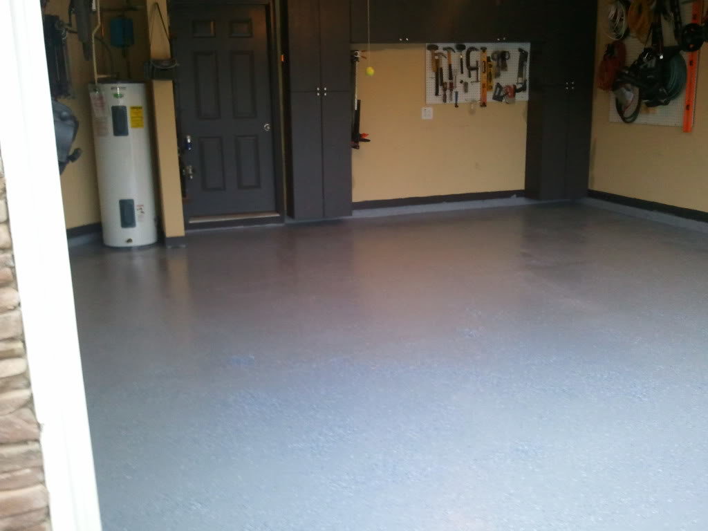

    I did the rustoleum 2-part solvent based kit about a year ago. I haven't had any hot tire lifting. The only failure I have had is when I accidentally dripped some wood glue on the floor and let it dry, when I chipped the glue off, it took a spot of paint with it (maybe the size of a dime).
    From past experience, solvent based is the way to go. The water based stuff won't hold up.
    PREP PREP PREP! Go above and beyond their directions.
    Here are the steps I took:
    1. Blew out all the dust
    2. Pressure washed with an 1800 psi electric PW, then scraped up any glue, tape, paint etc with a putty knife.
    3. Scrubbed the floor with purple power degreaser, rinse thoroughly with the PW
    4. Etched the floor with muriatic acid then nuetralized with baking soda then rinsed thoroughly with the PW.
    4. Scrubbed with purple power again and rinsed thoroughly again
    5. Cleaned it using the cleaner/etcher that came with the kit.
    6. Rinse thoroughly with the PW a few times.
    7. Squeegeed all the water out.
    8. Setup 4 box fans in the garage blowing the air in a vortex then Let it dry for 24 hours.
    9. Follow directions and mix the paint, do your edges & sides first with a paintbrush, then roll the middle.
    Here's a pic right after I finished.
    I clean it every 3-4 months with some dawn dish soap and water using a deck brush then squeegee dry and it looks brand new. I think I may do the acrylic clear coat this spring on it just for added protection.
