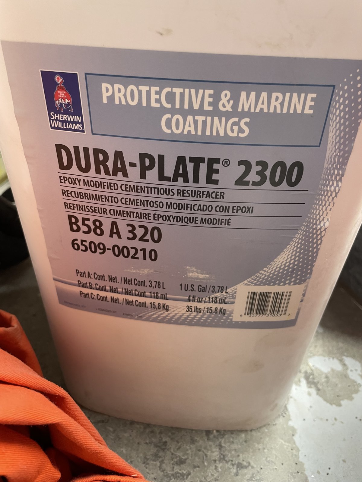

    Saw quite a few parking garage floors being done. Always best to get new concrete done after it cures. Existing stuff should be cleaned best you can. I used concrete etch & a commercial floor machine I “borrowed” for the weekend. Lotsa good products out there too.

    This^^^is the stuff used on the last job. Turned out real nice & stood up to the salt very well. :)
