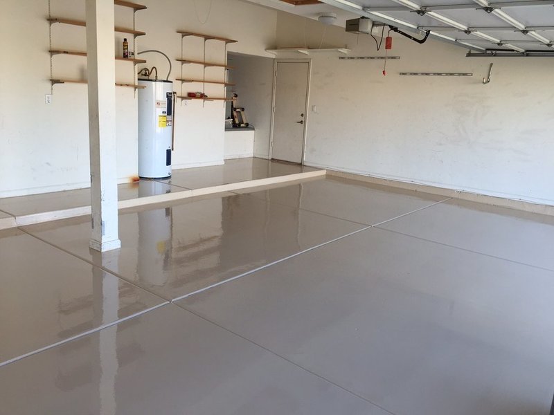

    *Update Garage Floor Completed!
    Sorry for the delay all, it's been a week since the garage floor was completed and it's been busy with electricians and plumbers coming through here . We got moved in and now the unpacking has started. Below are some pics of the garage floor before and after.

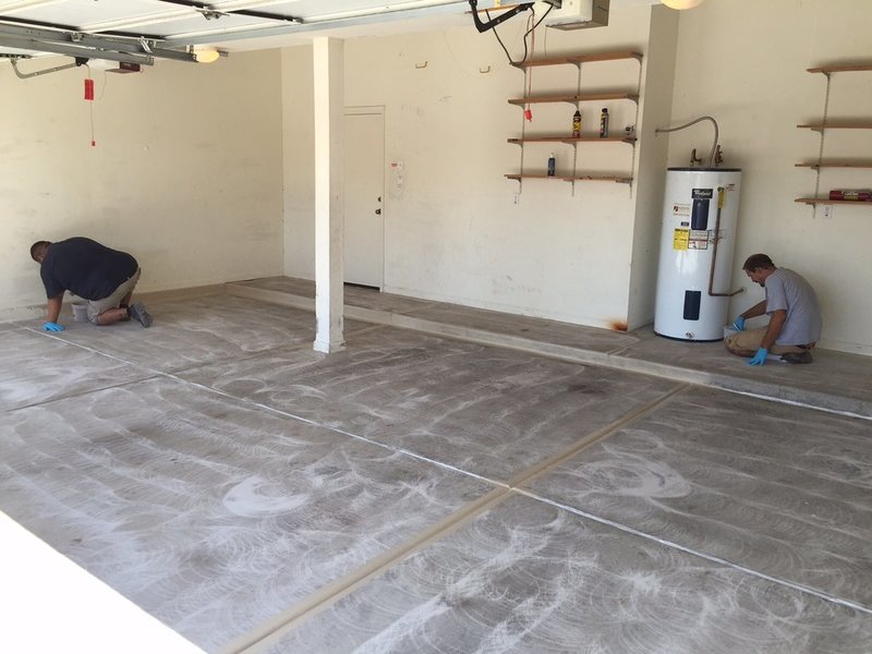

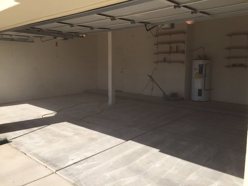

    They started with diamond grinding the floor to open the concrete up and to remove any stains. Afterwards they flushed it with water and used a yard blower to dry it off.
    Here they are laying down the 1st coat, the primer.

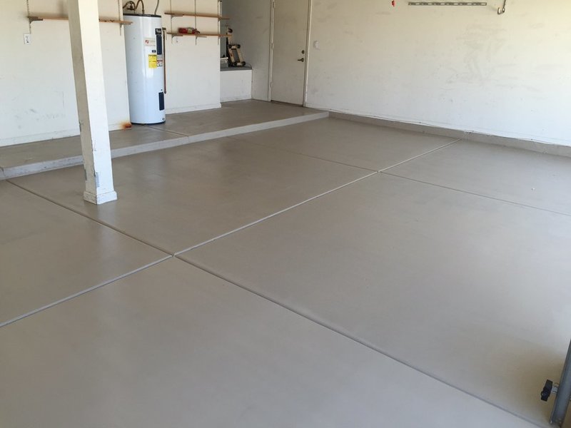

    About 3-4 hours later they came back and laid down the last coat, 24 hours later we have a shiny floor!
    As a side note, when Rick was prepping the floor he did notice that part of my garage floor seemed a but rougher than the rest, like something had eatten away at it in the past or maybe didn't cure properly, so in those areas the epoxy took with no problem but was a little "Wavy" where it was rough. Additionally, once the floor completely dried and I did an inspection, I noticed a few "pock" marks, looks like the concrete farted and caused an air bubble.
    I called Rick that afternoon and the next morning he was over at the house to check it out. Without hesitation he got right down to fixing the marks, he basically sanded it flush and patched the spot with epoxy. I checked the spots in my garage 24 hours later and I can't even find them anymore.
    All in all, this turned out pretty damn good. For $780 bucks and finding Rick off CL, I think things went really well and he seems like a good dude.. Rick does this on the side but he's got the training from AZ Polymers as well as access to their products. When I am ready to do my sidewalks and rear patio, I'll have no problems using Rick again.
