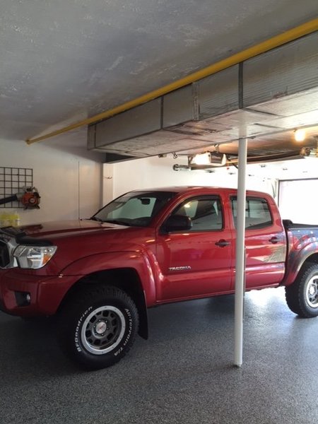

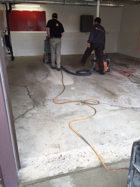

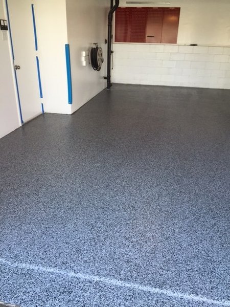

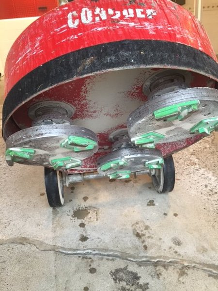

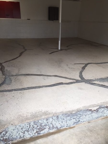

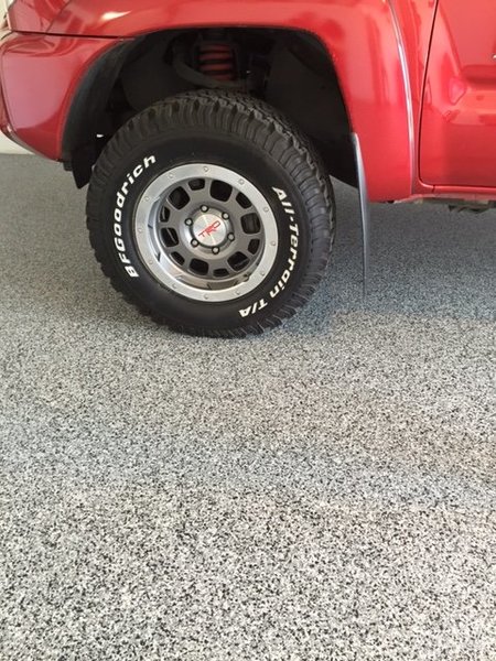

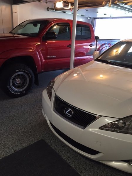

    Also wanted to post some pics of my garage floor that I had done earlier this year. Best thing I have done to my house, let me know if any questions...

    I fuckin love epoxy garage floors. :headbang:
    I did my own and it turned out pretty good. I abused the hell out of it and it always cleaned up nice. If you do the flake you have to do a clear over it or those flakes will be constantly coming up. The pro's might not have that problem though. Looks awesome. :thumbsup:
    Dig the GS(or IS?), too. Looks very similar to my garage at one time.

    looks good n looks expensive

    You're exactly right, clear coat with an abrasive in it (like clear sand) so it's not slippery when wet. Thanks!
    IS250 my wife's car.

    $3,700

    It also took 4 days of labor and a week of not parking on it (not to mention I took every single thing out of my garage, and painted it over the winter)...with grinding, 150, epoxy, flake, drying time, rain, wind. It was a cluster.

    Absolutely. Lots of prep, lots of labor but definitely worth it. Makes my vehicles look like they are in a showroom and turned out to be one of the nicest floors of my house..

    Exactly. I can walk on the garage floor with bare feet and it's as clean as my kitchen floor (I know winter is coming though). But no more garage cement dust, dirt, crap, etc...
