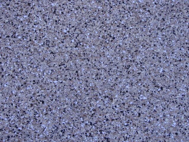

    It depends on the budget really. A lot of people like this "Granite" look which is where you throw a ton of flake down and then it has a granite look to it. and then some people like a plain solid color epoxy with a high gloss shine. And then some really like acid staining the concrete. It gives it a leathery look and I personally really like it. I was going to acid stain my garage floor but I did the granite look epoxy instead.
    EDIT: Here is a pic of a granite look. This is a light tan look.

    is that smooth or rough finish...looks great.. i reall ylike it
    whats that cost for average 2 car garage

    It is not smooth as glass but it still is smooth because it has Polyurethane over the top to protect the flake from coming off. Price just all depends on companies. since I do it as a side job and there is only two of us I can charge a lot less because I don't have the overhead. I charge $2.75 - $3.00 a square foot for that because it is a lot more work and a lot more materials. Like for my garage (a lil over 450 sqft) I had to get 55 lbs of flake to cover it.
    But average from what I've seen around here is from $3.50 - $5.00 a sqft for that look. sometimes for might get a deal but it just depends.

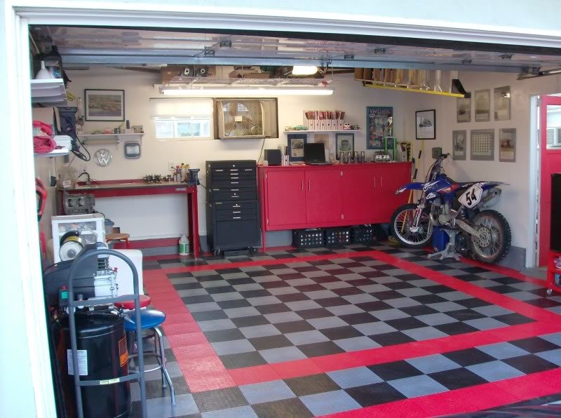

    I used Garage Deck in mine, $2/ sq ft...

    Nice bike:cool:
