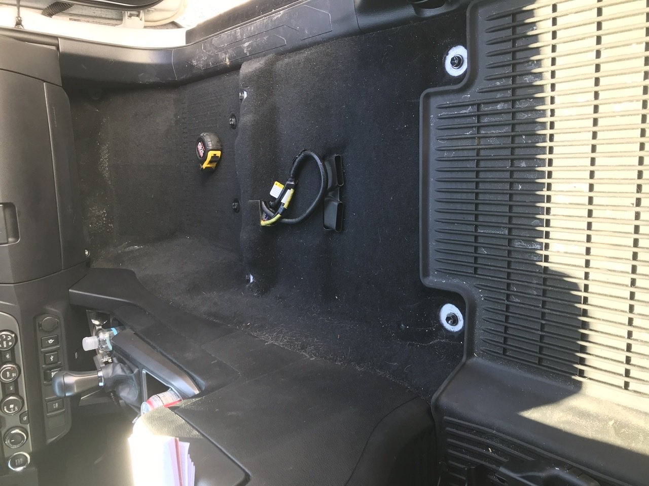

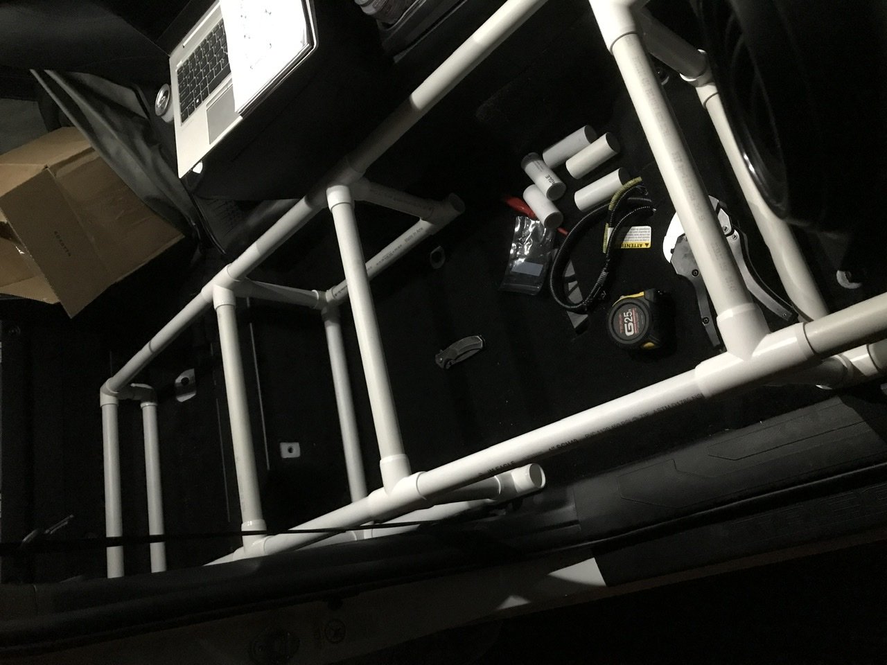

    I ripped out the passenger seat and passenger side rear seat.
    built a frame out of 1 inch pvc, using standard fittings and a ratcheting pvc cutter.
    used plywood on top with an indoor/outdoor carpet from hone cheapo and stapled to plywood.
    use couch cushions as the cushioning.
    Pictures below. When I have time and technology I’ll get this written up way better and with way better pictures the right way up.

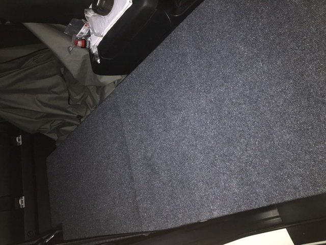

    Couch cushions stolen and twin bed sheet used to wrap it all up. Setting off for LA tomorrow.
    I will say - these cushions are 24 inches wide. I’ll be looking for some 22 inch wide ones depending how this goes. Glad I have these today but these sort of encroach the center stack and console. And the glove box is only infrequently used items now, had to rearrange a bit once I knew where these would end up.
    but I’ll be sleeping comfortably in the cab which will be new since last time I was curled up like a fresh cooked lobster.

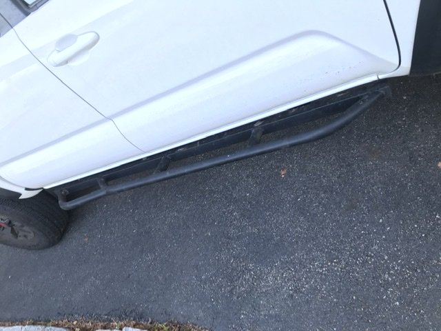

    Sliders back on. Didn’t paint them. They’ve been off for like 6 months and I put it off/blamed the weather long enough that - I’m going out this weekend and don’t have the chance to paint them while they’re off this time.
    either will mask off the truck and paint them on there, do a roll on, or take them off again.
    now that I have been under there and done the instal before, this time it took me 90 minutes soup to nuts. Didn’t even have the tools prepped or anything so that’s not bad if I need to take them down to paint them sometime. Happy to have them back on for protection, steps, and to have a giant piece of floor space back in my shed.

    I'd vote to take them off again. That's one thing I hate about having welded on sliders. I'm gonna have to wrap the body of the truck in plastic to keep from getting overspray on it.

    yeah - the first time putting them on was a total mess. But now I know how to take them on and off they come off in an hour and back on in 90 minutes. That’s not too bad. But I also beat them pretty bad so might just do a roll on and call it good enough. The first coat was pretty bad to begin with (all me not the vendor).
